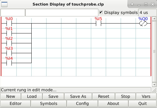

Hello,
i want to try to make a classicladder program that stops motion when i manually jog the machine and "crash" the touchprobe (so it wont destroy the tip or worse the whole probe).
does someone know which pin (if there even is a pin for that) i could use for this purpose?

i have found this: axis.N.kb-jog-active it does work but only with one axis. I could net them to classicladder NO inputs then net them together following another NO input (touchprobe) and then going out to estop (preferrably just motion stop so i dont have to reset the machine every time). I will post the files when i have it working if someone wants to do the same

looks like Linuxcnc is already doing the desired reaction => just stopping motion, tell "probe tripped during a jog" and dont go into Estop. Thats what i did:
in postgui.hal:
you need to make sure that the probe signal names match
and in classicladder have a look at the screenshot
in postgui.hal:
net jog-x axis.0.kb-jog-active => classicladder.0.in-00
net jog-y axis.1.kb-jog-active => classicladder.0.in-01
net jog-z axis.2.kb-jog-active => classicladder.0.in-02
net jog-b axis.4.kb-jog-active => classicladder.0.in-03
net jog-c axis.5.kb-jog-active => classicladder.0.in-04
net probe motion.probe-input => classicladder.0.in-05you need to make sure that the probe signal names match

Note: You need to make sure to jog in the OPPOSITE direction, if you ever trip the probe while jogging, or it WILL break something!
