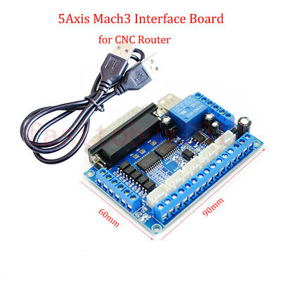

When I got back from an out-of-town trip, I fired up my CNC and set about homing it for a new project. It promptly jammed the Z-axis into the roof of travel... I removed the spindle, wrenched the axis free, using a Vise-Grip on the precision-ground ballscrew threads, figuring I had left it too high, ran it down a couple of inches below the home switch--and did it again... As Bugs Bunny used to say, "What a maroon!"
After that I decided to check the X and Y homing and found that they, too, do not function.
They worked fine when I ran a model just before leaving town.
The switches are the proximity (magnetic?) type and wired as independent inputs to a "Mach-3-style interface board" connecting pins 12, 13, and 15 of the parallel port to the home switches X, Y, and Z respectively. Wiring to the board looks fine and DB25 connectors are tight on both ends. I have restarted LinuxCNC, v2.7.14-112.
A couple of times when machine behavior was Very Strange Indeed in the past, I discovered that I had stepped on the too-short USB power cable providing 5V to the interface board, unplugging it--not good. This time I verified that it is connected. The wires running from the switches are protected by those self-rolling-up cable-management systems (or have been--I will have to crawl under the machine to verify there has been no damage--not an easy feat in my cramped quarters). However, there has been no indication of "trauma" or "violence": it worked before, I turned it off for a few days and now it doesn't work.
It's worth noting that the Linux machine, v12.04LTS, was left on all that time, as was LinuxCNC.
It's as if a setting somewhere "disable home switches" has been set.
If anyone has thoughts about what might explain this, I could use and would appreciate the help. (I'm bound for the underside of the machine: 6'1" in <4x4x3...)

When the X-axis carriage is in the "home" position, these variables have these values:
axis.0.home-state 0
axis.0.home-sw-in FALSE
axis.0.homed FALSE
axis.0.homing FALSE
None of them changes state when passing through home.

Open Linuxcnc, in the "machine" menu there is "show hal configuration", on the left side navigate to "parallel port.0.pin10 and 11 and 12 and 13 and 15" those are the inputs, now on the right top side click on show, then on the left side click on each of the above mentioned pins, now you have on the right side LED's showing the state of the inputs, press on each of them and check if the led changes color.

Its not something that lets you change something but shows you whats going on. So if you now activate a home switch or whatever that pin is connected to, can you see the state change?

Ah. Press/activate the home switch itself.
Although I didn't move it, I had the X-axis actually parked in front of its proximity switch, triggering the switch's LED, but the pins parport.0.pin-10-in[-not] didn't look any different than the others (that is, they showed yellow and dark red).
Before your reply, I was preparing a couple of screenshots to clarify when my mouse froze, which appears to be a recurring symptom now.
I did crawl under the machine and checked the wiring along its length and found no damage to any cabling and that it's all still safely tied away from obstacles.
I think the explanation is that my machine has gone crazy. Supporting this theory is the fact that a fileserver on my network now won't boot.

It might be worth putting a multimeter on your proximity sensor output. I had one fail on a home switch the other day and on a 24V system, I was getting 12 volt and 3 volt for on and off. The LED would come on when triggered but glowed dimmer than normal. In this case, replacing the sensor fixed the problem.
The -not pins are there simply as a convenience as they are the inverse of the normal input pin so it will always be the opposite of the pin. (The colours represent on and off)

I forgot how they get power, but since none work, it's possible they source from a single source which has failed. I actually do have a spare "Mach3 board"--back from when I mistakenly thought it had failed when I had only inadvertently unplugged its 5V USB supply.
