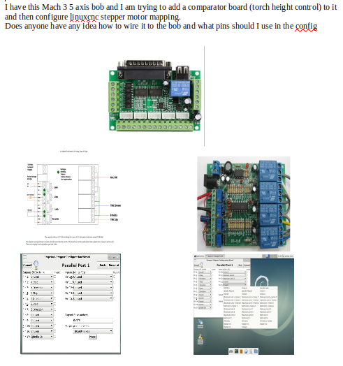

plasma stepper config

Hi
the THC you nee to do it by hand
i add a config as i do use this also
this are the lines responsable
loadrt thcud
addf thcud servo-thread
net spindle-cmd <= motion.spindle-speed-out
net spindle-on <= motion.spindle-on => thcud.arc-ok thcud.torch-on
net TorchUp thcud.torch-up <= parport.0.pin-15-in-not
net TorchDown thcud.torch-down <= parport.0.pin-10-in-not
net CurVel thcud.current-vel <= motion.current-vel
setp thcud.requested-vel 15.0
setp thcud.vel-tol 8.0
setp thcud.correction-vel 0.001

Yup, same user.
There are already some replies to the original thread, but it was never answered by the original poster.
Is there a users manual for the board you are trying to wire ? That picture is not helpful.
Replied by tommylight on topic plasma stepper config
This is a double post ! It looks like the same user but did not check.
Yup, same user.

08 Aug 2019 15:23 #141687
Torch up - goes to input on BOB ( usually 12 )
Torch down - goes to input on BOB ( usually 10 )
ArcOK - goes to input on BOB (usually 11 )
If your plasma does not have the connector for torch on and a voltage divider, please ask someone else who is qualified to wire that.
That is very dangerous !!!
