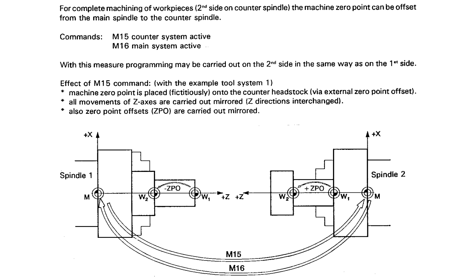

28 Sep 2020 06:54 #184116 by rexo
Hello guys,
i am working on retrofit emco cnc lathe emcoturn 425
it's lathe with two main spindles, two turrets and two subspindles
old controller is sinumerik, which have function axis doubling - machine cutting two identical parts with single code
I am looking for solution where i have XZ UW axis in linuxcnc and program is only XZ
Is possible to join X axis with U and Z axis with W?
My intention is if i program X100, then X got to 100 and U go also to 100 but with different tool correction
Another problem is with subspindle, i like switch machine to subspindle by user M command, then programming
other side of workpiece, but i need reverse Z axis as is in sinumerik controller

28 Sep 2020 12:19 #184154 by andypugh
Replied by andypugh on topic Twin Spindle / Twin Turret turning center
I think that axis mirroring with cutter comp would be difficult (by which I mean that it won't work within the current LinuxCNC architecture)
The XZUW positions are determined by the G-code, then the offsets are applied, and then it goes to the kinematics module.
So whilst there are many ways to combine joints inside the kinematics (as is done for gantries) there isn't a way to have the axis offsets apply (also as these are _axis_ offsets not joint offsets)
There is also no way to program an XY arc and a UW arc to occur simultaneously. (This is a G-code limitation)
So, it is easy to make the UW axes move in a exact mirror of the XZ axes (whether by using HAL wiring or the kinematics modules.) But it isn't easy to apply offsets.
However, if you are willing to consider _only_ having length compensation for UW (not diameter) then it might be possible to link halui .tool-length.u/w in to a modified kinematics module to achieve approximately the required effect. A custom kinematics would also allow you to move the origin from one spindle to the other.
The problem with switching kinematics on the fly like this is that it tends to cause an immediate following-error. This needs to be handled, and there is some work ongoing in this direction with Switchkins.
If the counter-spindle moves in Z, does the coorodinate system move with it?

28 Sep 2020 16:04 - 28 Sep 2020 16:07 #184179 by rexo
Counter-spindle is controlled by pneumatics, it has hard stop in rear position, the distance between main and counter spindle is constant.
In original controller coordinate system move from main spindle to counter spindle. (move with constant distance in Z and reverse Z direction.
