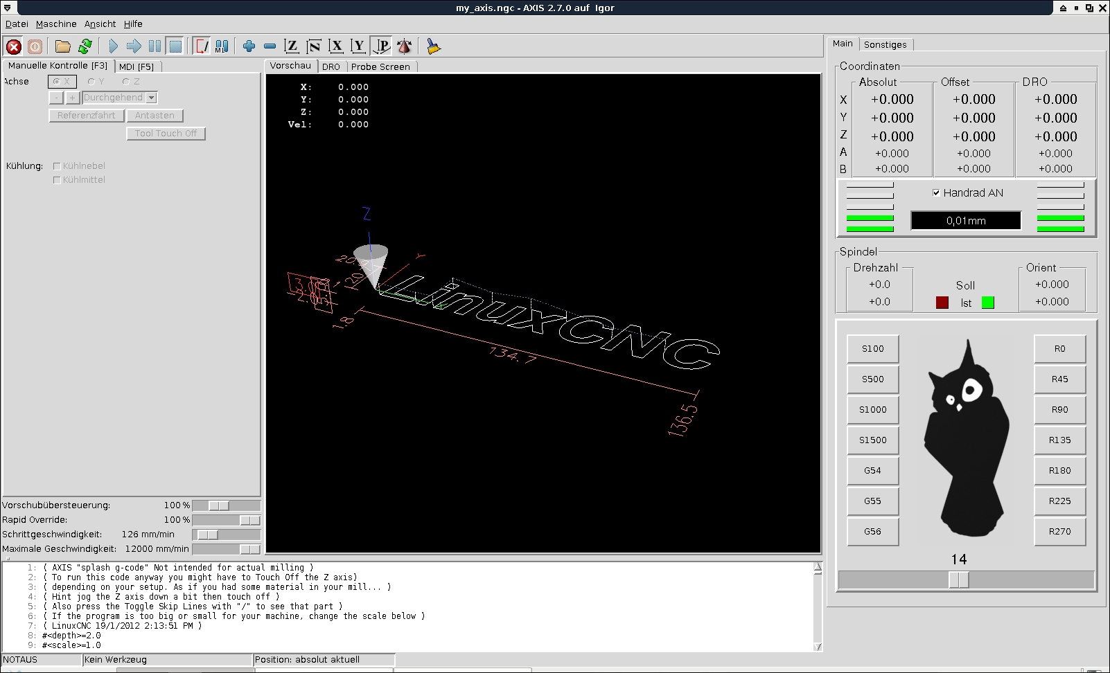

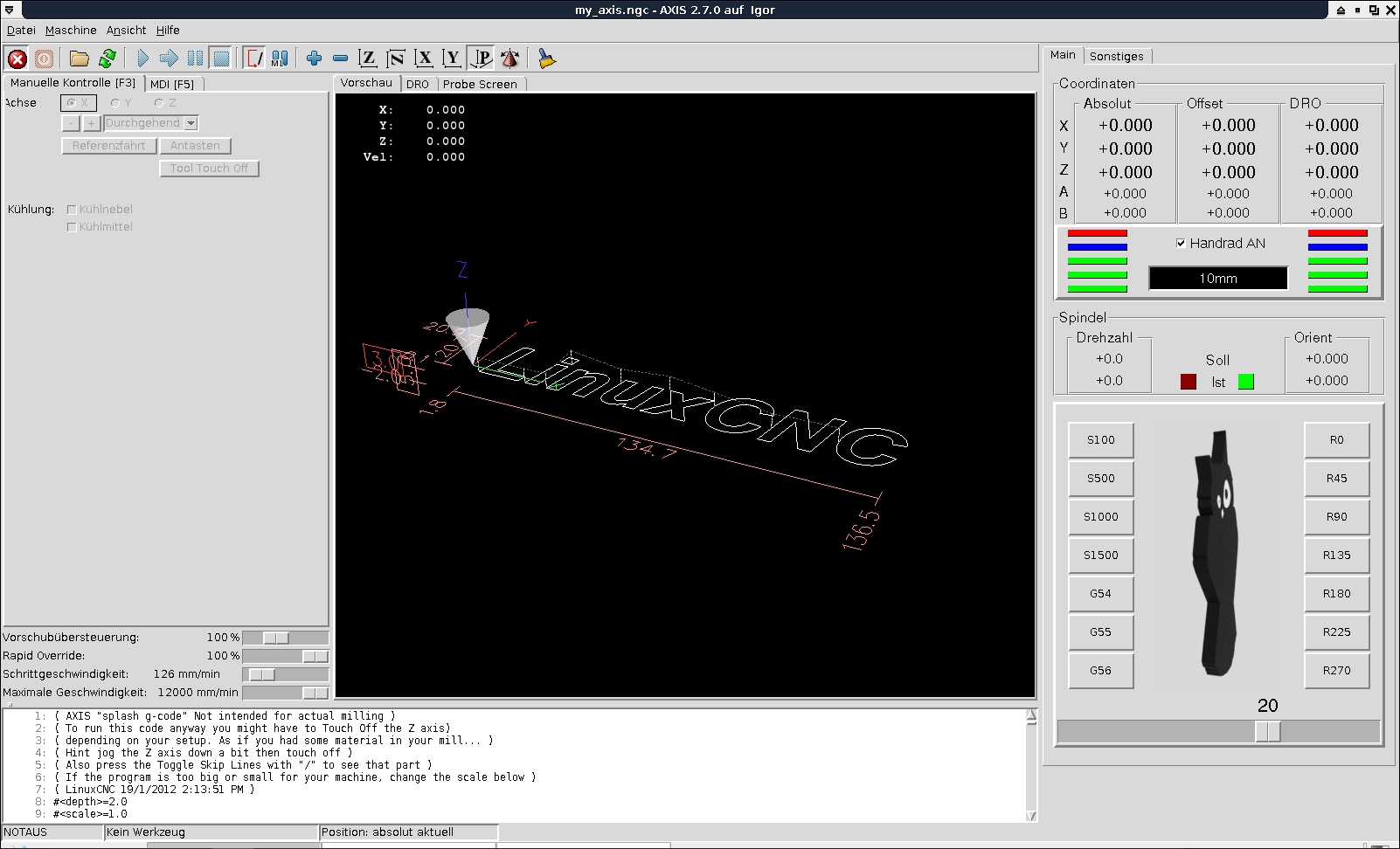

For the first test its for the Owl in my panel. Its an 3D rendered objekt framed in single jpegs to an image_u32.
Also im open vor every other idea!

	<checkbutton> <font>("Arial",12)</font> <halpin>"run"</halpin> </checkbutton>
	<image_u32 halpin='selectimage' images='1 2 3 ... 27 28 29 30'/>
	<image name='1' file='./My-Panel/EuleAnim/0001.png'/>
	<image name='1' file='./My-Panel/EuleAnim/0030.png'/>
</vbox>

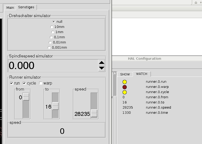

loadrt runner count=1
addf runner servo-thread
setp runner.0.to	30
setp runner.0.speed	100
setp runner.0.cycle	1       #(1=cycle 2=count only once)
net start => runner.0.run
net start <= pyvcp.run
net number => pyvcp.selectimage
net number <= runner.0.out

As i sayd above, i have no idea if it need to be complex. The timer.comp is verry close to what i need.
