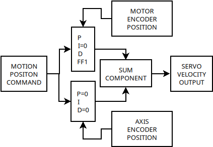

hey guys
just wanted to report back on this dual feedback thread
I have a large cnc with 0.1mm backlash on the z axis. so i put a scale on it and the results are awesome
i have accuracy within 0.002mm (compared to the scale accuracy at least assuming that is good)
i tried both 1 PID loop and 2 PID loops that have the outputs summed together.
with the single loop i had the velocity PID input coming from the motor rotary encoder and the final position from the linear encoder. and it worked but was really rough and kept bouncing back and forth with the 0.1mm backlash
the two summed loops are really smooth and awesome the trick is the first loop has the high resolution encoder on servo drive and that has really good performance and of course no backlash. and I can change all the normal PID values except Integral and the 2nd PID loop only has the linear encoder input. and only PID setting is Integral. so i get nice and smooth motor but still backlash from first loop and then once the axis gets close the Integral moves the last 0.1mm over a second or so.
so by the time i am cutting the machine is perfectly where it should be. this is probably not so good for high speed surfacing stuff for that you need to remove the physical backlash. but for a slightly slower machine its awesome.
have a look at this thread where i show some more photos of it. its working most days now and running hard in production.
forum.linuxcnc.org/show-your-stuff/58689...ing-running-linuxcnc
cheers

Thanks for sharing! This is great stuff. My mill is from the same time period, so same problems as yours I guess. It's a 1989 Maho MH600E.
One thing though, would you mind sharing your actual config files? That whould be the absolute best way to help us others who are also trying to wotk out how to make this work. And since my machine have much the same issues as yours I'm hoping to be able to have a closer look at a config file which is actually working, and have solved this problem.
Thanks for sharing! I hope you see this and are willing to share your config files too!

I wanted to add this to our docs some where for a guide to others.
When I looked at this and it seems you have both encoders connected to index-enable.
This seems wrong in my head, as it would depend on which encoder index fired first.
Any opinion or insight?

I agree this sounds off. I suspect it will very likely always find the one index first, and I expect that to be the servo index, unless home switch is quite near to scale index. I think ideally you'd want to use only the scale index.When I looked at this and it seems you have both encoders connected to index-enable.

Chris there is a bug with the index enable stuff i think when summing the PID loops like this. I forget exactly why i connected both encoder index pulses to index enable
i read i think earlier in this thread that you can connect both encoders to index enable and also connect them with a physical wire so the first index to fire triggers the homing. but i couldn't get it to work. rereading my post it sounds like i just messed this up but i really do think there is a bug. I could test if you want to go through with me and prove the issue. we have messaged off forum on messenger before..
so i tried just one PID loop with the velocity input coming from the encoder and the position input coming from the scale. and that homed to index enable fine but the tuning was really rough. i couldn't believe how bad it was. it was like there was a stuffed bearing on the ballscrew. and the axis kept bounching back and forth around the 0.1mm backlash which was unusable. and after i had just tested the other way with a smooth as silk axis that always stopped perfectly within 0.002mm I wasn't going back I talked about the mesa index enable issue with PCW a bit but i ran out of time to fully prove it was a bug. But i definitely think that having the 2 separate PID loops breaks the index enable logic.
anyway after all that i read somewhere on the forum that someone else had the same issue for some reason and the really inelegant solution is to run the home switch through classic ladder and have it trigger on the home switch first and then look for the change in homing state and on the next state when the encoder is searching for index pulse use classic ladder to feed it the encoder physical index pulse from rotary motor encoder on end of ballscrew. this means that you have to home that last little bit extra slow as it can miss the pulse. and it is not that best. But in saying that i haven't had it miss the pulse yet and it's not that much slower to home.
But i would like to fix this as this is the last annoyance that if it was fixed i would probably go crazy and put scales all over my machines lol
So Chris your classic ladder is still getting used all the time by people keep up the good work.
cheers andrew
