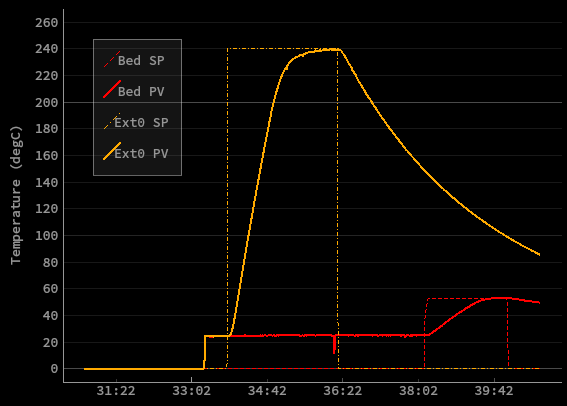

As part of the development of my 3D printing setup I have ported the very popular Arduino PID v1.2.1, by Bret Beauregard, controller code into a HAL component.
Why? It is a simple controller with one feature that it very useful for integrating processes, like 3D printer extruders. Proportional on Measurement. This allows for Zero overshoot to be achieved.
The component is available on my GitHub page at PIDcontroller.c
I hope others find this useful as well.

Just curious why this was needed? Why couldn't the regular PID component that comes with Linuxcnc be used? In other words what does your new PID do that the old one can't, or why is it better for your situation?

The standard PID component has only the option to use Proportional on Error in the PID calculation. To avoid heating overshoot on a 3D printer extruder, Proportional on Measurement can achieve this.
From brettbeauregard.com/blog/2017/06/introdu...onal-on-measurement/
"There are processes out there that are known as “Integrating Processes.” These are processes for which the output from the pid controls the rate of change of the input. In industry these comprise a small percentage of all processes, but in the hobby world these guys are everywhere: Sous-vide, linear slide, and 3D printer extruder temperature are all examples of this type of process. "
And it works!
Scott
