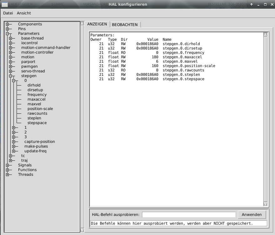

Here is a picture of what I think is causing the problem:

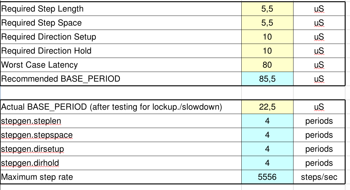

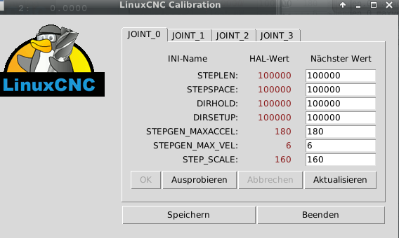

After reading and reading i was possible to get closer. The 4 values are taken from the base_period variable within the .ini. A change of the base period changes steplen/stepspace/etc too.
It looks like within the .hal DoubleStep is enabled. I tried to disable it but that changed nothing. Do I need DoubleStep? And how can i fully deactivate it?
The question is: What changes do the config files need to accept the values for steplen etc.

07 Oct 2019 23:11 - 07 Oct 2019 23:12 #147382 by millhouse_
Replied by millhouse_ on topic Dual motor gantry settings
If I use DoubleStep. Would this be the way to to do it?
