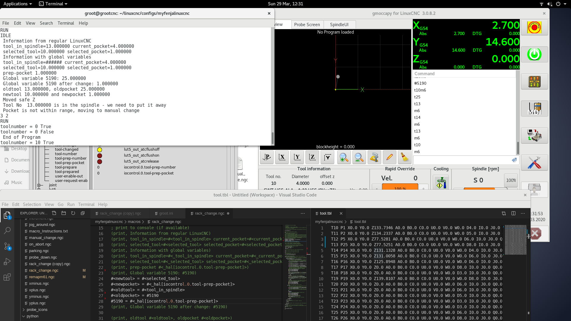

- GuiHue
- Posts: 112
- Thank you received: 39
29 Mar 2020 20:37 #162020
by GuiHue
Replied by GuiHue on topic Non-random ATC, gmoccapy & tool pockets numbers
I am aware of those parameters, both in their regular, as well as the global (_) form. However, _current_pocket and _selected_pocket contain nonsense (i.e. the line number in the tool table).
#<_hal[iocontrol.0.tool-prep-pocket]> returns the correct selected pocket.
See Screenshot with tool.tbl, gmoccapy, rempa macro and terminal output.
There is one more thing that i have noticed.
If I enter the following lines in MDI:
T12
M6
Everything is fine and #<_hal[iocontrol.0.tool-prep-pocket]> in ngc macro will work as expected.
If I enter a combined command, e.g.:
T12M6
Then #<_hal[iocontrol.0.tool-prep-pocket]> returns 0.
Regular M6 Remap works fine.
Is this a known issue?
Version: most recent master
T12
M6
T12M6
- Thank you received: 4654
29 Mar 2020 21:11 #162024
Replied by andypugh on topic Non-random ATC, gmoccapy & tool pockets numbers
Access to the hal pins from G-code comes with significant caveats. It can only reliably be used for getting values that apply at the point that the program starts.
It will sometimes give the right answer during a program, mostly after a queue-buster such as a tool change.
If the HAL pin is the reliable source then the dependable way to get it is to net that pin to a G-code analogue input and read it with M66.
(I would be the first to admit that this seems needlessly convoluted)
Which version of LinuxCNC are you using? I did actually think that this problem with the parameters had been fixed.
