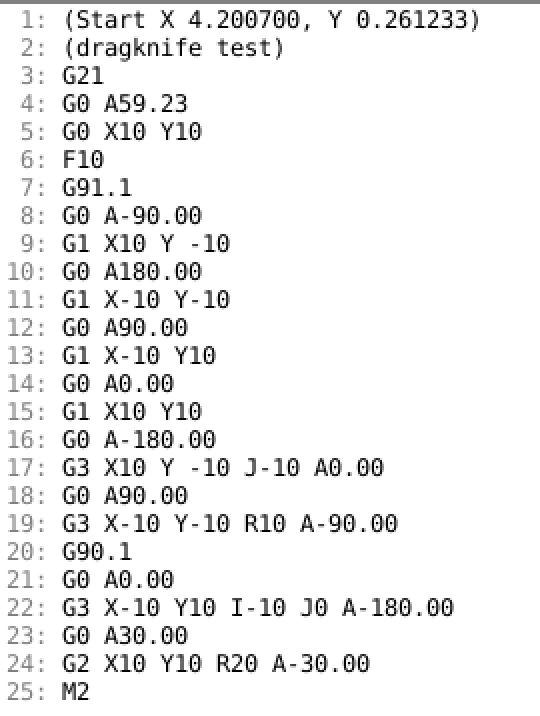

Here is a partial solution. It is an input filter that converts this input:
To this output
Which almost, but not quite, does what is needed.
The problem I am seeing is that whilst he angles of the starts and ends of arcs are correct, the tool won't necessarily turn the right direction to cut properly.
But I am going away for a week, so thought that it might be best to hand it over, in case you want to try to make the required changes.

M2To this output
It uses the normal atan2 convention where the +X direction is 0, +Y = 90, -X = 180/-180 and -Y = -90. Your A axis would need t change that.
A variable defined near the top allows for changing to use C for the tool rotation.
