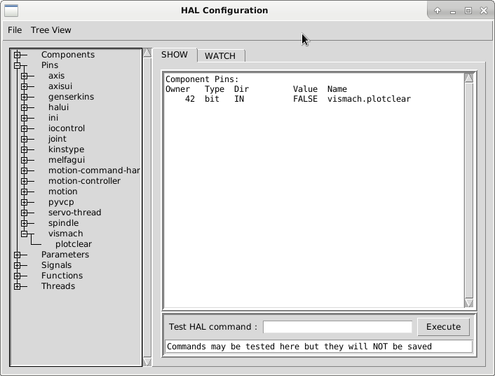

I tried to implement it.
Created a pyvcp button and added this to the ..-postgui.hal
net :vismach-clear <= pyvcp.vismach-clear => vismach.plotclear
But I get an error on startup
melfa-switchkins-postgui.hal:6: Pin 'vismach.plotclear' does not exist
So clearly I'm missing something.

Replied by tommylight on topic VISMCH delete old toolpath
-omit the line containing 'vismach.plotclear' in the "melfa-switchkins-postgui.hal" file , should be line 6 in the text editor.
-start linuxcnc, if it starts without errors, open "machine>show hal configuration", then on the left side expand "pins" and lover find "vismach" and also expand, there should be the correct naming of the pin for clearing the plot.

26 Feb 2020 07:03 #158508
Replied by Aciera on topic VISMCH delete old toolpath
The spelling should be right but maybe vismach is not yet loaded when I try to create that HAL-pin?
Maybe somebody finds something obvious.

26 Feb 2020 14:46 - 26 Feb 2020 16:08 #158545
by dgarrett
I think the problem is related to the fact that your stl
files are more complex than ones used by prior vismach guis
and there is a timing race related to the parsing of
these files and the execution of the postgui halfile that
connects the vismach.plotclear pin.
A workaround (without modifying the axis gui) is to
move the execution of the postgui hal file to an
[APPLICATION]APP=file as shown in this diff:
The DELAY in the [APPLICATION] section increases
the wait time for executing the APP file. The delay time needed will
depend on the complexity/number of stl files and the speed
of the computer.
Ref: linuxcnc.org/docs/master/html/config/ini...applications_section
