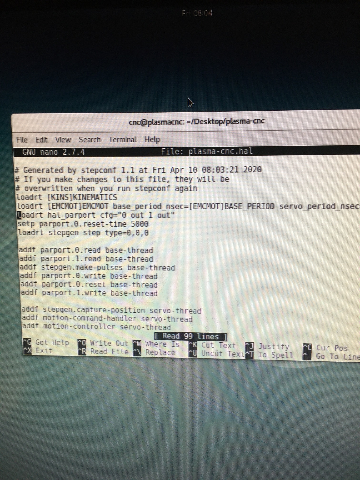

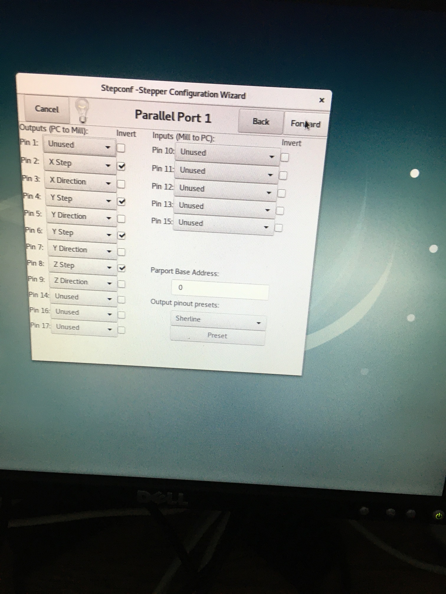

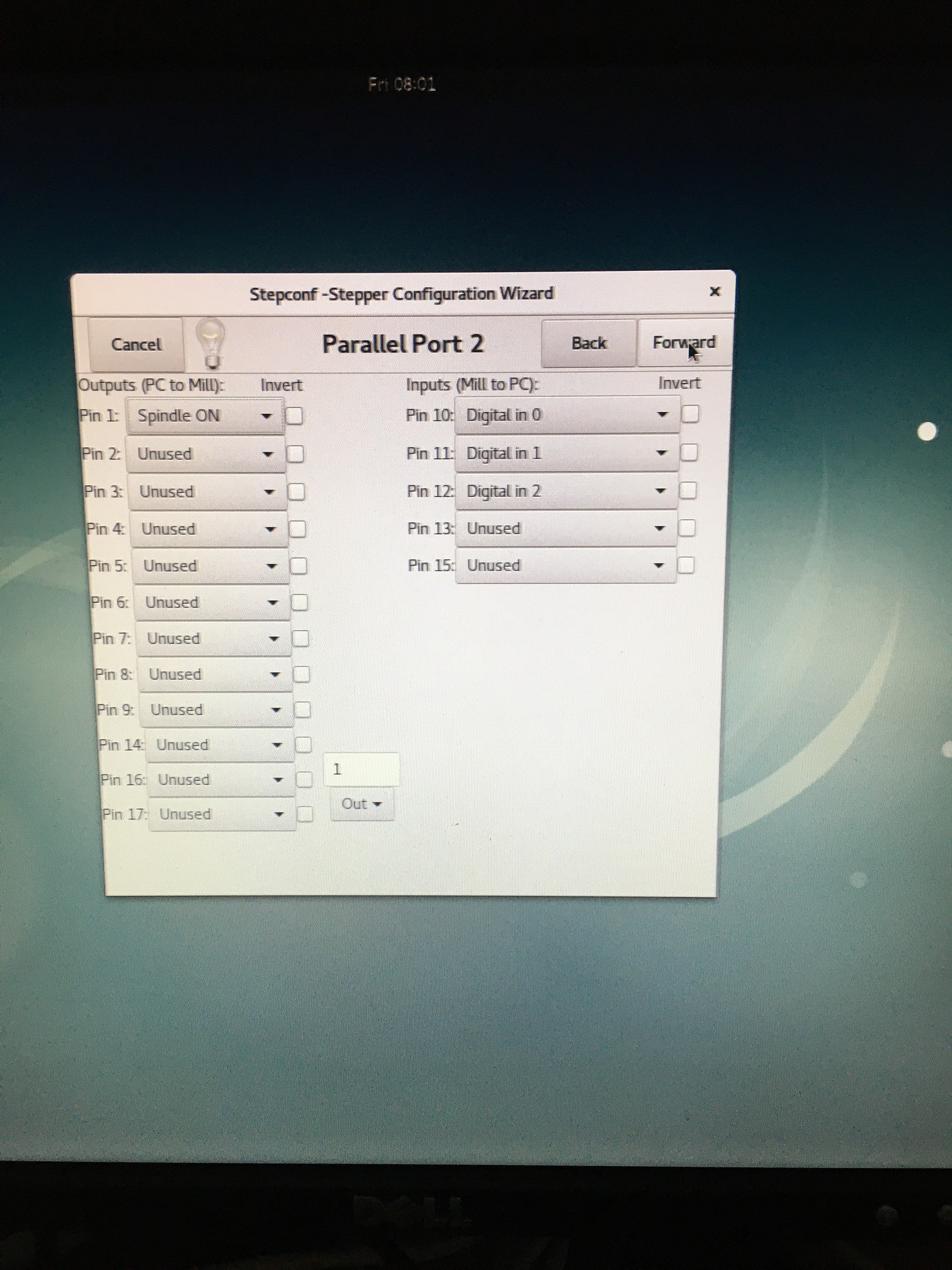

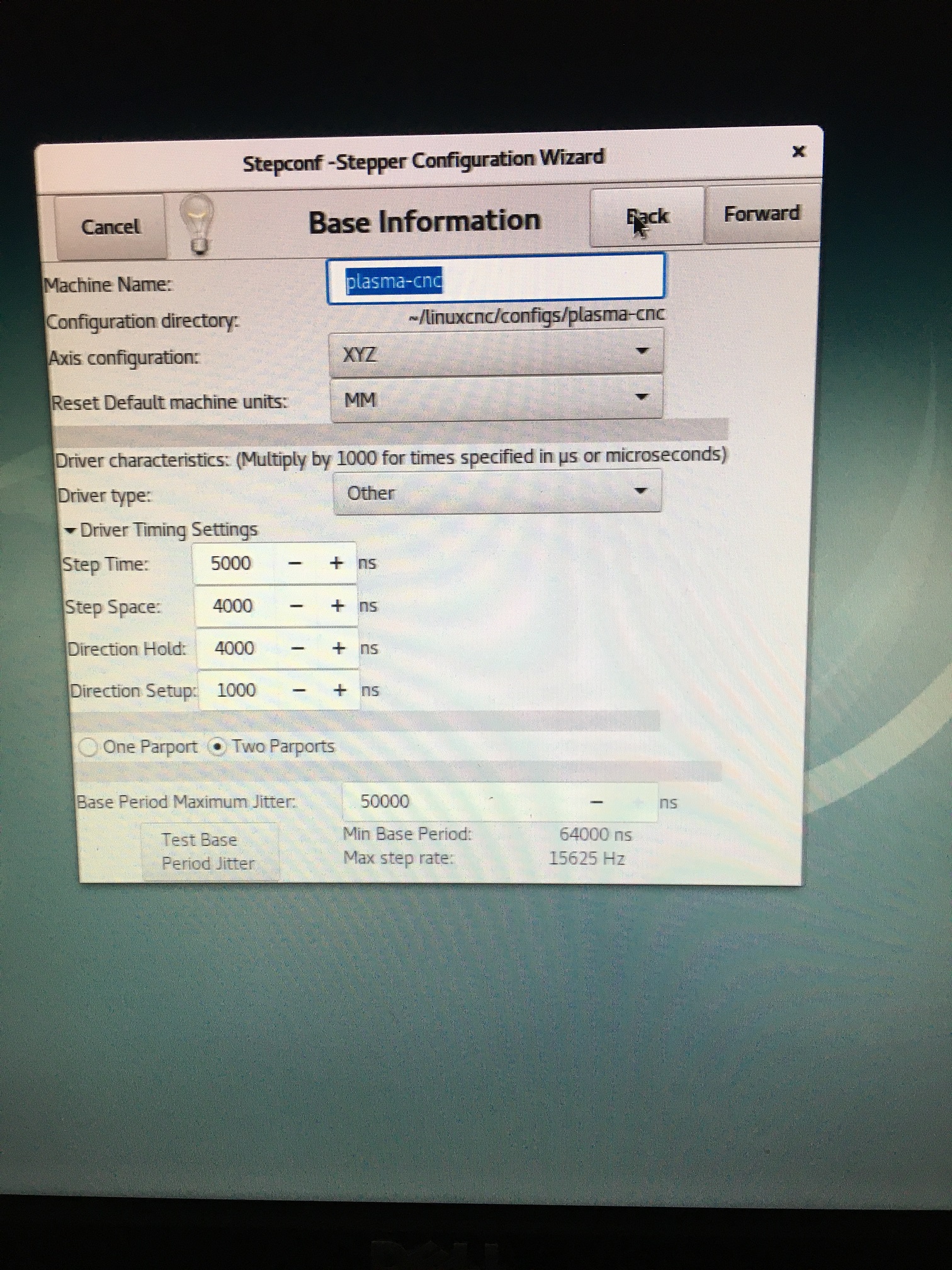

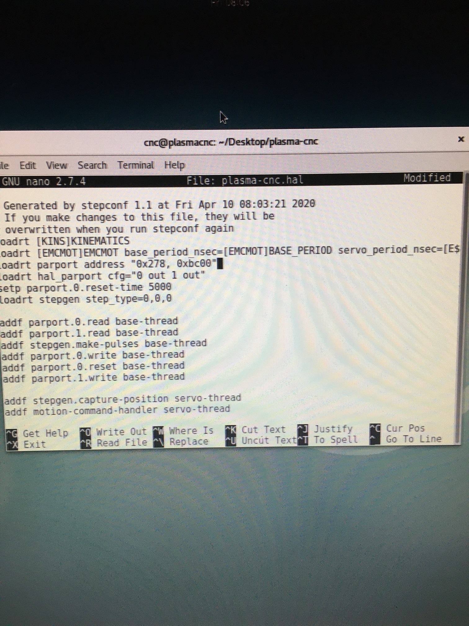

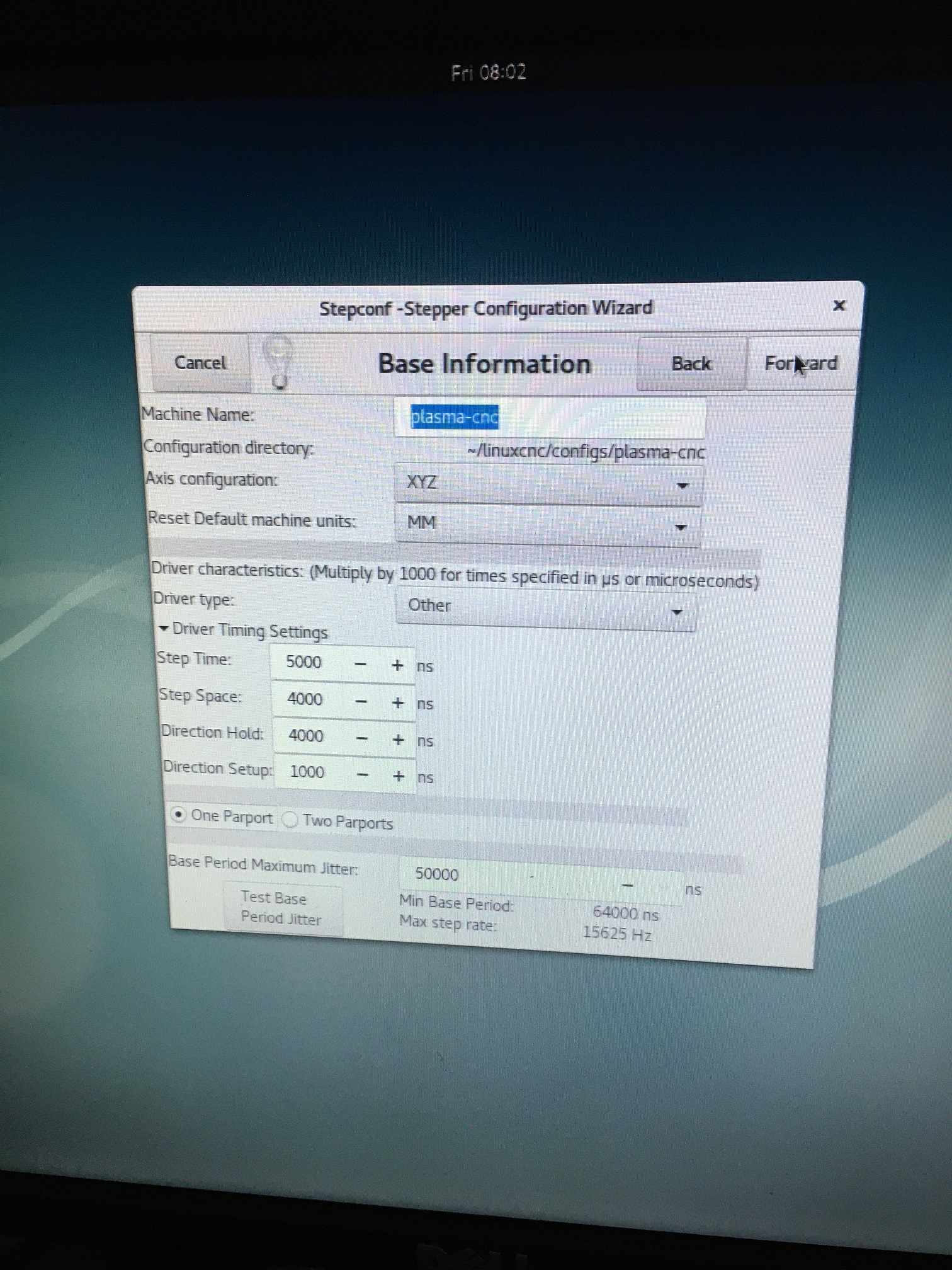

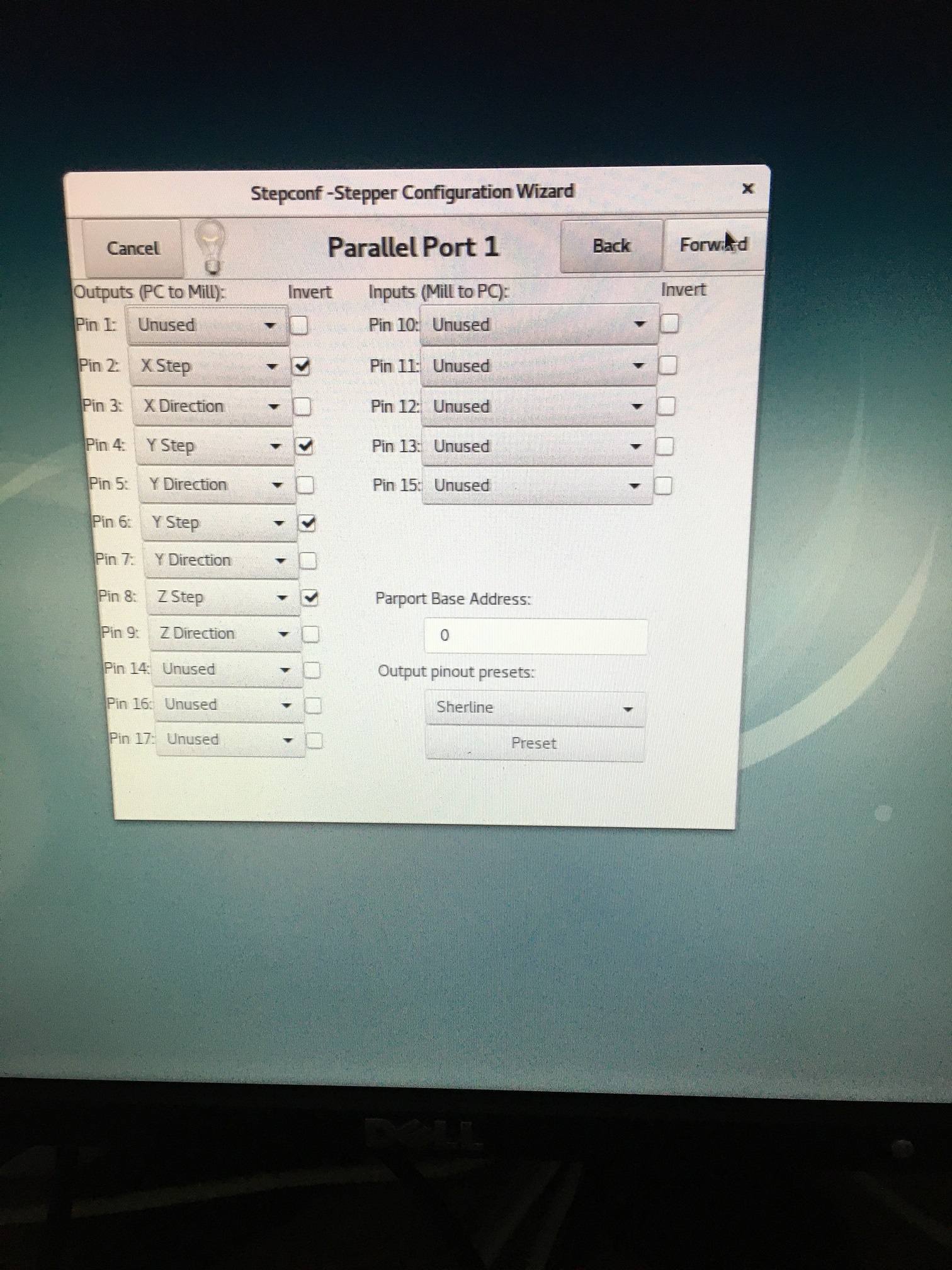

I did this test in the morning, but I think I might be doing things not 100% right
I'm attaching photos of my screen and changes in .hal (I'm not sure if in the correct one)
I have also found LPT tester, but it works only on LPT1, I've tried to add address as suggested, but it didn't work

6 years 6 months ago - 6 years 6 months ago #163629
by radek_marko
Replied by radek_marko on topic Second LPT port

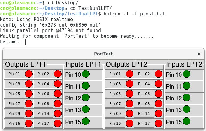

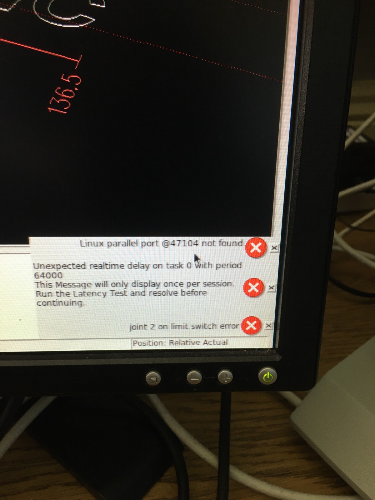

tommylight - Thank you very much for giving me the direction to follow. I've managed to test my LPT port, but I STILL CANNOT completelly fix the issue
Just to remind my situation:
I've downloaded the LPT tester - from this thread LPT tester .
Then I have changed the address
as Tommy suggested, but without any positive result then I have changed it to
and it worked as per video in this link:
VIDEO
Then I moved to the config of LinuxCNC and I've put 0x278 as the address of the first parallel port and 0xb800 as the address of the second parallel port. The config is now able to move all step motors. To test 2nd LPT I've added the z-limit switch to be on this port and I'm getting an error when running LinuxCNC - see attached photo.
Any help would be massively appreciated as I know that the extension card works correctly.
I have also created a dual-port tester, might be useful for someone like me in the future (print screen below)
was the key for meloadrt parport address "0x378, 0xbc00"
Code:
lspci -v
02:02.0 Parallel controller: Device 1c00:2170 (rev 0f) (prog-if 01 [BiDir])
Subsystem: Device 1c00:2170
Flags: medium devsel, IRQ 11
I/O ports at bc00 [size=8]
I/O ports at b800 [size=8]
Code:
loadrt parport cfg="0xbc00 out"
Code:
loadrt parport cfg="0xb800 out"
