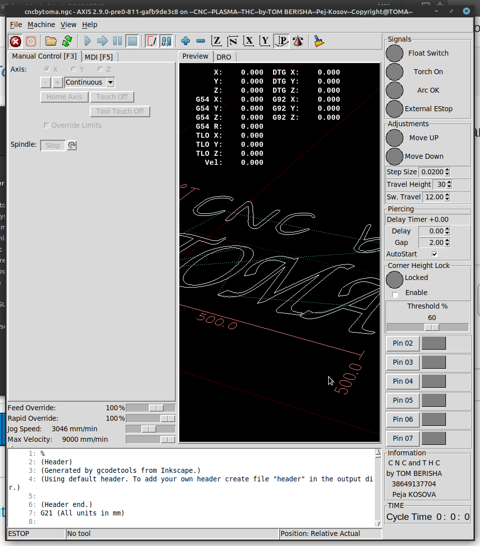

Can this be incorporated into the Axis UI? When we run it and then start Axis the tester disappears.
- Todd Zuercher
- Posts: 4786
- Thank you received: 1476
06 Nov 2019 18:42 #149742
Replied by Todd Zuercher on topic Re:Parallel Port Tester
Not really, any hal pins for the parallel port that are used in your cnc config interfear with their use in the parallel port tester.

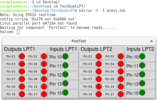

11 Apr 2020 16:44 #163637
by radek_marko
Replied by radek_marko on topic Parallel Port Tester
This is my version of parallel port tester for dual-port setup.
In my case, I have one LPT port onboard (address 0x278) and the second is on PCI card reported as:
lspci -v
02:02.0 Parallel controller: Device 1c00:2170 (rev 0f) (prog-if 01 [BiDir])
Subsystem: Device 1c00:2170
Flags: medium devsel, IRQ 11
I/O ports at bc00 [size=8]
I/O ports at b800 [size=8]Attachments:
