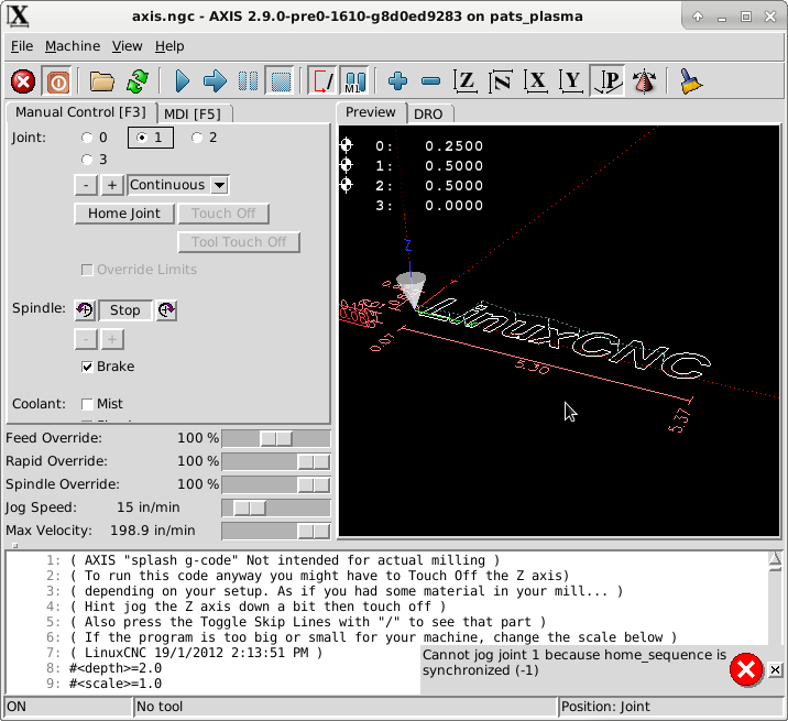

I added the HOME_SEQUENCE = -1 to both of the Y axis joints. They do move at the same time in the same direction for homing, but they will not jog afterward. I get an error saying it can't jog because they're synchronized (attached screenshot and INI file). I have made no changes to the HAL file.

I knew it had to be something dumb I was leaving out. Homed the rest of the machine and it all works now. Thanks for the help!
