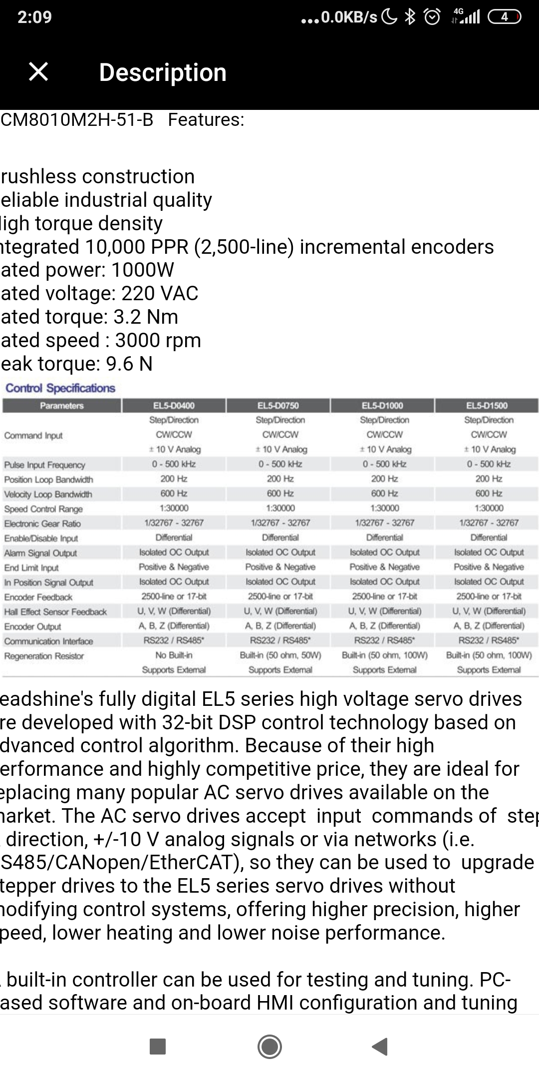

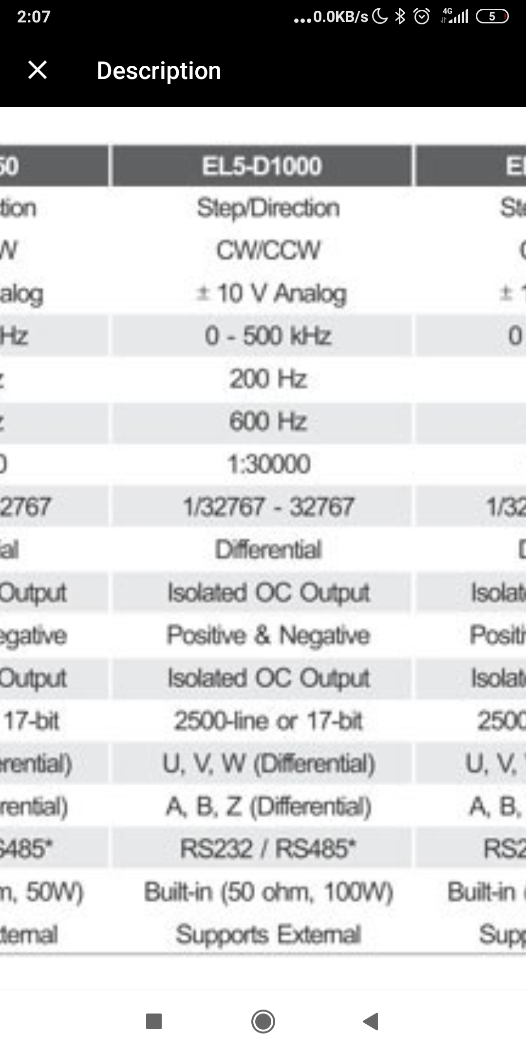

01 Jun 2020 00:08 - 01 Jun 2020 00:11 #169596 by Marcodi
What information do you need extra? Which encoder the driver of the motors? Driver is leadshine EL5-D1000. I attached screenshot of specs
My system is rack and pinion only the z axis is lead screw.
Is this total pulses that I need to devide by number of Stepgens or is this capable pulses per stepgen

01 Jun 2020 00:18 #169597 by PCW
Each stepgen is independent so the number of axis doesn't matter
Those drives will take up to 500 KHz pulse rates so you can go much shorter than
5000 ns pulse width

01 Jun 2020 13:48 #169668 by PCW
The minimum steplength and stepspace for that drive are 1000 ns, though you
should in general not use minimum values but add some margin.
