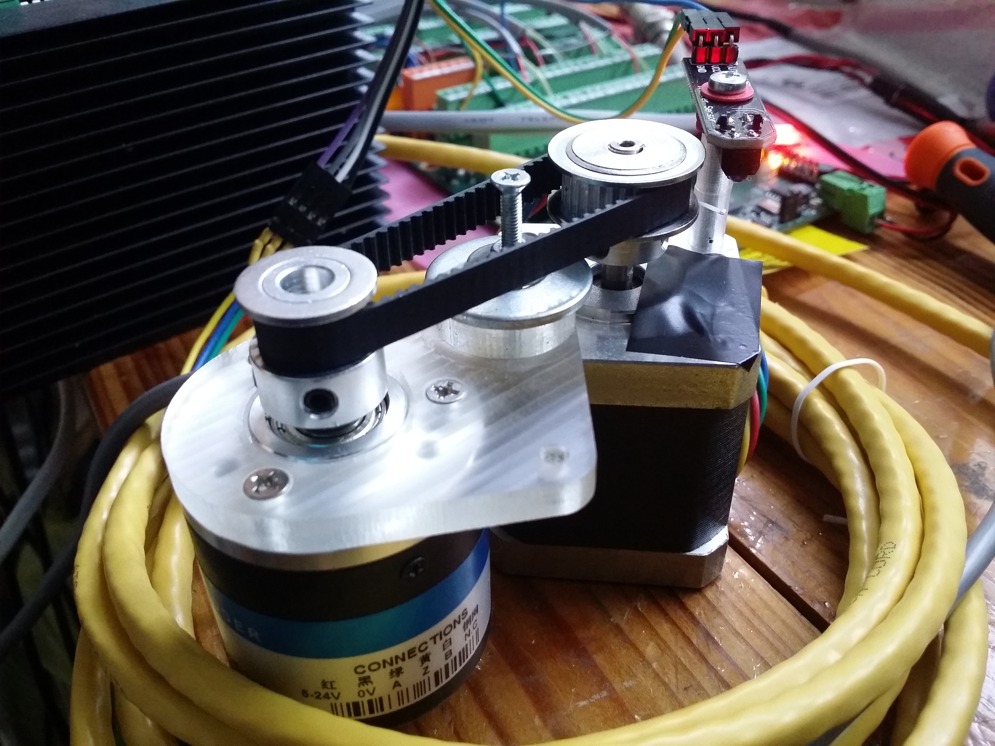

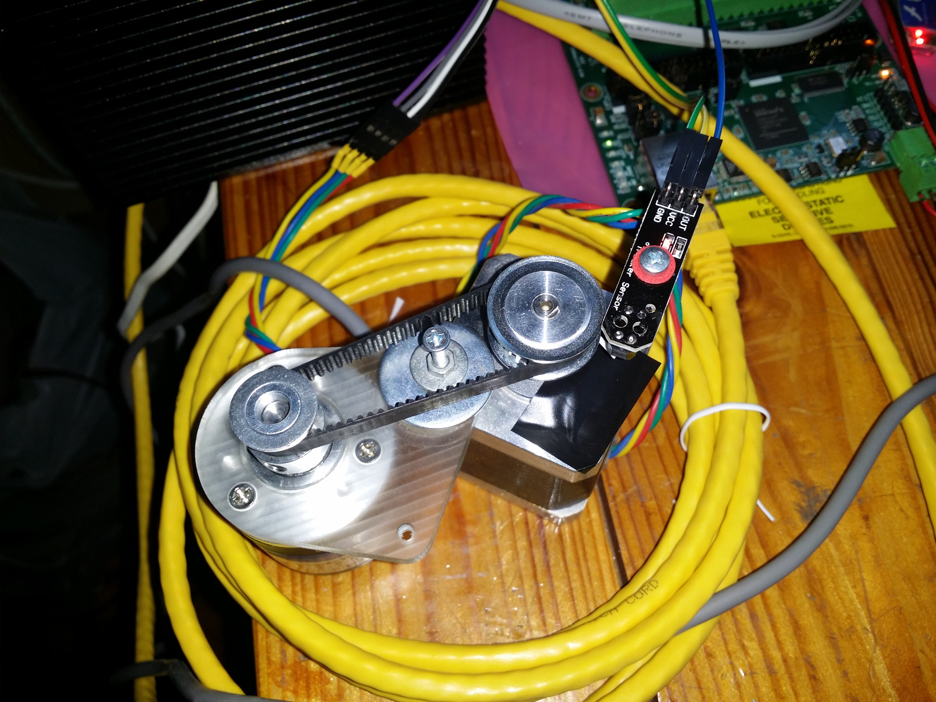

31 Jul 2020 15:05 #176669
by xenon-alien
Replied by xenon-alien on topic MESA 7i76E For Lathe Step-Dir Spindle, Orient and Rotary Axis
Today I just tried to replace everything in original Spindle.hal file for my 7i76E board and my stepgens, but No success...
Not really understand the values in .ini file...
I have a nema17 stepper motor 1/2 microstepping, so for a full rotation I have 400 steps. Belt drive Encoder for 600pps + ratio 1.5 : 1 = 900pps and I have 3600 in the ini file (generated config with PncConf working well with this values)
But in modification not...
On m19 r0 it can just stop in random position, or rotating endless
If I type in m19 r180 it's speeds up and goes into resonance till I do not turn of with m5.
Is it possible to use the spindle like a Rotary Axis somehow?
Maybe the index impulse is too long? (short video Step/Dir Spindle in my insta)
www.instagram.com/p/CDO4g4rpxAl/
www.instagram.com/p/CDKCD-LJB8n/

02 Aug 2020 19:48 #176931
by xenon-alien
So, I figured out.
The ENCODER_SCALE must be equal to STEP_SCALE in microsteps, but in my case it's impossible.
How can it be modificated to use different STEP_SCALE?
For now I use ENCODER_SCALE = -3600 (rotating to other direction needed in my case "-") and 3200 microstepping and looks really close to reality.
www.instagram.com/p/CDZfz0qJsZ8/
