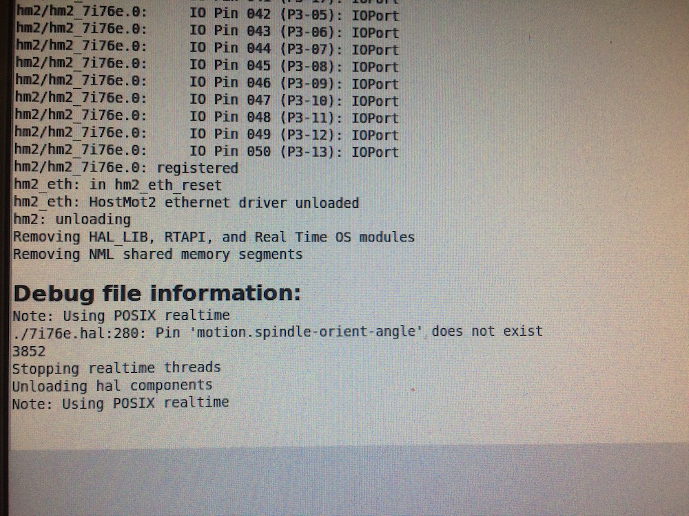

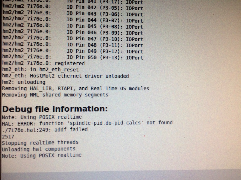

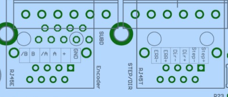

I'm trying this too right now with the Mesa 7i76e DIR/STEP for Spindle. Now i have a Debug Error: spindle-pid.do-pid-calcs not found.
I have a controller with step/dir direction and Encoder RJ45E
I wanted to connect to TB 3 Stepper 4 or so.

05 Mar 2021 18:01 #201113
Replied by PCW on topic MESA 7i76E For Lathe Step-Dir Spindle, Orient and Rotary Axis
try changing
loadrt pid names=pid.x,pid.y,pid.z,pid.s
to
loadrt pid names=pid.x,pid.y,pid.z,spindle-pid
to
- xenon-alien

Thanks @PCW for info. Next Debug File is motion spindle orient angle

07 Mar 2021 14:10 #201294
the name for recent 2.8 or greater would be:
spindle.0.orient-angle
(all spindle names changed by dropping "motion" and adding the spindle number)

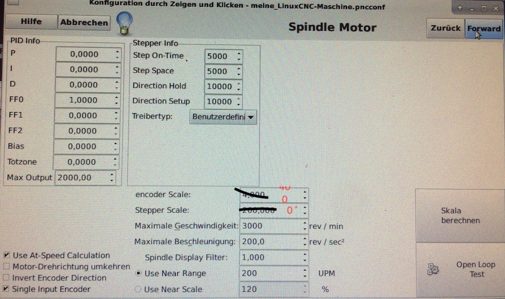

14 Mar 2021 15:15 #202214
by Marki123
Replied by Marki123 on topic MESA 7i76E For Lathe Step-Dir Spindle, Orient and Rotary Axis
The spindle is now running but another problem. In orientation mode nothing work. Also M19 r0 nothing run.
M3 S100 direction of rotation works switch to M4 work.
Does somebody has any idea?
16 Mar 2021 22:27 #202531
Replied by andypugh on topic MESA 7i76E For Lathe Step-Dir Spindle, Orient and Rotary Axis
If you follow the signal path with Halmeter, can you see the orient pins and values appear on the spindle.0 pins when you issue the M19?
Do you then see those values go to where they need to go to orient the spindle?

by Marki123
I have to look at the halmeter again. Maybe my hardware is not quite correct. I take a HEDS 5500 with 500 Impulse. And put the 500 Impulse on the config spindle setting.
