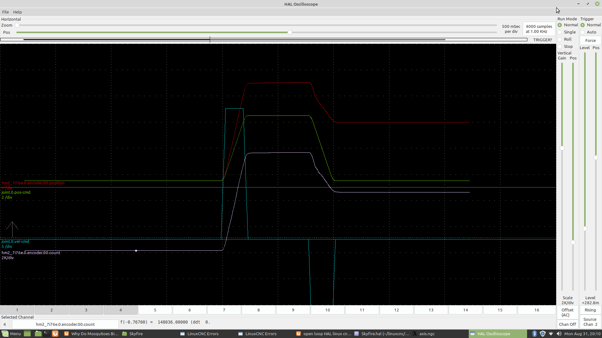

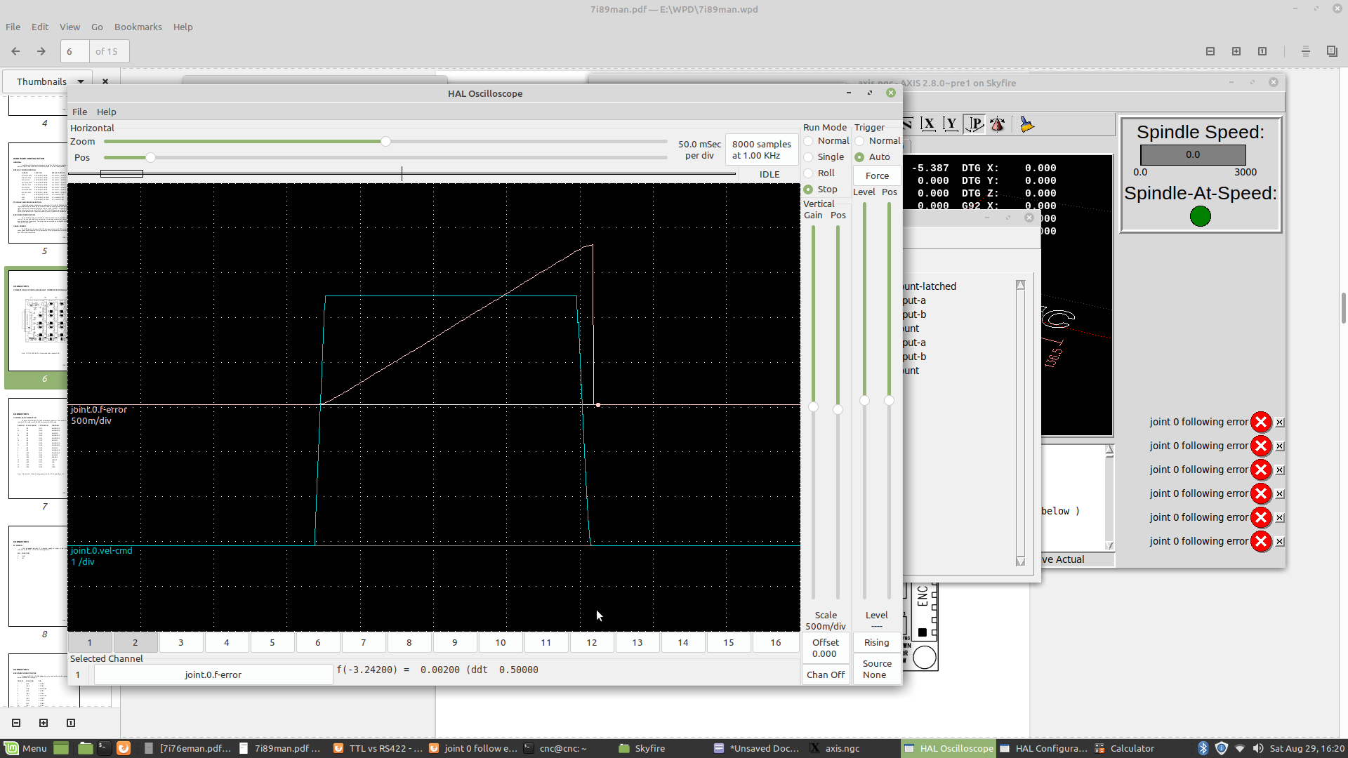

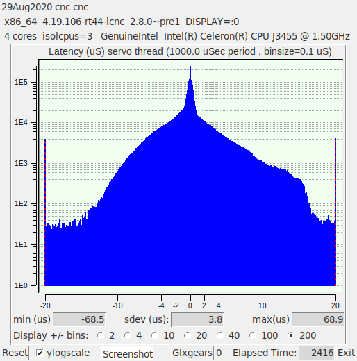

Howdy all,
I am working out my first axis on this machine, its a retrofit AC Servo based machine with encoders. I am using an 7i76e + 7i89 and a 5 Axis Bob. I have the X axis wired up and pulses are moving it (yah) the encoder is returning data (yah). However between .3 and .6mm of movement I get Joint 0 Following Error.
Here are some machine/servo facts.
1) 5000 steps/rotation
2) 5mm sweep ball screw
3) 2000 encoder pulses/ unit (or 10000 encoder pulses/rotation)
a) encoders are using RS-422, tried TTL and nothing was recording
4) testing as confirmed hm2.0.7i76e.0.encoder.00.count is bang on the correct number of encoder pulses for the distance moved before it fails out...
5) I have some scope data (see below) & I did a latency histogram (40 minutes with two glxgears running and a long youtube video streaming)
6) yes I have wifi on here
7) I am using dedicated ethernet and have the 7i76e using 10.10.10.10 ip
8) I have tried several different FERROR and MIN_FERROR values
a) min_ferror that isn't 0 causes the ferror to crawl upwards when nothing is moving
b) negative min_ferror actually causes the axis to move VERY slowly
c) any FERROR over about 500 causes the error to happen almost instantly and I can have to press the "power" multiple times before it will stay on long enough to try to jog the axis
d) FERROR of around 10 "turns on" very stably but the machine movement is significantly smaller than
Here is the HAL (Most of these settings are "out of the box" from PNCCONFIG and seem pretty conservative compared to the settings the controller I am replacing had)
Here is the INI
Attached are pictures of the histogram and scope
as always thanks in advance for any suggestions on what to tinker with

- Posts: 21963
- Thank you received: 7478
29 Aug 2020 22:36 #179981
Replied by tommylight on topic yet another Joint.0.Following error (but I promised I searched a lot first)
Set the f-errors as they were, then have a go at this:
www.gnipsel.com/linuxcnc/tuning/index.html
And after that have a slow run a t this:
forum.linuxcnc.org/10-advanced-configura...ning-detailed-how-to
- Posts: 18103
- Thank you received: 5326
29 Aug 2020 23:54 #179984
Replied by PCW on topic yet another Joint.0.Following error (but I promised I searched a lot first)
Set all the P terms to about 5 to start
Delete all the "setp pid.N.maxerror .0005" statements
Expect runaways as it looks like you have the feedback reversed
If you get runaways, reverse the sign of STEP_SCALE
Then try tommylight's tuning suggestions

- Posts: 18103
30 Aug 2020 01:24 - 30 Aug 2020 01:25 #179991
Joint following errors are pretty much expected until you get the tuning right
They may also be caused by drive setup (filtering or acceleration limits in the drive itself)
To eliminate the velocity limit you will have to lower the step time and step space
parameters
Crawling in one direction suggests you have a problem with the encoder feedback
parameters
