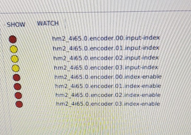

As far as I understood encoder.N.index-enable should be disabled (when enabled manualy) after it gets an impulse on encoder.N.input-index ?
Here is what it looks like after powering up the machine:
The Spindle (encoder.00.input-index) stays low all the time and the other axes stay high all the time.
I tried to read the index signals on all Axes but seems to not work on all of them, but my Oszi shows them ...
The A and B Encoder inputs work just fine and all axes are movable...

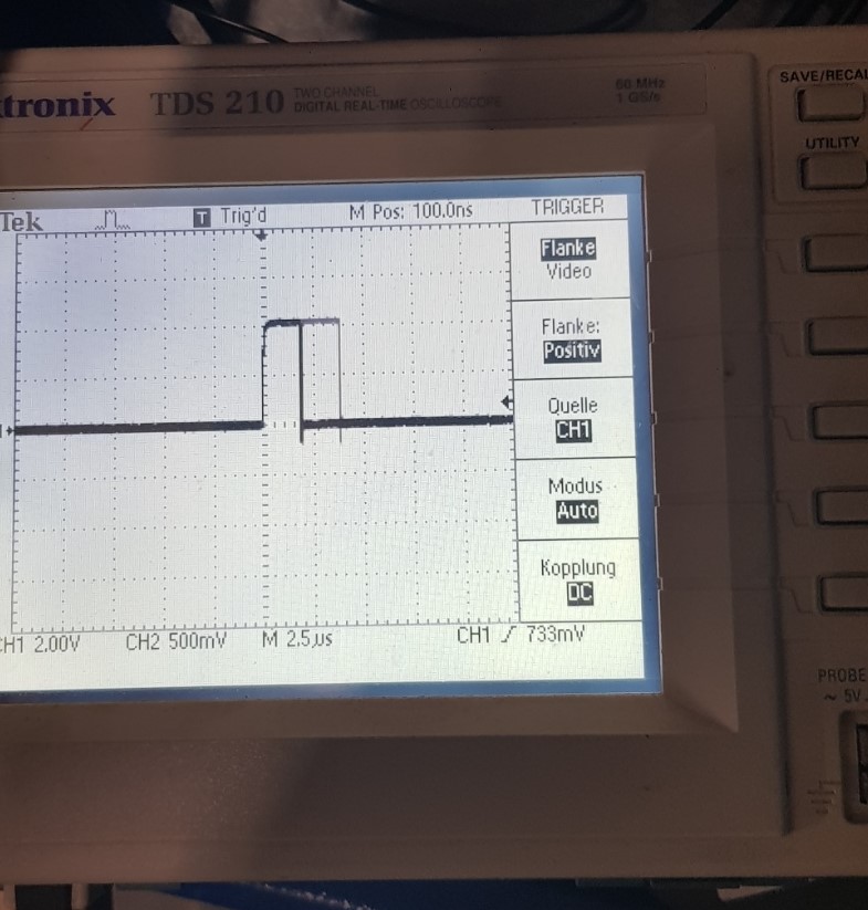

I meassured the output of the index signals with my Oszi.
Looks like the Index impulse is present, but I cant find a way to make it work in linuxcnc.

Hello Peter,
Thats what I tried.
but It didnt clear at any time, tried it on all axes
Also strange that the hm2_[HOSTMOT2](BOARD).0.encoder.N.input-index pins are always high on Axis 1,2 and 3
Thats what I tried.
sets hm2_[HOSTMOT2](BOARD).0.encoder.00.index-enable truebut It didnt clear at any time, tried it on all axes

Your right I just wrote what I had in mind.
This is how I have it in my .hal file
I checked that input-index pin in Halscope but there was just a flat line.
Tried it with different spindle speeds from 5 rpm to 100rpm but always a flat line
The A and B lines show up as they should in Halscope.
net spindle-index-enable <=> hm2_[HOSTMOT2](BOARD).0.encoder.00.index-enable
#home the spindle during first revolution
sets spindle-index-enable trueI checked that input-index pin in Halscope but there was just a flat line.

I searched further.
Turned out that the battery of the spindle servo motor encoder (Its a Multiturn Resolver on a Indramat MKD091 Motor) was dead.
After changing the battery, I was able to get "proper" index Signal with Halscope.
I then powered the Servo Motors Break externally to be able to rotate the motor axle freely and find the index position, which served me a strange result
It seems the motor encoder has 4 Index marks all 90 degrees apart.
The Encoder emulation output seems to throw these 4 index positions too.
Guess thats why I have that strange behavior with orient M19 R0 stopping at different positions but all in 90 degree segments...
I dont really understand why they use 4 index impulses instead of one but now I need to find a way to work with 4 index signals per Rev.
Do you have any Ideas how to handle that ?
