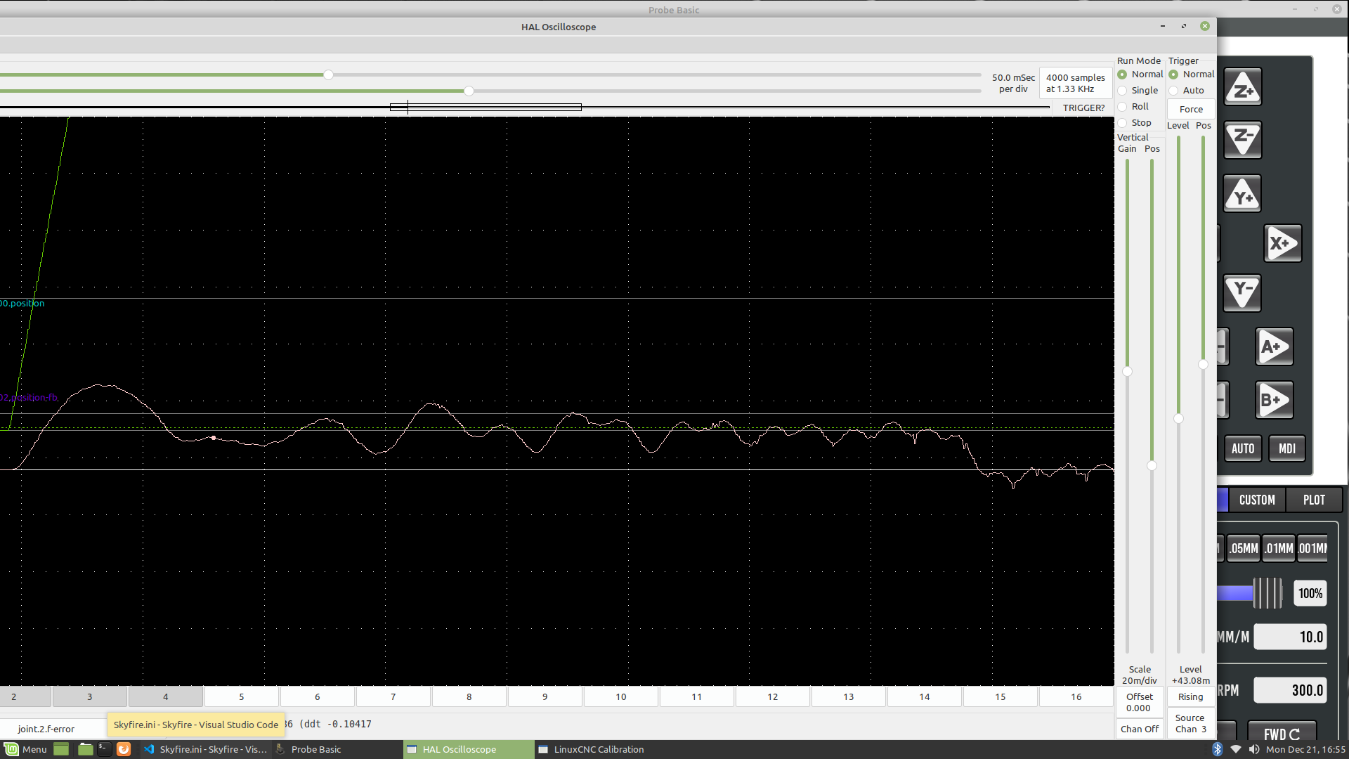

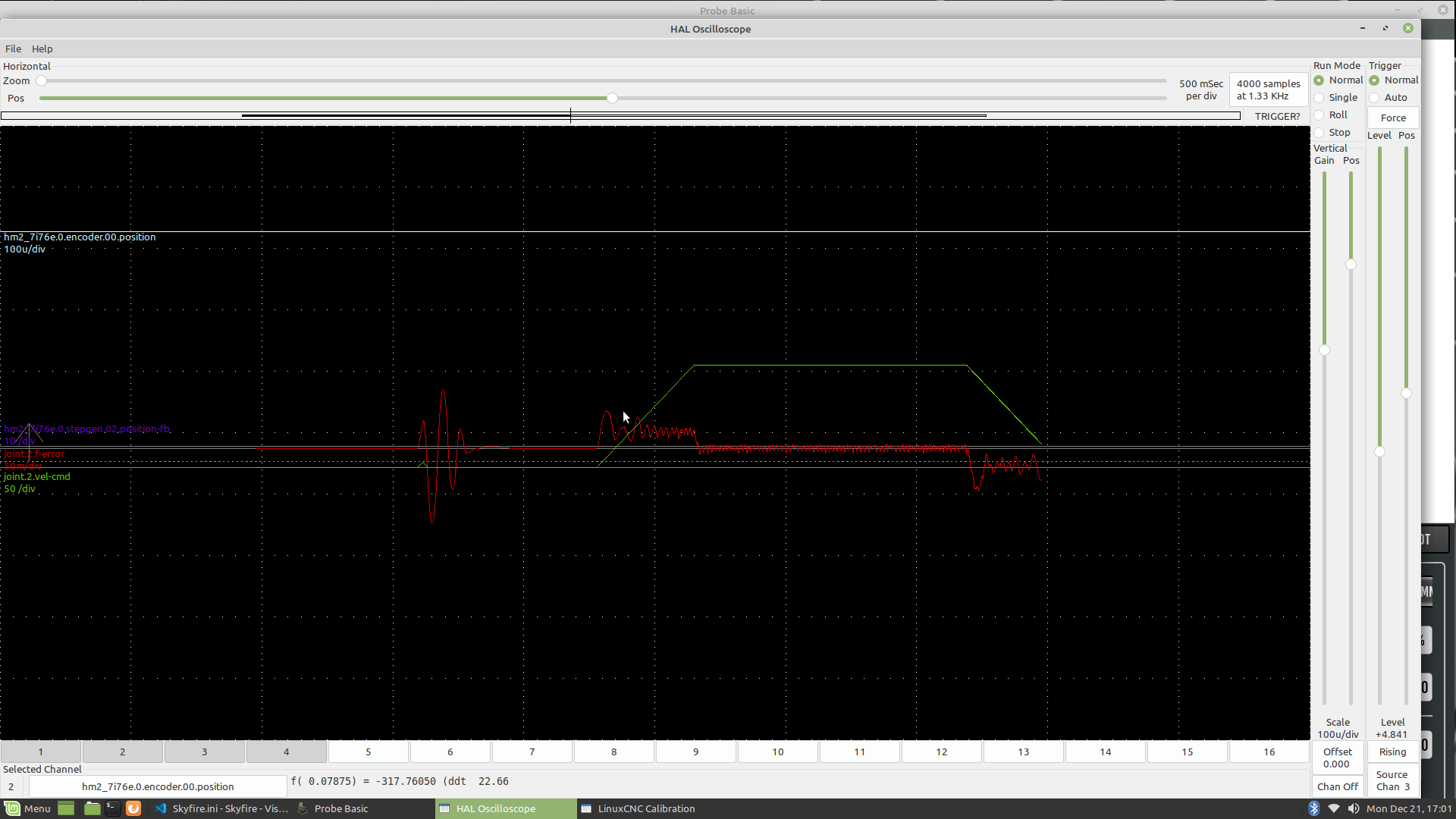

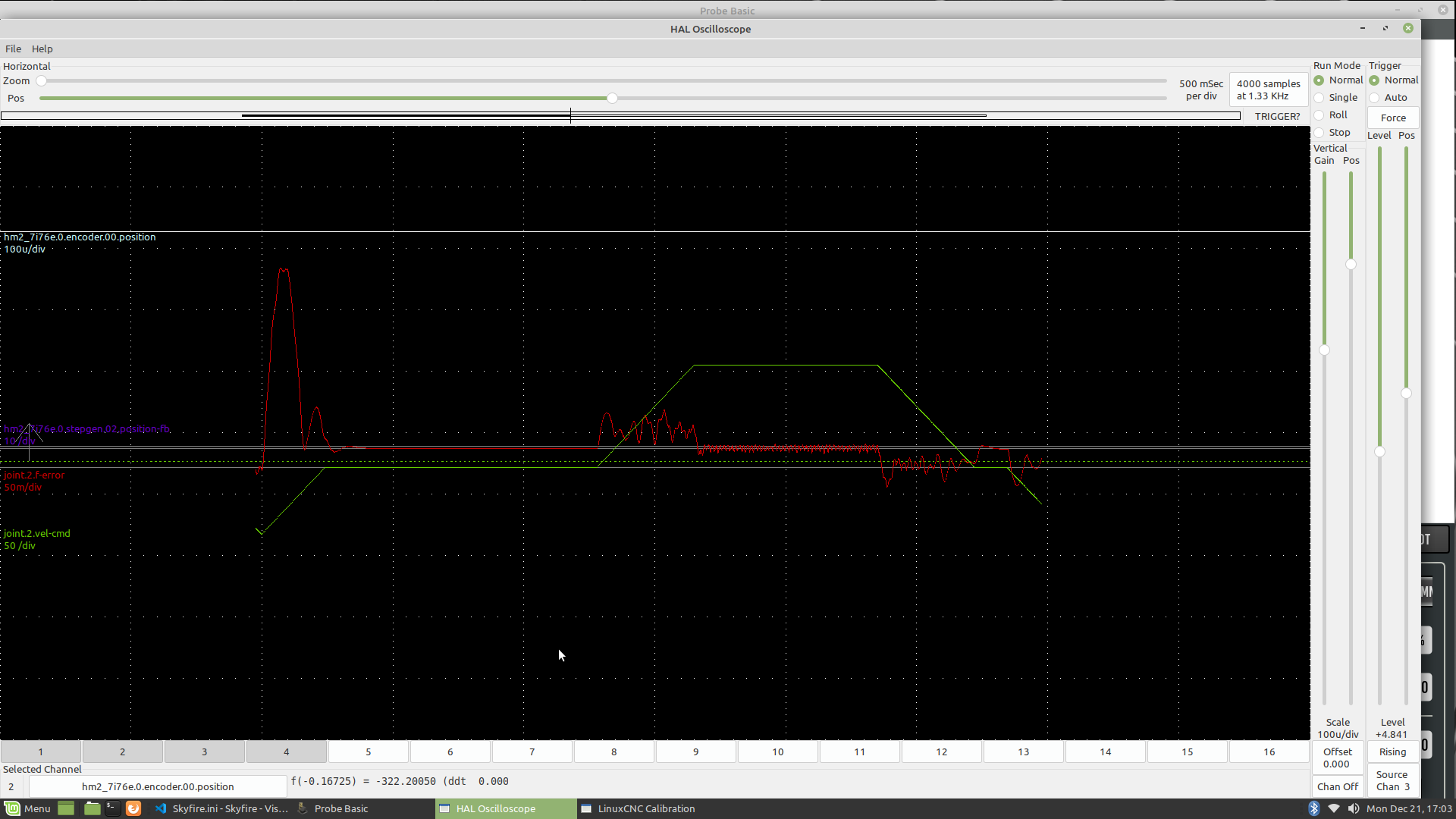

21 Dec 2020 23:31 - 21 Dec 2020 23:35 #192749
by jhandel

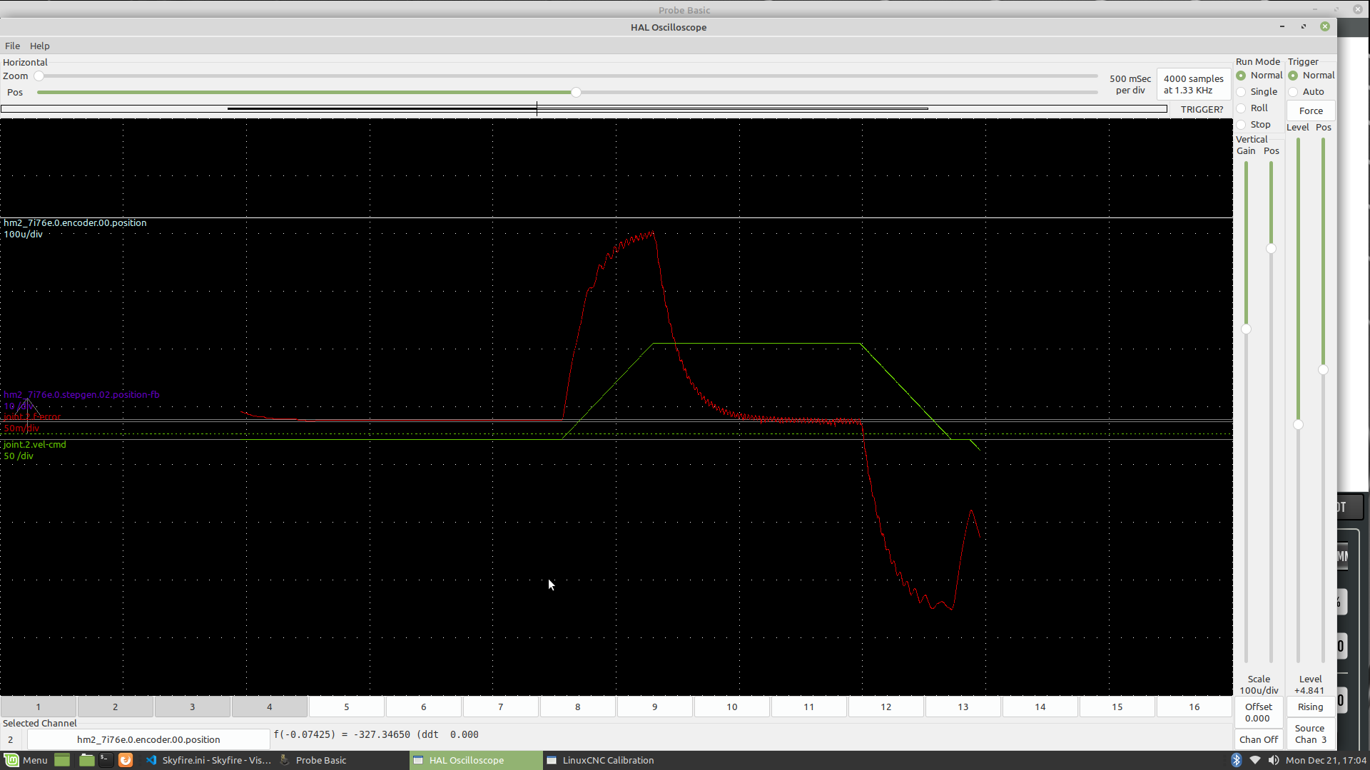

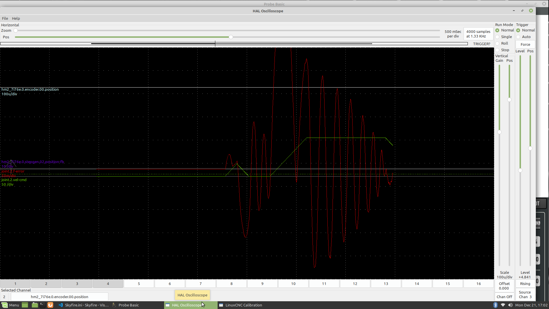

Replied by jhandel on topic Step/Dir servos + Encoders = follow errors... and so much pain.....
I set my ferror up to 100 and min_ferror up to 10 & my P was set to 150 with an accel of 225mm/s (old controller had an accel set to 600mm/s)... Jog speed was tested 50% of rapid (except the first one, that was 100% rapid). These are the results of jogging the z axis up and down.. (trigger was on a velocity up, so some time I bumped the velocity before giving it a go)...
I should note at a P of 160 I could cause oscillations.
(super close up)
Not sure what happened here but yah SUPER not happy during that jog lol..
For grins I ran at a P of 10..
(super close up)
Last edit: 21 Dec 2020 23:35 by jhandel.

21 Dec 2020 23:53 #192755
Replied by PCW on topic Step/Dir servos + Encoders = follow errors... and so much pain.....
To me it looks like the drive itself is not well tuned.
That is, even with P=0, the step frequency that LinuxCNC
generates is very close to correct due to FF1=1 and the
fact that the hardware stepgen frequency resolution and accuracy
are quite high.
P should basically just be used to correct for minor
time base differences and various rounding errors
What I am saying is that a P of 10 should be fine
if the drive accurately follows to the pulse train.
are quite high.

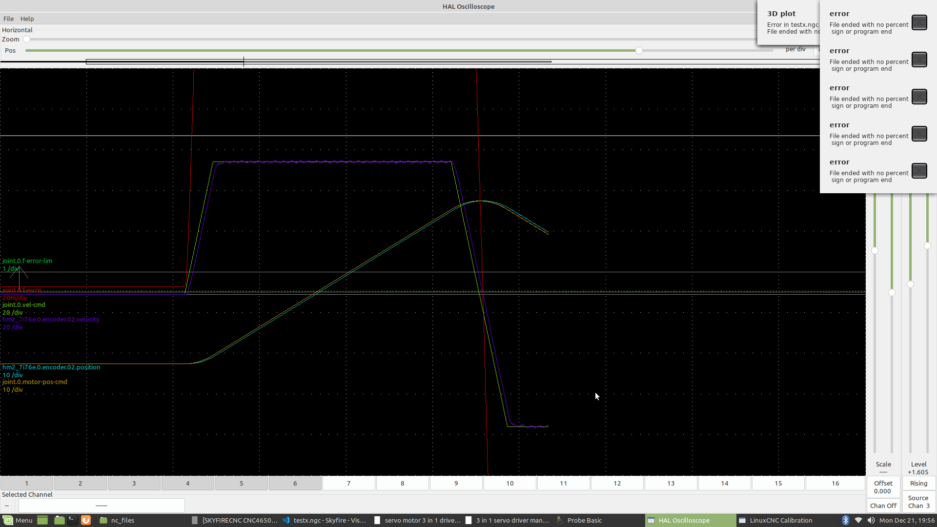

22 Dec 2020 02:19 - 22 Dec 2020 02:20 #192762
by jhandel
So you brought up a good point, and your description about how really this is about managing the time dilation between command and execution caused me to wonder about my controllers tuning... So I set P to 0, and there it is... The servo seems to be off by about 6ms (tested at 1ms thread speed and 750us thread speed and both came back at 6ms delay so I am guessing its not a clock thing between Mesa and computer and just a "cost of the operation" time)
So now I understand the intent of PID tuning is to "race" to make up for 6ms of delay between where the machine "things" things are, and where they actually are..
(Red is follow error, green is commanded velocity, purple is encoded velocity, orange is commanded pos, and blue is encoded pos.
This does beg the question.. is 6ms between command and feedback high, low, expected?
Last edit: 22 Dec 2020 02:20 by jhandel.
- Posts: 18071
- Thank you received: 5309
22 Dec 2020 03:11 #192769
The delay is an issue (and 6 ms is pretty high) do you have all filtering disabled
or minimized in the drive?
What is the time per division on the plot?
- jhandel
- Posts: 158
- Thank you received: 7
22 Dec 2020 03:36 #192771
by jhandel
That plot was run at 750us servo thread speed so it was 750us/plot..
I ran the same test with 1ms servo thread speed and got the same speed. (fewer steps but resulted in the same 6ms).
Is there anything in LinuxCNC, in the MESA card or in Linux in general that could account for that? I am guessing given its a "round trip" the actual time delay is 3ms..
I will dig through the servo driver manual.. But its a slog given its chinese & the closest thing I have to a translation is the manual run through google translate.
- Posts: 18071
22 Dec 2020 03:48 #192772
I mean what is the time/division of the halscope plot.
This is independent of the servo thread period
(though the servo thread period does determine the time resolution)
