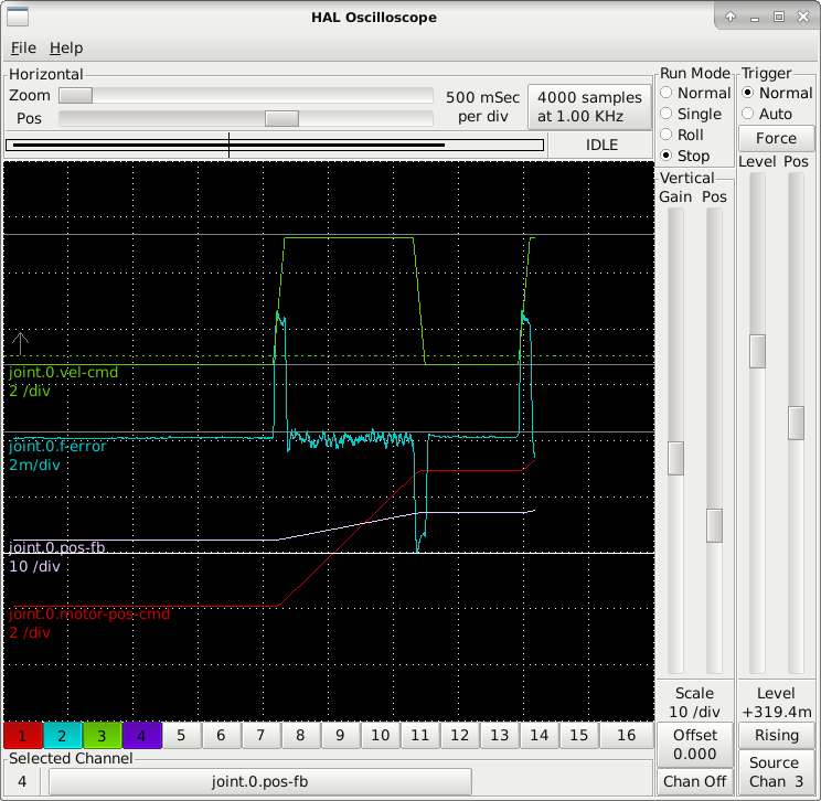

Playing around today with tuning my servos and made great progress once I turned the acceleration setting down significantly. With high settings I was seeing an Ferror spike at the beginning and end that could not be controlled with any PID setting. The servos are capable of "near instantaneous acceleration" and the manual has an equation for the allowable acceleration but the reality is that friction and weight resistance won't allow that.
Is there a way to use Halscope or something to help figure out the Max Acceleration setting for servos in velocity mode? Also is there a way to make changes to the ini file while LCNC is running? So far messing with acceleration settings is done by closing LCNC, adjust ini, reopen LCNC, halscope, calibration, etc.

Replied by PCW on topic Setting Servo Max Acceleration
You can change ini values on the fly (not during motion but when paused)
by changing the ini.xxx pins with halcmd.
(in a terminal windows with linuxCNC running)
for example
halcmd -fk
--To list available pins:
halcmd: show pin ini*
--and then to tweak values:
halcmd setp ini.y.max_acceleration 400

Replied by Todd Zuercher on topic Setting Servo Max Acceleration
As to calculating the max acceleration. You can plot the velocity feedback in Halscope when the acceleration is set too high, the slope of that will be the physical max. But you will want to program the max acceleration limit in the ini file to something less to give the PID headroom to work. Something like 10% less is a good start.

I am back at playing with this but not sure I understand this point. I am looking at vel-cmd and f-error and poss-fb in halscope. Not sure if this is what you are referring to with "velocity feedback". Vel-cmd is a pretty straight up and down plateau with f-error in between the plateau. The rest are just slopes that aren't much good. The f-error start and stop still have a big spike that isn't much affected by FF2.
Any further advice would be appreciated.
