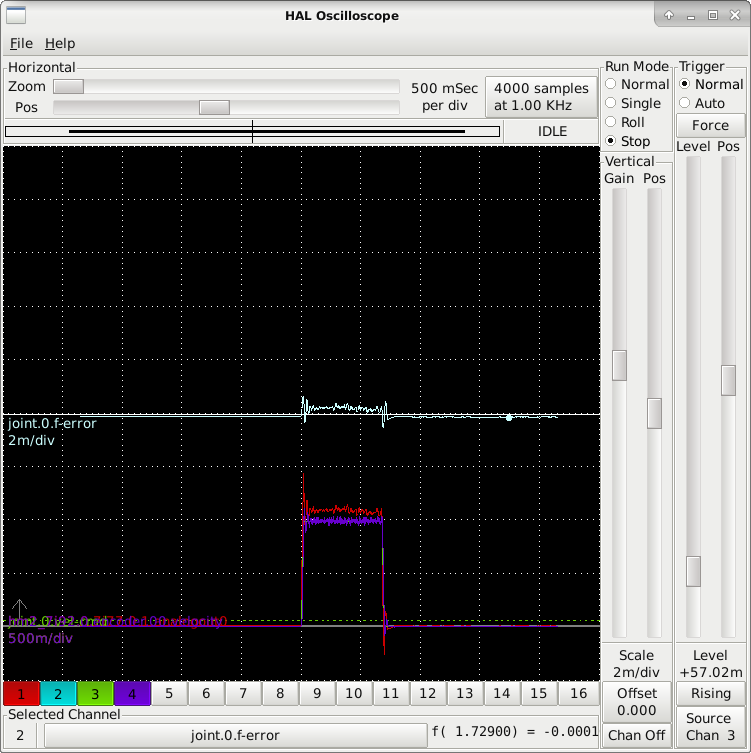

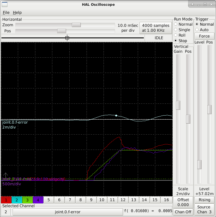

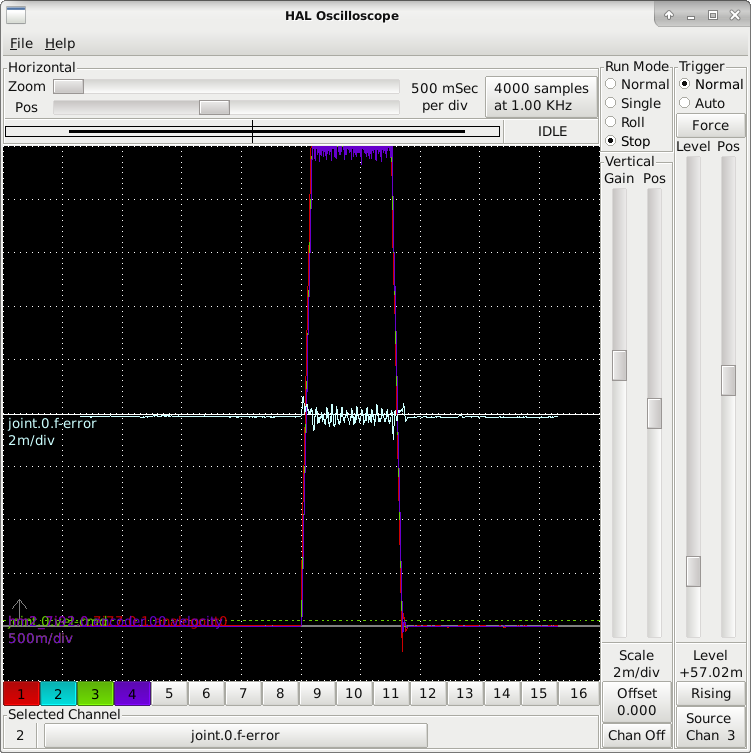

25 Jan 2021 17:19 #196538
by Michael
Replied by Michael on topic Setting Servo Max Acceleration
The analog output vs vel cmd seem to be fine and near instantaneous to me. That just leaves the wiring to the drive and the drive itself as sources of problems. 7i77 to drive wiring is only 2ft. I honestly think this delay is a source of tuning issues. As I get to a tune at higher and higher speeds my low speed tuning seems farther off. I can bring the f error spikes down to be consistent throughout the move at speed but going back to a lower speed introduces a under/overshoot that is worse then at high speed.
This is analog out vs vel cmd:
THis is the same tune with two different speeds, can't seem to find a middle ground.
P300 FF1 1.04 FF2 .0065 at 270 IPM
P300 FF1 1.04 FF2 .0065 at 60 IPM
25 Jan 2021 18:23 #196544
This is not uncommon. I created the "lincurve" HAL component specifically for this purpose, so that the PID controller gains could be set up to vary with speed (or with temperature, error, etc)
In my day job I am in charge of tuning a system where P, I and D gains are each derived from a temperature / total error map, and there is a map for each of the 12 gears.
Replied by andypugh on topic Setting Servo Max Acceleration

25 Jan 2021 21:35 #196563
by Michael
I would have no problem going that route but would like for one of the two issues (delayed response, over current at speed) I have to be solved before I go any further with these motors.
Some other thoughts that come to mind. The issue could be a delay in the drive sending out an encoder count. From what I read a lot of these servo's are not a direct pass through on the encoder. The delayed encoder counts would create a similar response. I don't have to use the drives encoder to Linuxcnc, I could use a glass or magnetic scale on each axis, would have a few extra benefits as well. Just some thoughts, I think by the time I added those in I would be near the cost of more name brand servo products, which is another option.
Double checking the drives current monitor vs the halscope shows that the delayed response is causing an increased velocity command to get the motor up to acceleration parameters, accelerating faster than it can handle.
You might be able to dial the current back by limiting the PID.
