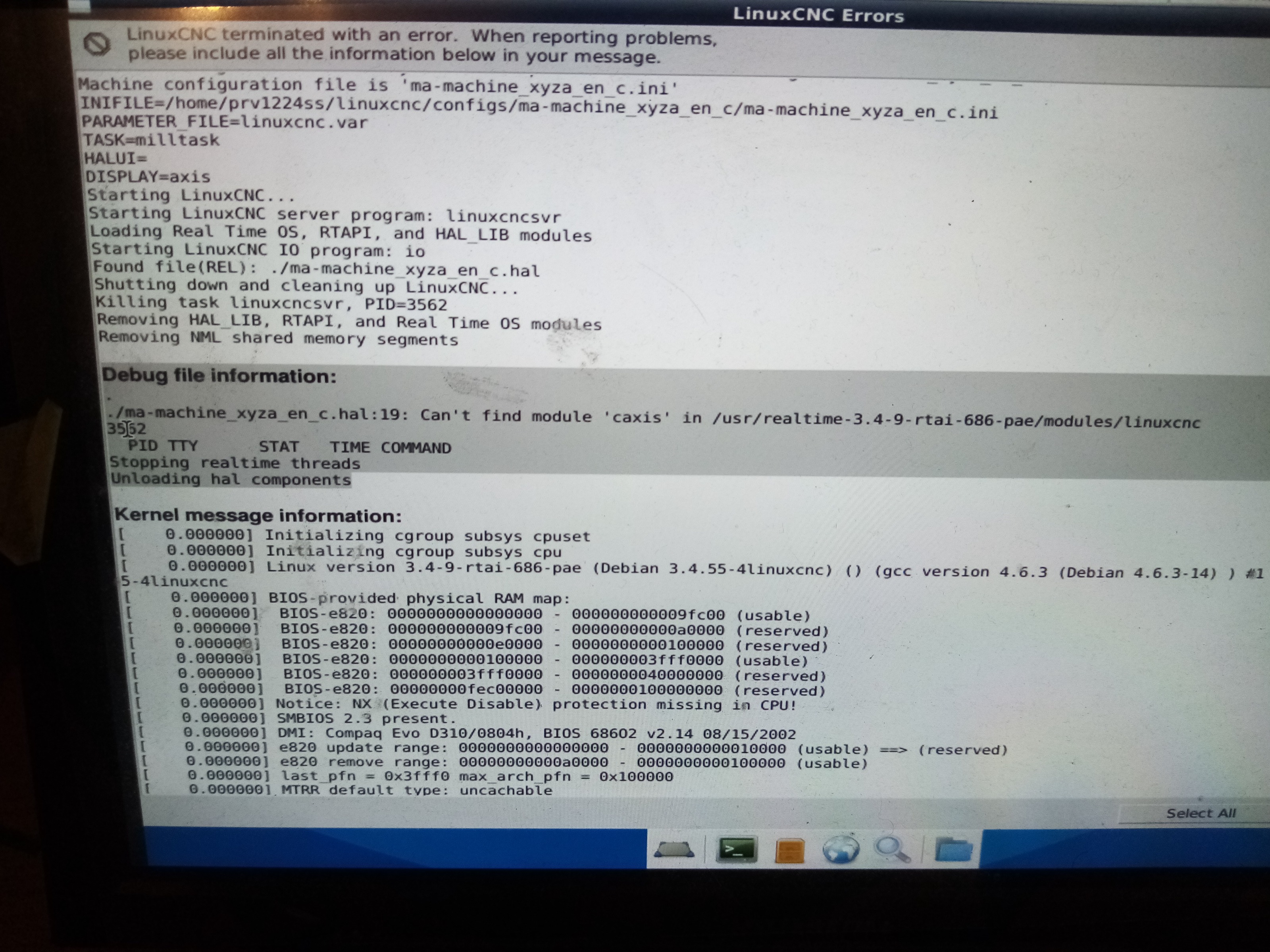

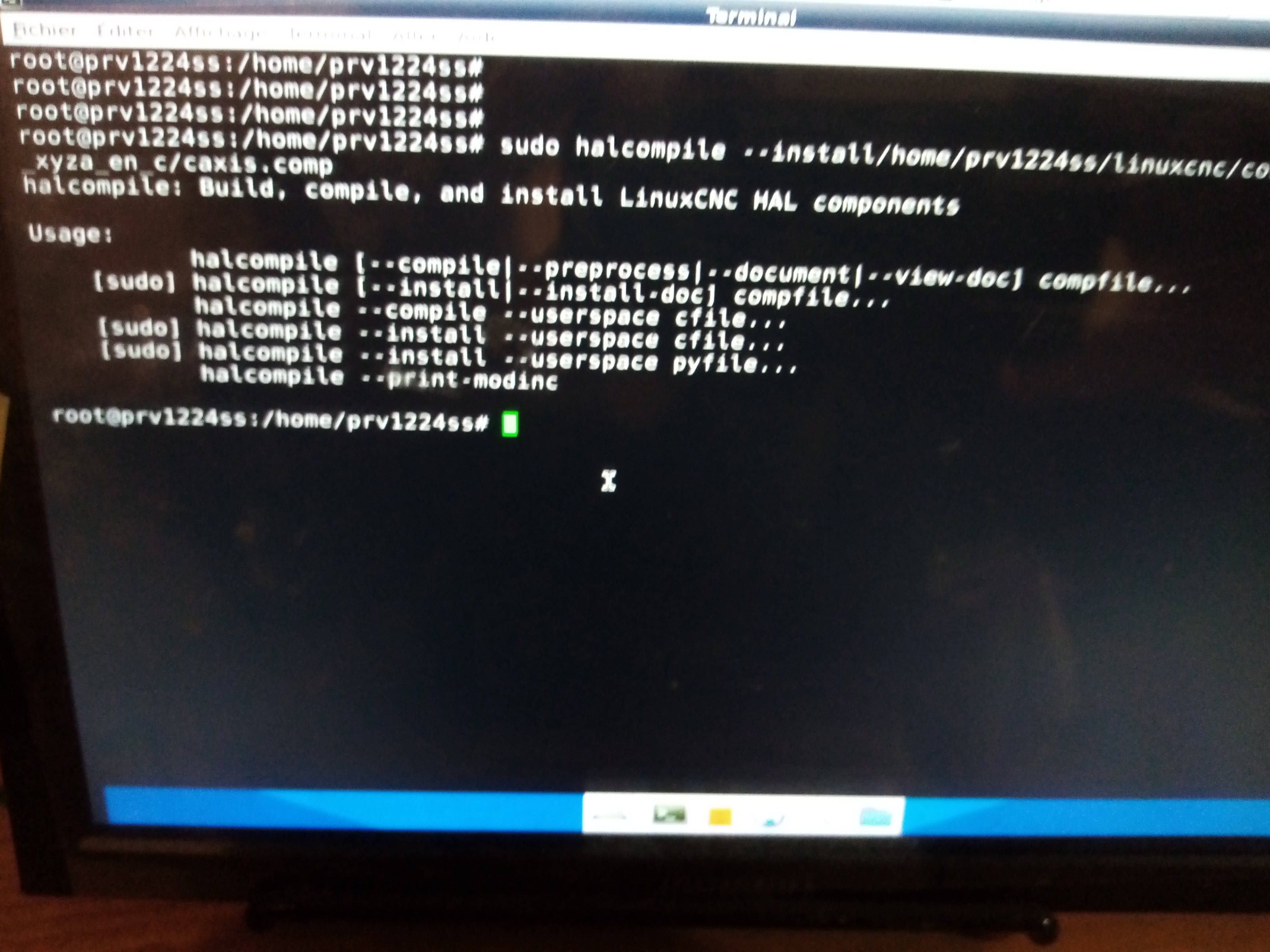

18 Nov 2021 20:19 - 18 Nov 2021 20:28 #226915 by jpg
Good evening to all, here is my problem:at the moment, I'm trying to configure an axis c for my lathe (for the moment chinese card; port //, then 5.25-7.76), the worry is that I can not install the component "axis c" of Andy (see photos)yet the component is installed,?, I use version 2 7.14 of linux (this is not a problem?) I confess that I am looking for a while. thank you in advanceĀ
