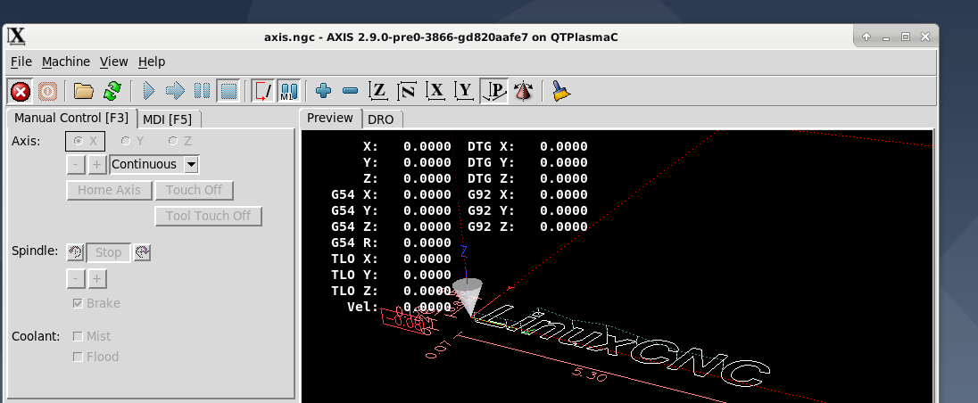

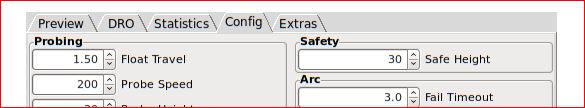

Hi Phil
Thanks for the reply it was shown in this tutorial video
And in the section called "Run Panel" in this guide.
linuxcnc.org/docs/devel/html/plasma/plasmac-user-guide.html
Have a lot of experience with other software on Plasma cnc tables, I have built 9 table and this is the 10th controller for a new table I am building. I have no local help so all comes from YouTube videos and 2 other Linux users. There is a great amount of info, but so much seems to outdated and confusing. I have QTPlasmaC loaded and close to be operational, but I am still lacking things.
It seems there is addon software for the THC and Ohmic sensor but I cannot find the info. I assume will be included in the INI file.
As you can see I need help.

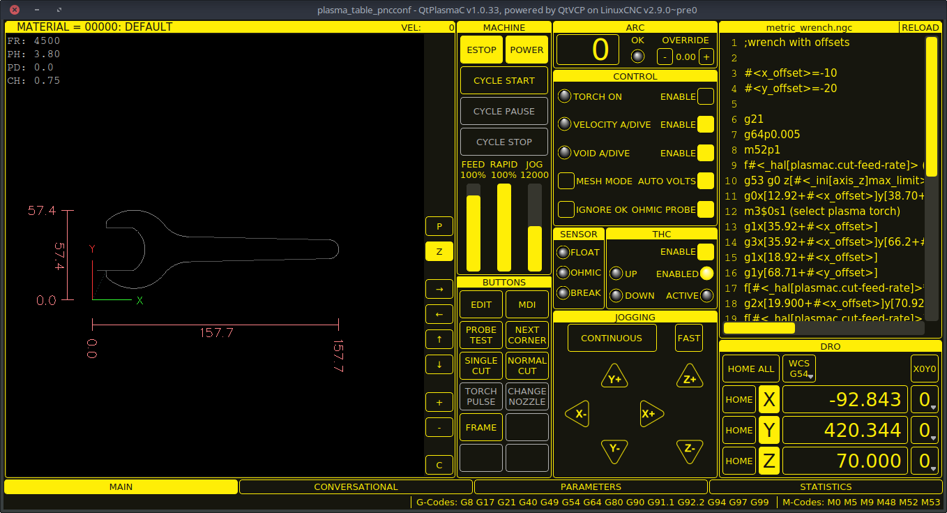

PlasmaC has been superseded by QTPlasmaC.
The original PlasmaC was a plasma (c)omponent that handled plasma specific operations behind the scenes. This component was loaded into your choice of a GUI frontend.
The new QTPlasmaC combines the old plasma behind the scenes component with a new GUI designed specifically for running plasma tables. It looks like what Phill posted in post #2.
The screens you've shown in your posts are of the Axis GUI, not the new QTPlasmaC GUI.
QTPlasmaC is available in linuxcnc 2.9 which you've mentioned you already installed. if you run PNCconf when get to the Screen section of the wizard you can select QTPlasmaC from the combobox in the top left of the window.
Be sure to give the user guide that bevin's linked a read. linuxcnc.org/docs/devel/html/plasma/qtplasmac.html
