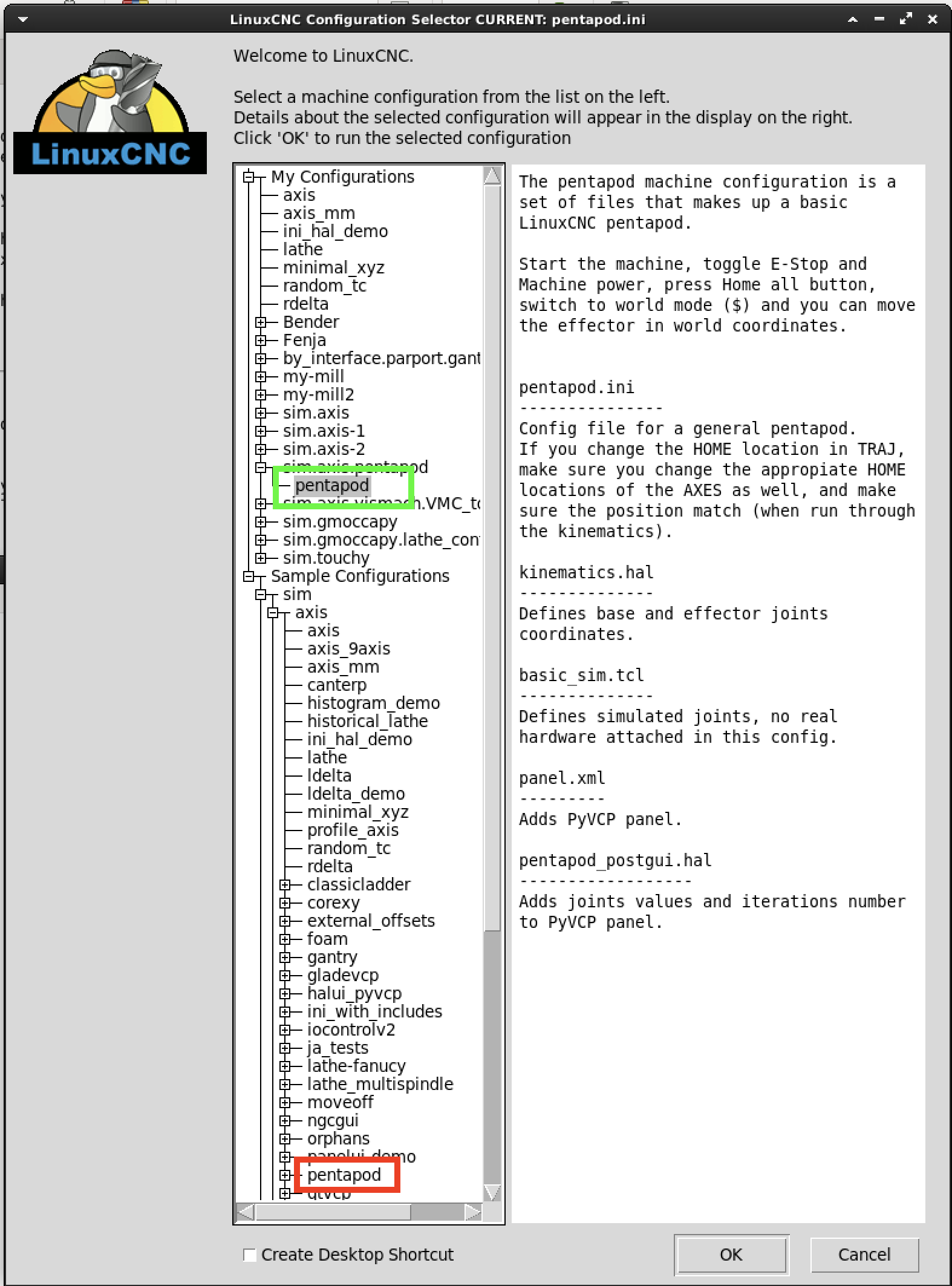

It sounds like you might be re-opening the Sample Configs -> sim -> axis -> Pentapod configuration.
The first time you open a sample config it is copied into your home directory into ~/linuxcnc/configs.
You can access that from the config picker by expanding the "My configs" section:
Replied by andypugh on topic Pentapod configuration
The part where I am stuck is that in which files should I put my port addresses and the pin layout?
LinuxCNC seems to ignore what I write in 'pentapod_cmds.hal', and when closing the program it reverts the file to its initial state.

If you open a config from the "Sample Configs" then a copy is made in your home linuxcnc directory.
If you open the same sample config gain, it creates another copy of the sample config. You can see this in my screenshot as I have sim,axis, sim.axis-1, sim,axis-2 and so on.
Any changes you make in the files in your home directory should not be over-written unless you re-run one of the config wizards.
