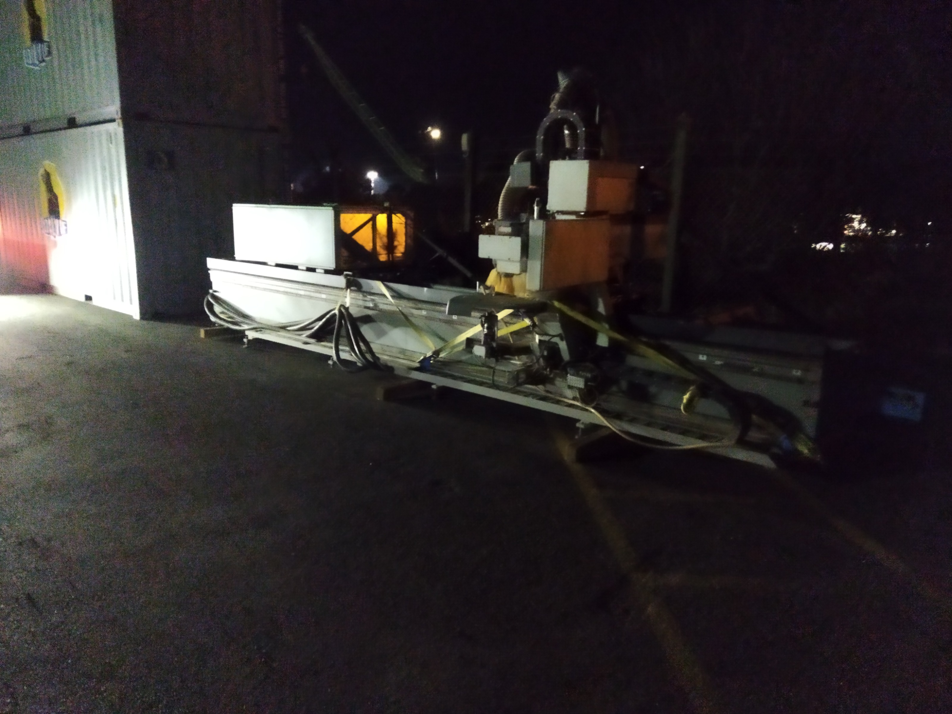

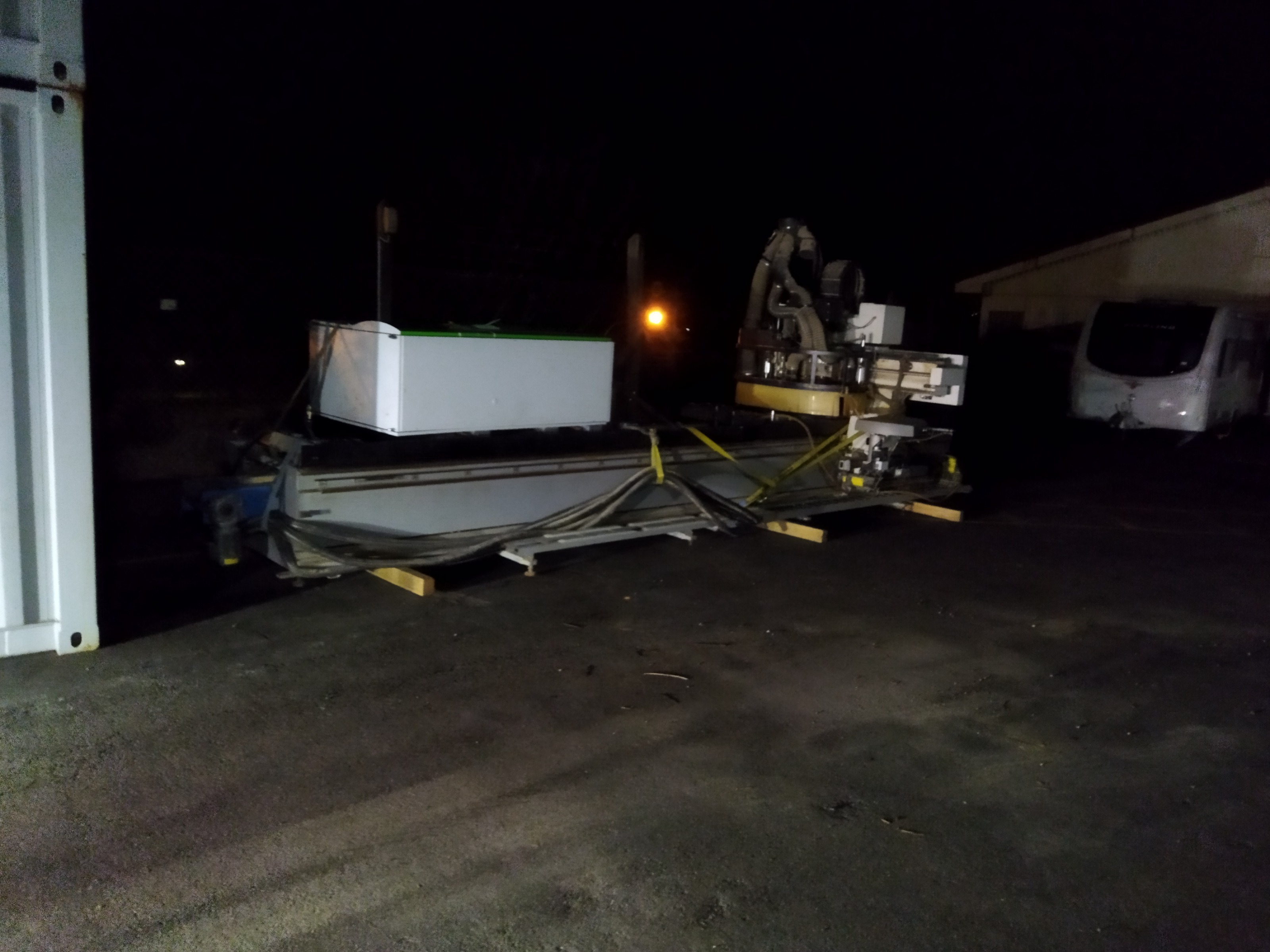

I got a 6.2 metre travel cnc router I would like to turn into a 5 axis machine and glad to see the kinematics is getting some work
- Posts: 4818
- Thank you received: 2176
14 Jul 2021 06:13 - 14 Jul 2021 06:16 #214678
Replied by Aciera on topic Switchable kinematics (switchkins) examples
Is that a Biesse?
[edit]
Does is already have a B-axis spindle?
[edit]
Last edit: 14 Jul 2021 06:16 by Aciera.

Its a biesse 24xt machine made in 2002
And currently has like 10 spindles I'll strip out.

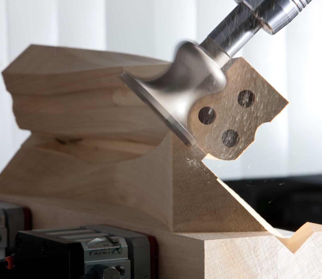

Is it a motorized b axis or indexed? If it can hold a mill bit you can do all kinds of handy stuff with it.
- Becksvill
- Posts: 224
- Thank you received: 115
18 Aug 2021 09:23 #218056
by Becksvill
Replied by Becksvill on topic Switchable kinematics (switchkins) examples
its motorised
it has a 400w yaskawa servo drive on it to rotate it. what kind of attachments do they normally run?
i am having trouble working out how it was supposed to be used
