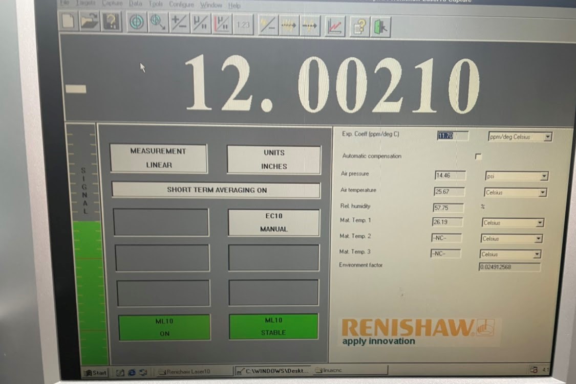

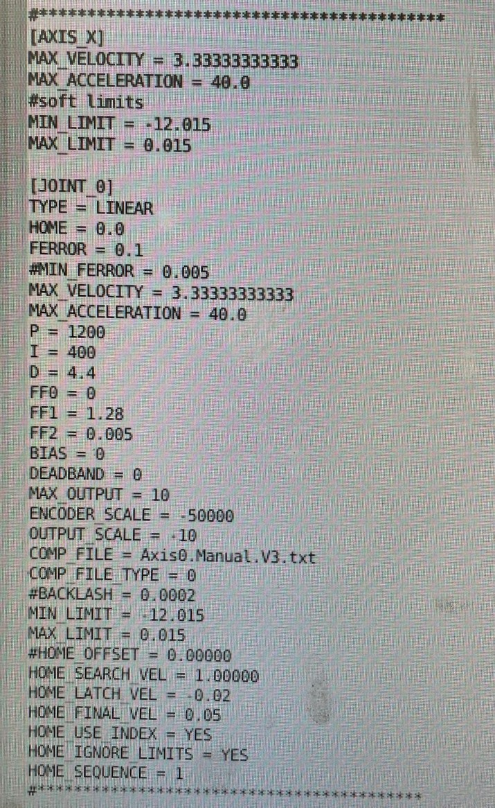

So I'm trying to laser calibrate out the error on my ballscrew and I'm not having much luck. One of the quirks of my setup is I'm trying to maintain backward compatibility with the old control so my machine can run the same programs with little to no changes.
The machine's X/Y/Z are homed to the positive limit and all axis move in the negative direction from home. I can't put negative values in the first value of the octet or LinuxCNC gives me errors. So I tried moving the machine from home/limit+ to limit- and vice versa. The change in values after compensation are almost nothing. Like on the last value where the error is .00194" I get a change of maybe .0002". The results are repeatable over multiple runs both comped and not.
I'm trying to at least match the OEM controller that could get the machine within .0002" across 12".
Any help would be greatly appreciated. I'm running 2.8.1 of LinuxCNC

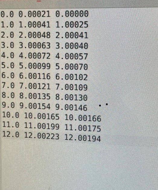

joint 0: compensation values must increase (X)
It created an error for each entry. Which was crazy when I had 118 entries.
Octets were
target out back
0.0 0.000 0.0002
-1.0 -1.003 -1.005
-2.0 etc.....
As soon as I made them positive LinuxCNC didn't complain.
Octets were
target out back
0.0 0.000 0.0002
-1.0 -1.003 -1.005
-2.0 etc.....

Ah, that is actually reasonable, as the system needs to search through them to find where it is.
But you need to start at the most-negative value and increase. So negative is OK, but the numbers need to increase monotonically.
ie:
-100 ...
-99 ...
-98 ...
Replied by andypugh on topic Ballscrew Mapping to Having an Effect
ie:
-100 ...
-99 ...
-98 ...
