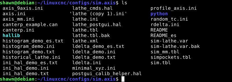

please archive all your config files and post them here.

The config files are all the same as standard upload of AXIS 2.8.2.11 lathe display. The only additional file is python and extra script at lathe.ini as foregoing.
