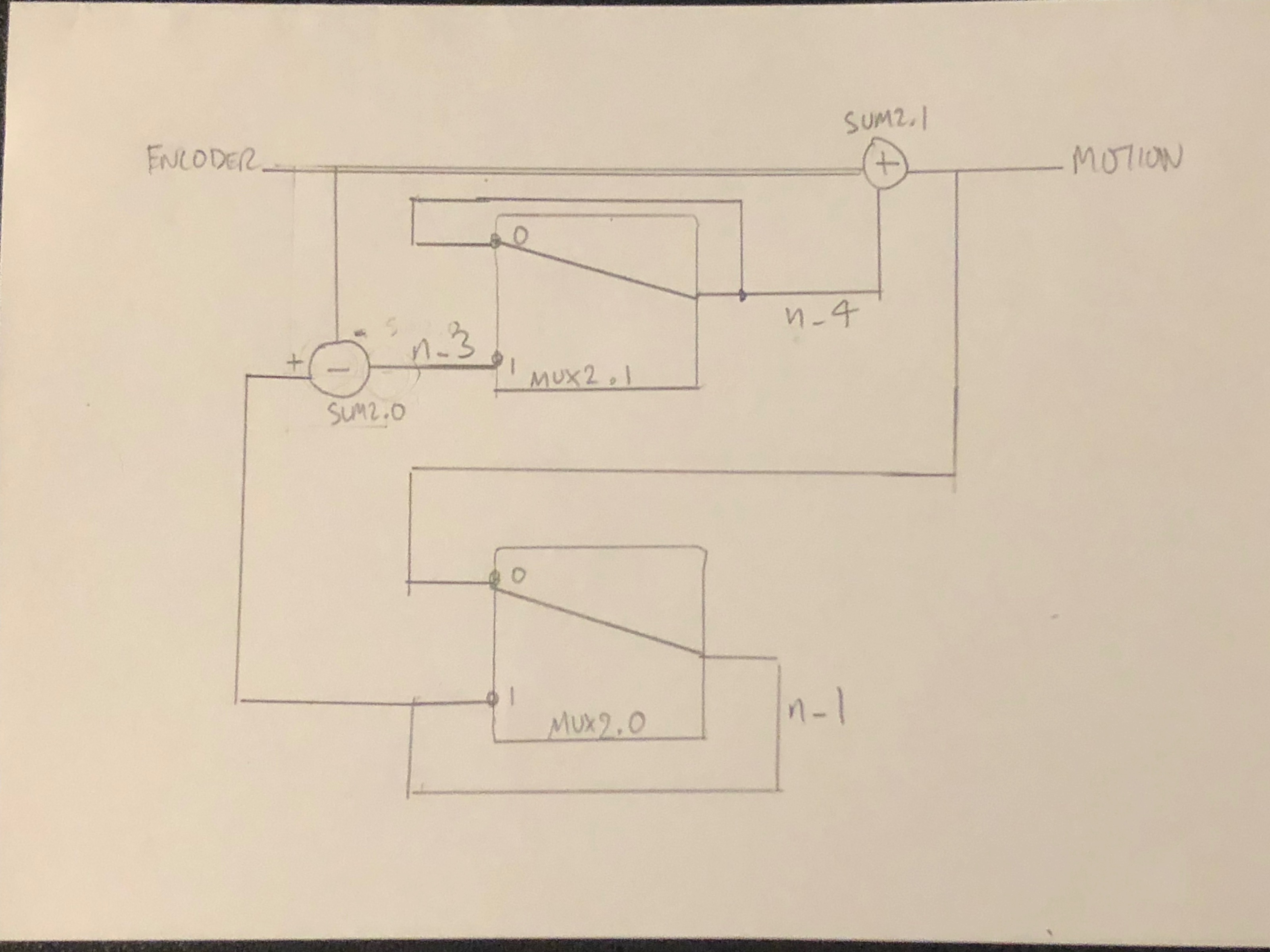

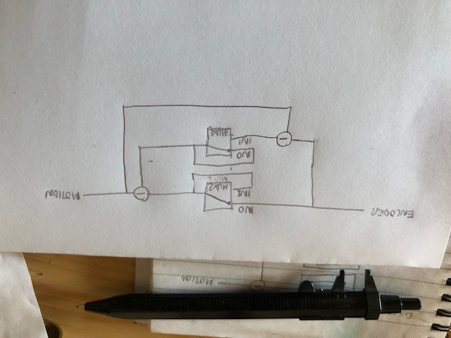

I think that I would do this with a custom HAL component that holds the X encoder position when triggered.
But I think it can probably be done with standard components, just not as neatly.
You need to accumulate an offset in a HAL signal and then subtract that from the encoder position number before passing it to motion.
(Note that subtraction in HAL is done by using the sum2 component with a negative gain on one input)
The built-in sample-hold component in HAL only works with integers, and this will need to work with floating point numbers. The workaround is to use the mux2 component looped back to itself.
I think that this structure of 2 x mux2 and 2 x sum2 will do what is needed, but my only "testing" has been looking at the picture and imagining the numbers on the pins

Thanks for response. That is brilliant idea but when i change mux2.0.sel =1 and mux2.1.sel=1 it seems to go in endless loop. (endless counting). Am i doing it in the right way?
#load mux2
loadrt mux2 count=2
addf mux2.0 servo-thread
addf mux2.1 servo-thread
#load sum2
loadrt sum2 count=2
addf sum2.0 servo-thread
addf sum2.1 servo-thread
setp sum2.0.gain0 -1
setp mux2.1.in1 0
setp mux2.0.sel FALSE
setp mux2.1.sel FALSE
net n_1 hm2_[HOSTMOT2](BOARD).0.encoder.00.position => sum2.0.in0 => mux2.0.in0
net motor.00.pos-fb mux2.0.out => sum2.1.in0 => mux2.0.in1
net n_2 sum2.1.out => sum2.0.in1 => pid.0.feedback => joint.0.motor-pos-fb #push copy back to Axis GUI
net n_3 sum2.0.out => mux2.1.in1
net n_4 mux2.1.out => mux2.1.in0 => sum2.1.in1

I did admit that I hadn't tested it.
After some trial and error, this seems to work. It is a standalone config that you can try with "halrun -I test.hal" if you save it as test.hal. Then you can "sets encoder 100" to change encoder counts and "sets hold 1" to set the hold input.
