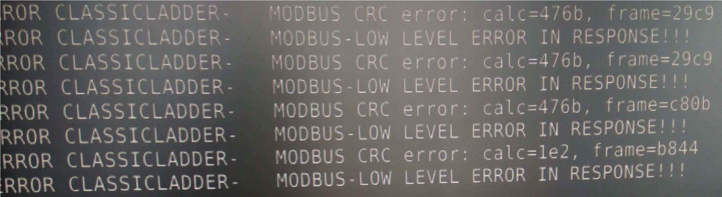

In fact, you were right the terminal shows what the errors are. however, this entry tells me nothing.
ERROR CLASSICLADDER- MODBUS CRC error: calc = frame =
MODBUS-LOW LEVEL ERROR IN RESPONSE
maybe I should make a new thread directly about bugs of this type?
I will add that I checked 3 USB-RS485 and RS232-to 485 converters, I added terminators and then the same
the inverter is idle during a fault
Replied by Adam Maszynotwór on topic does mb2hal need to be updated? - linuxcnc 2.7.14

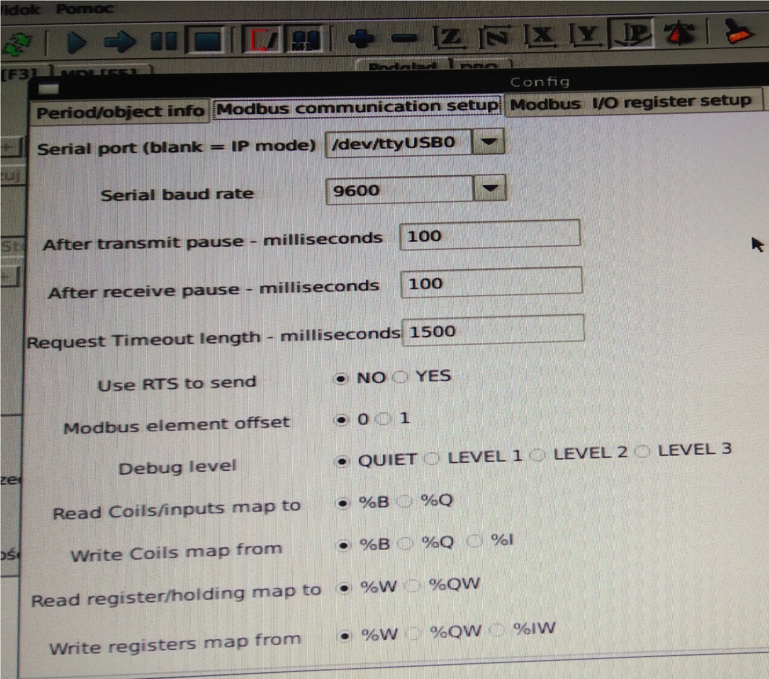

I would double check your modbus configuration settings in your drive and make sure that they all match the settings you have configured in Classicladder. Some Ideas of things to check from googling CRC errors in RS485.
CRC errors:
Check baud rate and character format.
Check wiring – if everything else is correct, CRC errors mean noise on the line.
Check for reversed polarity on RS485 lines. Reversed polarity often looks like just noise.
Check to see that Pre-Delay is at least 50 mS.

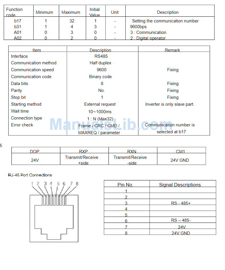

21 Dec 2021 18:36 #229642
by Adam Maszynotwór
The inverter is N700E - Hyundai Electric
here the manual www.manualslib.com/manual/801675/Hyundai-N700e.html?page=108
I have 2 identical and both have the same problem
I was guessing there might be interference, but even on a short line (300mm) the same thing happens.
I was adding a 120ohm terminator
I checked such converters
www.gotronik.pl/konwerter-usb-rs485-p-1562.html
www.gotronik.pl/yn-485i-konwerter-z-usb-...izolacja-p-2894.html
sklep.delta.poznan.pl/konwerter-rs-485rs232_l1_p3259.html
I changed cables and plugs
I changed times - long times only extend communication / reactions but they will still be
I did other tests with the relay board and the arduino .. they did not report any errors.
I would prefer to completely disable this bug reporting - despite the bugs it works great so I don't want to know about these minor bugs
I wanted to use MB2HAL hoping it might do the trick, but I have to learn it

21 Dec 2021 19:04 #229644
Replied by Todd Zuercher on topic does mb2hal need to be updated? - linuxcnc 2.7.14
This is sounding a lot like the problem I was having. It could be something as simple as Classicladder it trying to write something to a register that the drive simply doesn't like or even trying to read something that isn't readable. For me it was writing zero speed to the drive. It was very frustrating because I had no idea what the problem was and nothing directly said, but everything still worked normally, I would just get a pile of errors when the drives were stopped.
