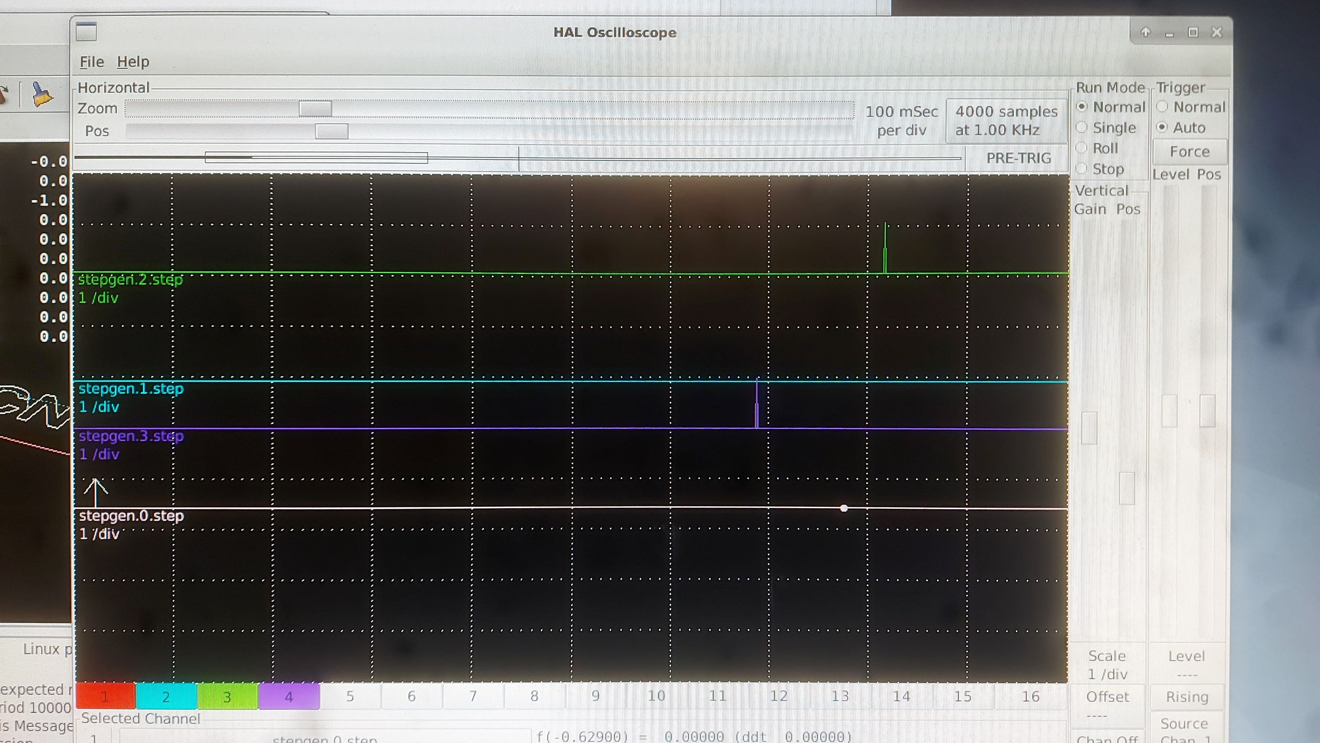

I'm having problems with a pentapod configuration.
I prepared the basic configuration settings with the config selector/pentapod. In the HAL I configured the threads, ports, and connected the signals from the functions to the right pins in the ports. I used the same stepper and port settings as in my trivial config, which is working ok.
The problem is that the actual steppers are barely moving, they are just making weird noises. I checked the pulse signals, they are looking very odd (I see only single pulses with very large gaps in between, on all 5 steppers).
I would appreciate some expert advice how to correct my HAL settings.

18 Jan 2022 22:59 #232352
Replied by andypugh on topic Pentapod configuration
Steplen and stepspace seem very short. Did your previous config use the "reset" function?
Section 7: linuxcnc.org/docs/2.8/html/hal/parallel-...ml#_using_doublestep
The units of steplen and stepspace are nanoseconds, 1 is very short.
linuxcnc.org/docs/2.8/html/man/man9/stepgen.9.html

The prevoius config was set up with stepconfig, and it didn't add the reset.
I added it now as the link suggests, but it doesn't seem to help.
I also tried to use longer step and space lengths, but unfortunately there is no improvement.
It appears that at each motor rotation direction change the steppers move a single step, then they stop. Maybe there is a problem with the way the pins and signals are connected, but I can't find it.

That sounds very much like step and dir are reversed somewhere.

I inverted the steps at the parallel ports. I also changed the scales in the ini. These make the signals look much healthier, but from the motors I still get weird noises and tiny movements only.
26 Jan 2022 16:25 #233192
What I meant was that the step and dir pins might be swapped. So every time you change direction you get one step, and every time you try to make a step you change direction.
