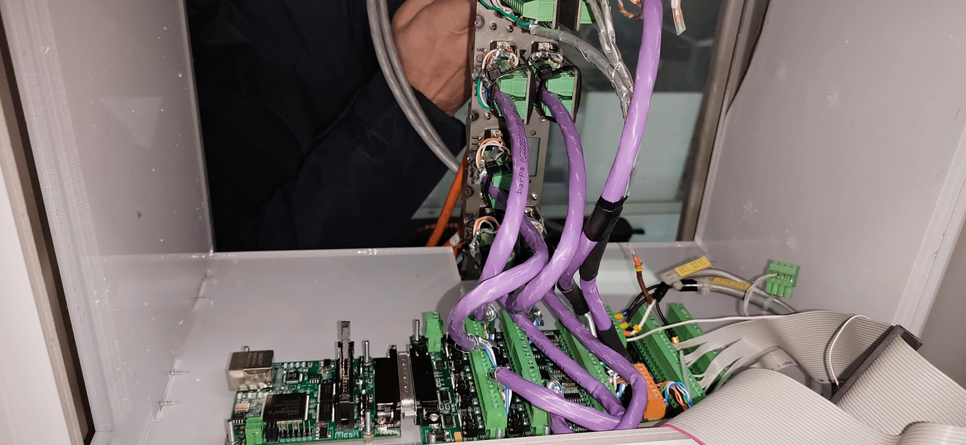

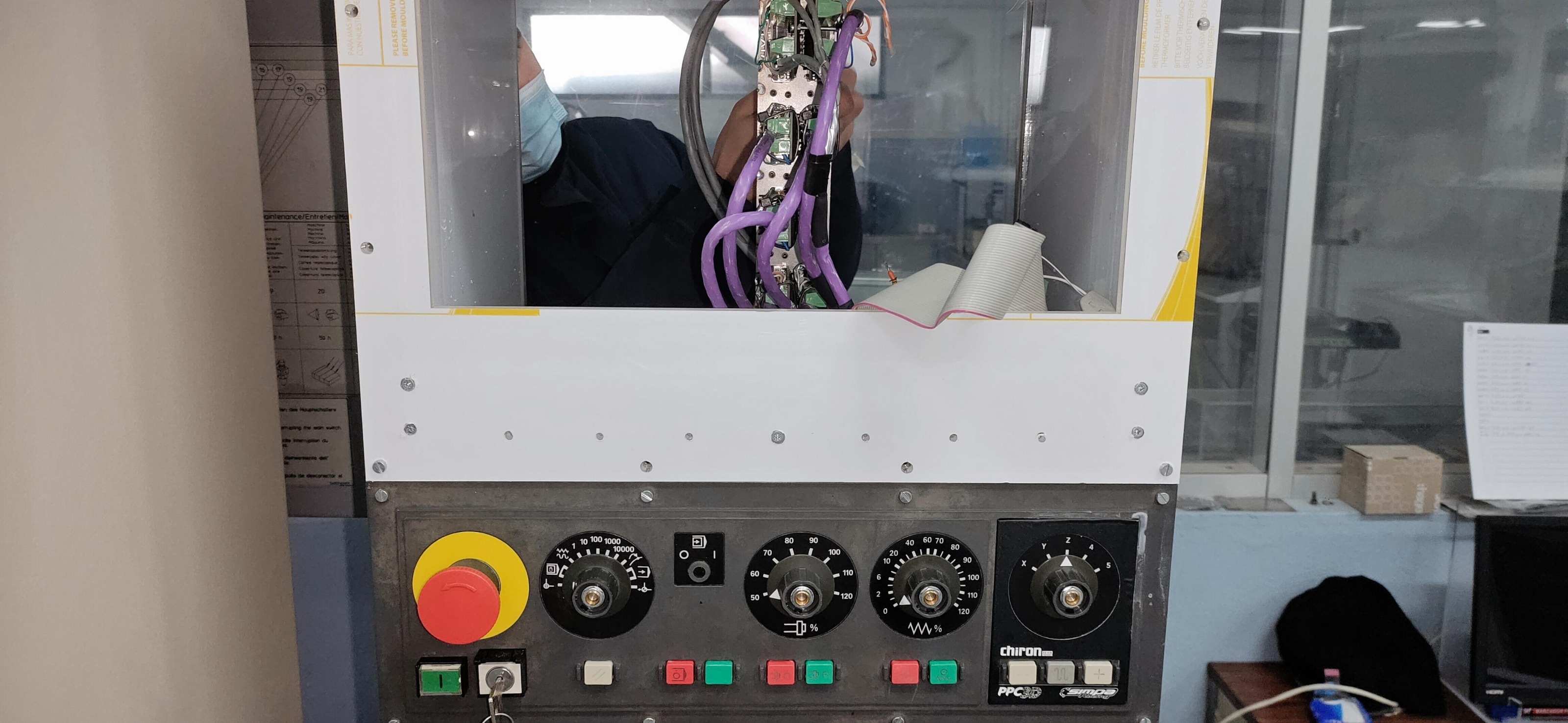

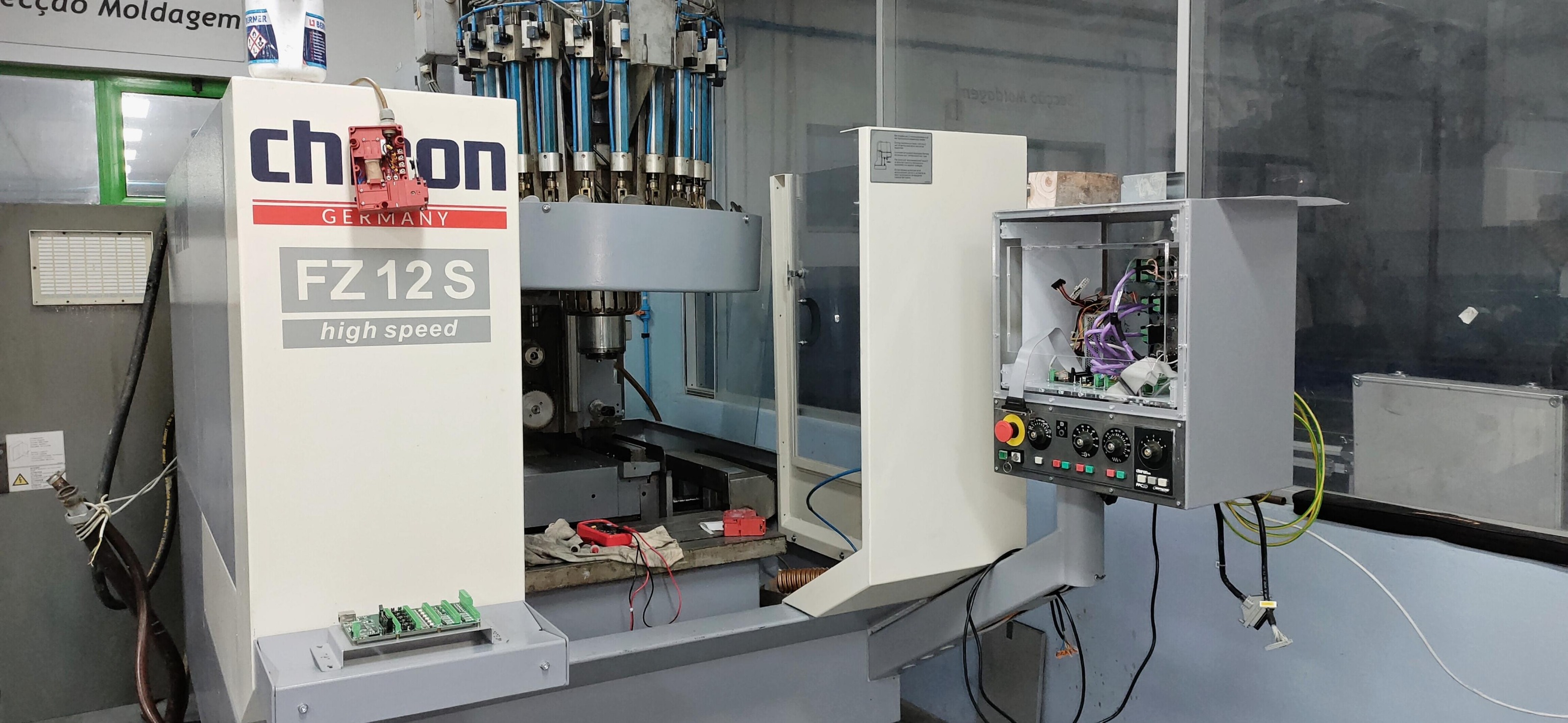

Hey guys,
First ever post here and first ever linuxcnc retrofit.

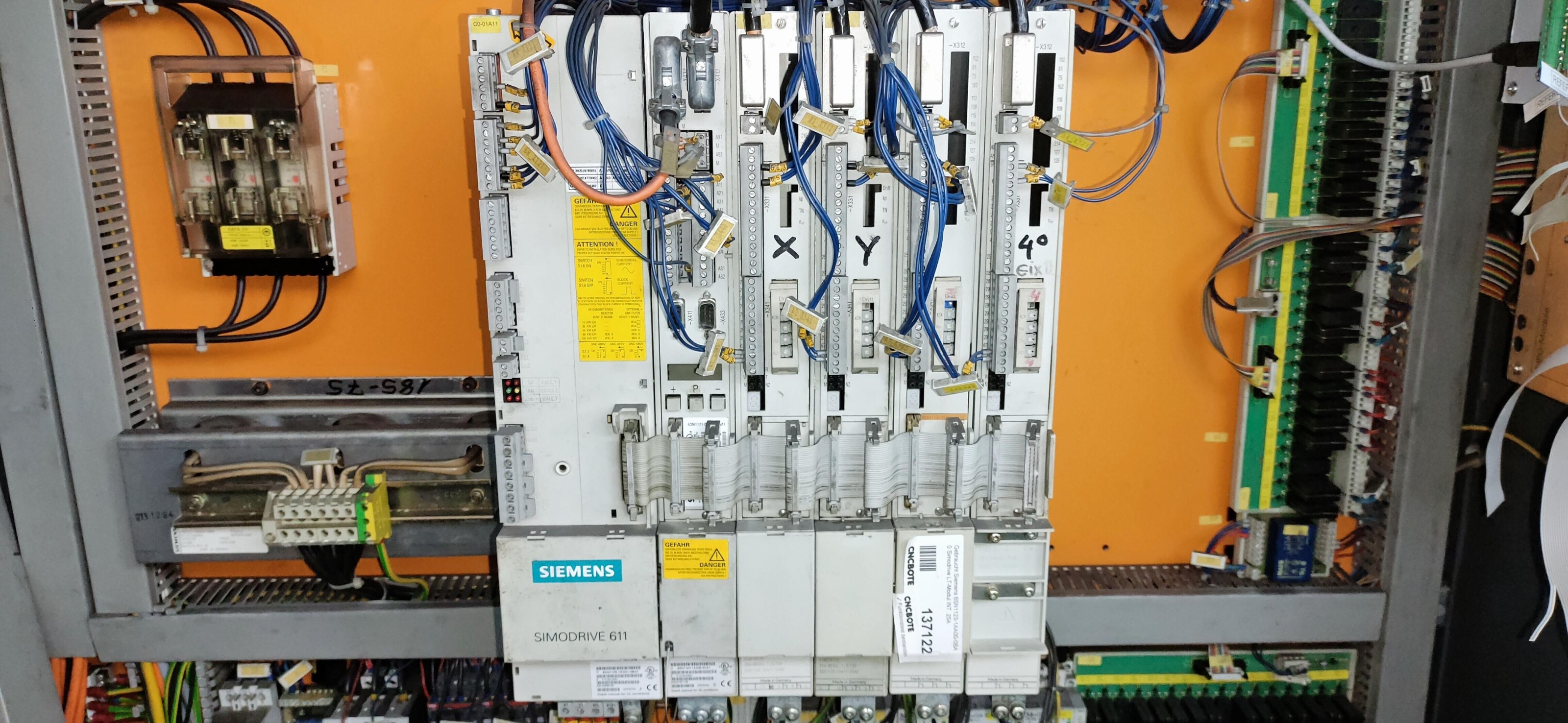

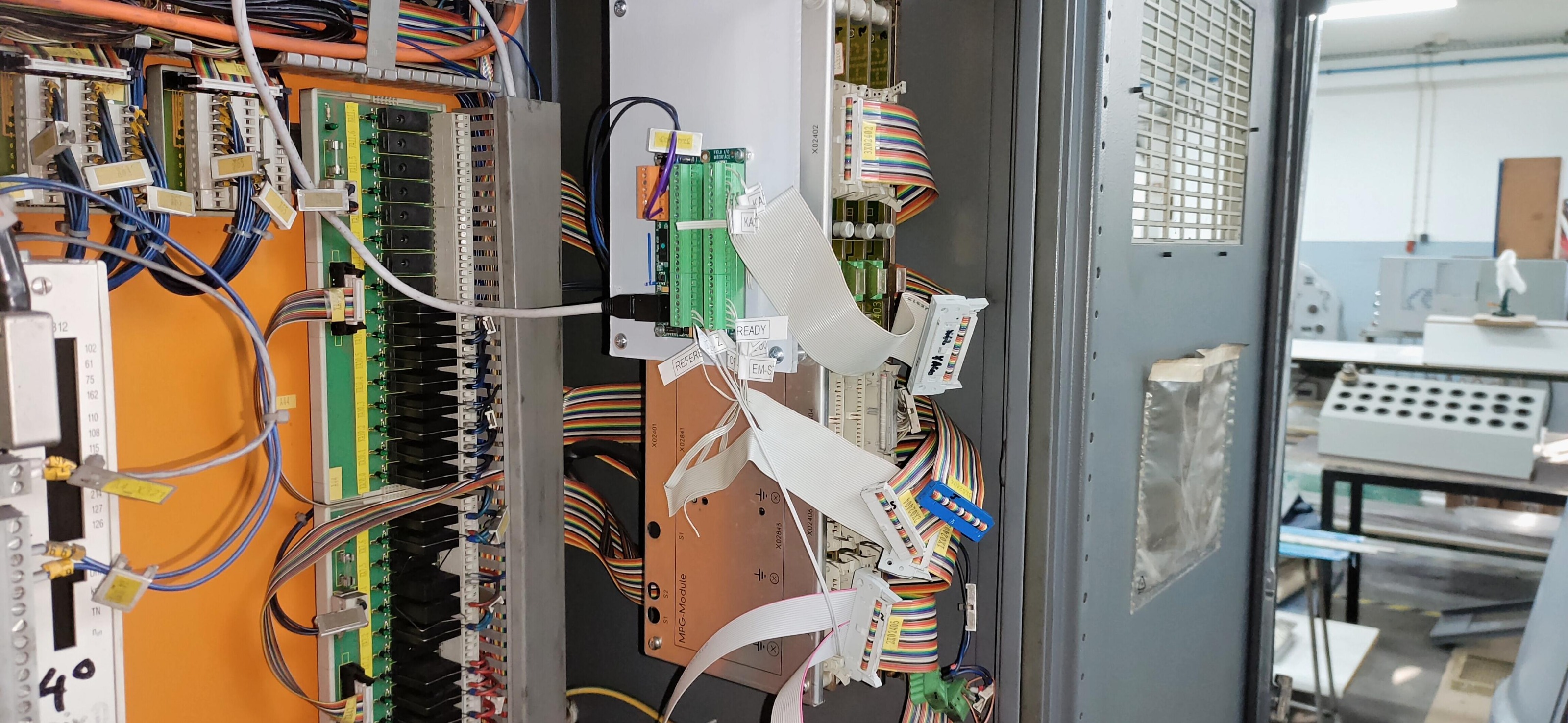

Just got a Chiron FZ12S Rapid CNC machine with a Siemens Sinumeric 810M controller and Siemens Simodrive 611 for all axis and spindle.
Sinumerik 810M is dead.
Started converting to Linuxcnc, got a Mesa 7i92 + 7i77 + 7i74 + 7i70 + 7i71.
Got the basics running. Home switches, XYZ motors running fine, drive enables, a few inputs conected and a few outputs conected (to allow for proper drive and machine start, it requires a complex sequence of relays and input feedback for the safety relays to activate)
Now i am facing the first issue. Basically i got the encoder feedback from the spindle going to the spindle drive and then to mesa 7i77 encoder 5 input.
I comand M3 S200 --> spindle rotates in right direction and at 200 rpm.
I then comand S1000 --> spindle drives jumps to 1000 rpm
If i comand M4 --> spindle rotates in the right direction and at the comanded speed.
Now the problem:
Up until 3900 rpm (spindle is 10500 rpm max) everything works perfect. If i comand S4000, encoder feedback seems to desapear and the drive goes to max rpm... It seems that the Siemens drive is disabling the encoder output to linuxcnc...
Drives uses +-10V and is in velocity control.
Is there any way to say to linuxcnc that up to 3900 rpm it should use encoder feedback and after 3900 just use the index pulse from the encoder to control the rpm?
Thanks a lot guys and i will be posting pictures soon.

- Posts: 22003
- Thank you received: 7488
25 Jan 2022 22:56 #233114
Replied by tommylight on topic About an older Siemens Simodrive 611
I would check the shielding/grounding of the encoder wiring from the drive to the Mesa 7i77.

- Posts: 18111
- Thank you received: 5330
26 Jan 2022 00:16 #233125
Replied by PCW on topic About an older Siemens Simodrive 611
Also, what resolution is the encoder? (or simulated encoder output of the drive)

- andresgodinho
- Posts: 9
26 Jan 2022 08:54 #233156
by andresgodinho
Replied by andresgodinho on topic About an older Siemens Simodrive 611
Resolution should be 2048 pulses per rev.
I will test the output of the drive to see if it changes the resolution when changing from 3900 rpm to 4000

- andresgodinho
- Posts: 9
26 Jan 2022 21:57 #233235
by andresgodinho
Is there any way to tell linuxcnc to run with encoder feedback until 3000 rpm and then turn off encoder feedback??
Maybe i can change the parameter on the drive to always output spindle encoder information....
Will keep you updated...

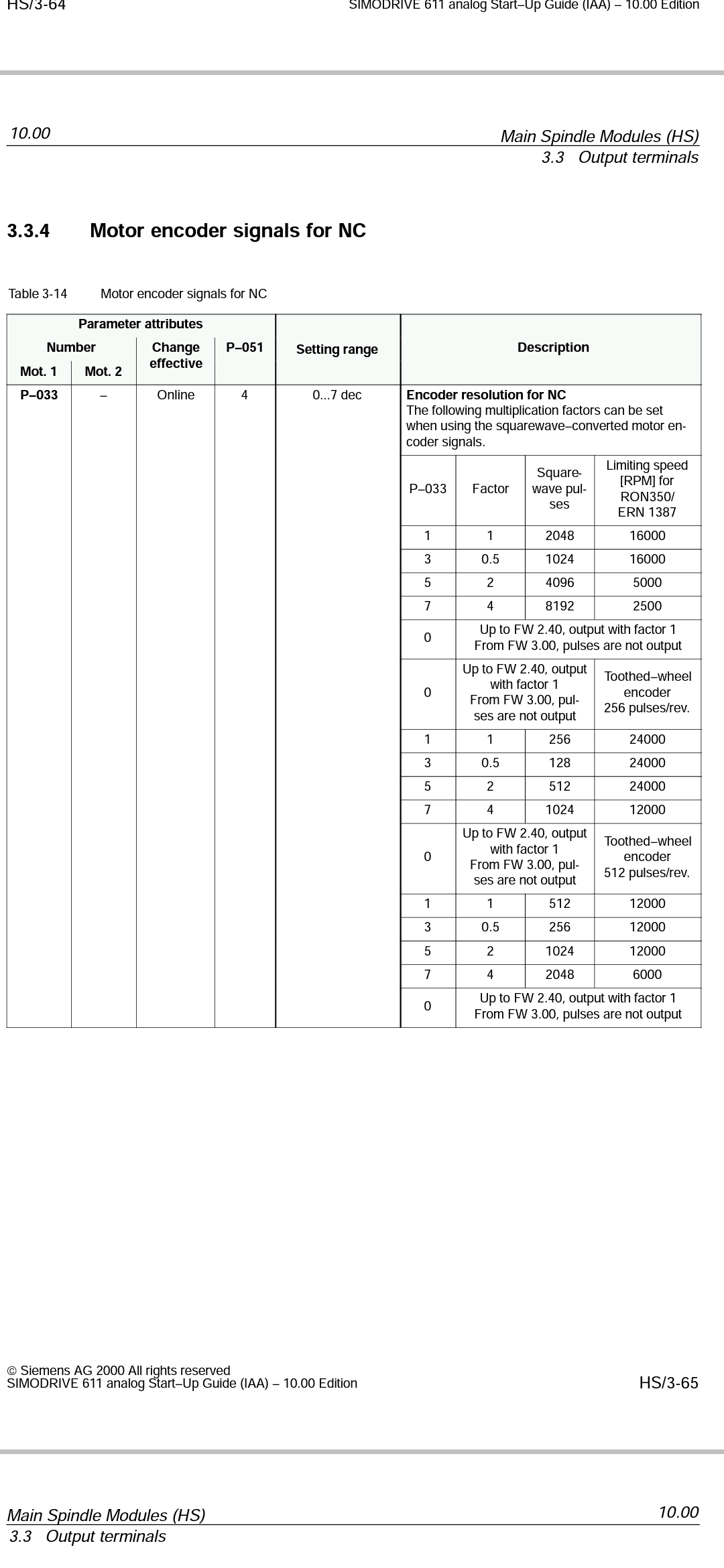

Here are some pics of the thing... I found this parameter (P033) on the Simodrive manual. it seems to turn off spindle encoder output after FW3.0?? I need to see what this means...Also, what resolution is the encoder? (or simulated encoder output of the drive)

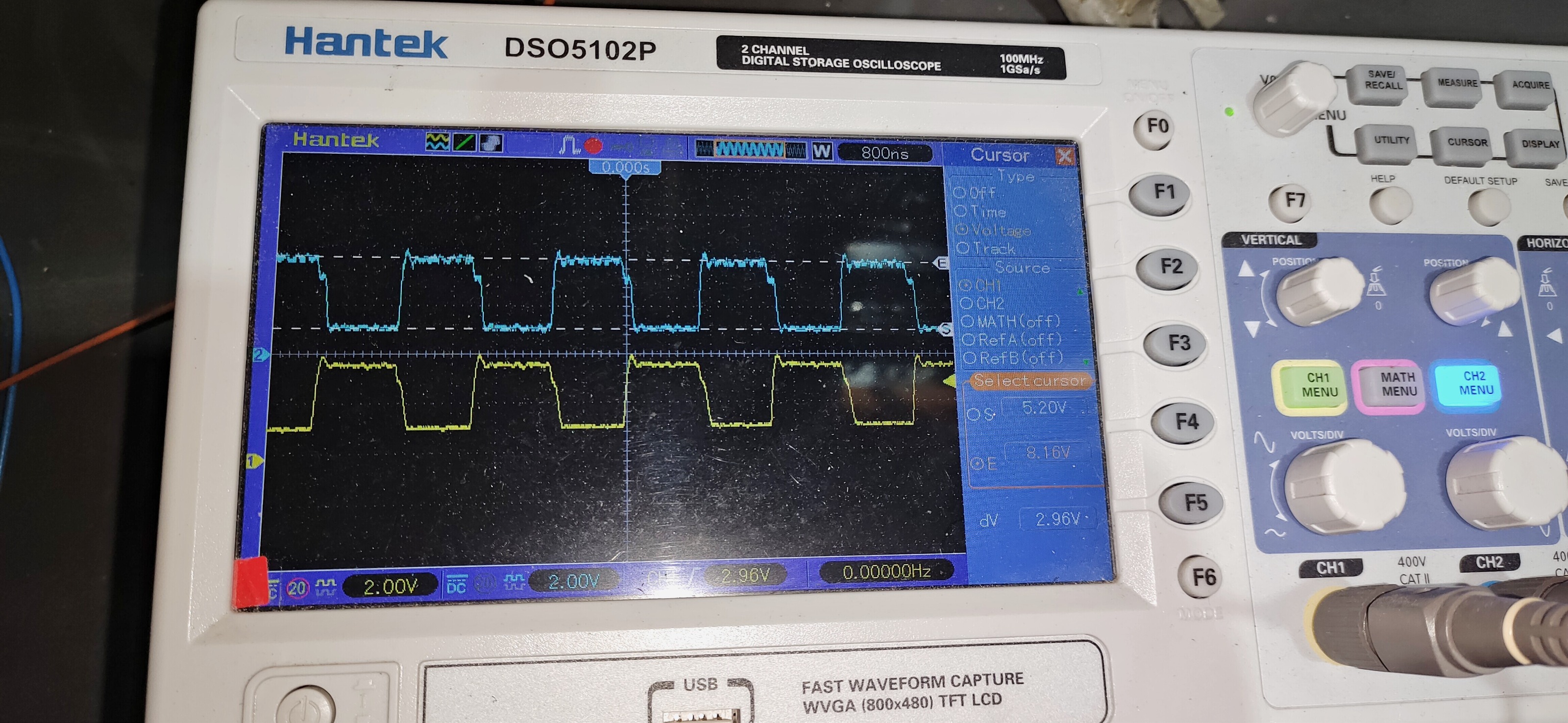

Today was a new day, i tested the ouput on the spindle drive itself and it seemed fine for the most part.. the only thing i found odd was the signals voltage... It showed an amplitude of 2.5 volts? from low state to high state...
I believe a real encoder conected directly to the 7i77 would have 5 volt amplitude...
Will test this now.
The pictures show encoder output A on chanel 1 and output /A on chanell 2.
Will test this now.

- andresgodinho
- Posts: 9
29 Jan 2022 19:25 #233470
by andresgodinho
Reduced the encoder output from the spindle drive to half (2048 -> 1024) and got twice the speed... So my problem is that i AM reaching the encoder count limit of 2 MHz.
I am Now trying to tell linuxcnc to use encoder only up to 2000 rpm and then just ignore feedback from the encoder.
