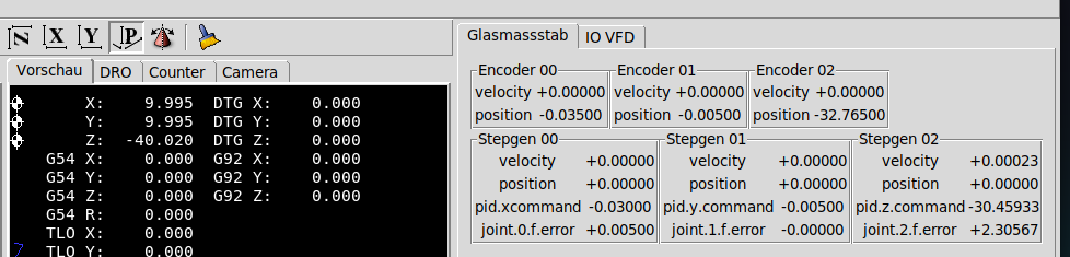

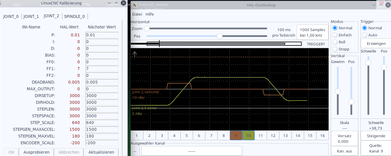

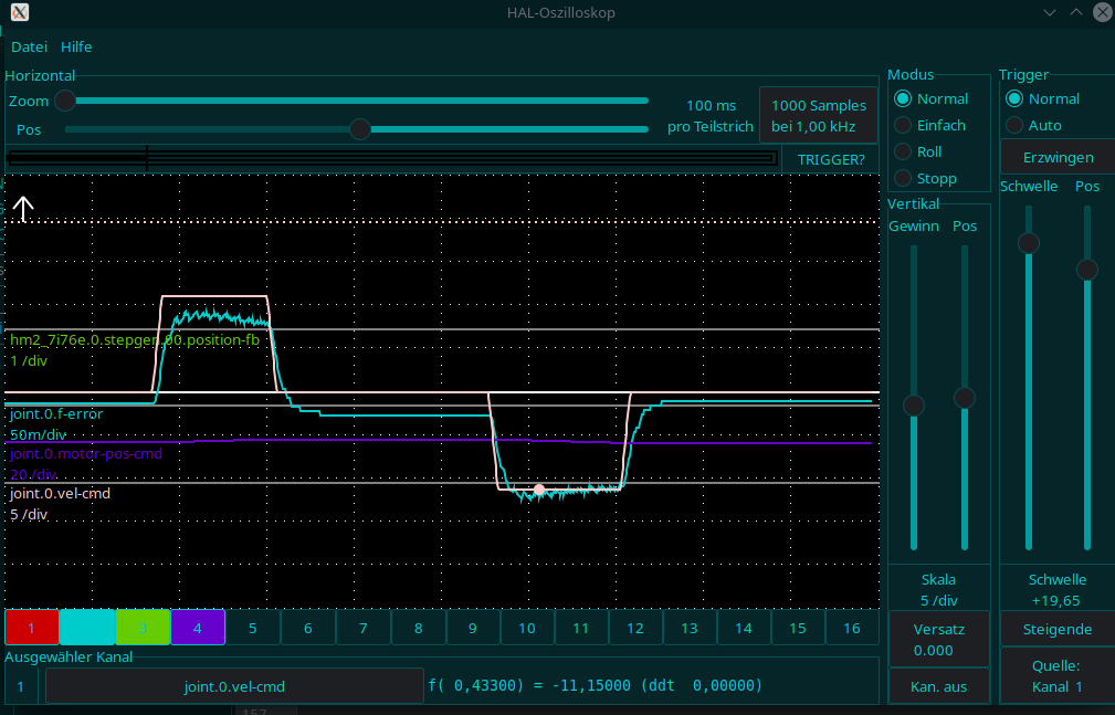

Hello,
I found the error, it was a minus sign ahead of the encoder scale. It now works at least.
Initially the axis was constantly moving no matter what p value I chose. A deadband of 0,0005 stopped the movement.
Now the f-error can be a little more than 1/100 at most, I think that is OK for a diy mill.
(attached file)
I tuned the internal PID quite well (I think), now that I try to tune the P value, there is no vibration on the
axis even if I leave it at 1000.
For the FF1 it is best to leave it at 1. (so no tuning at all...)
At a jog speed of 52mm/min I get the hal scope attached png
and at 669 mm/min I get the 669.png
As I'm not an engineer and I'm tuning a servo the first time:
Just want to know is that a reasonable result or is there much more to tune.
I used the instructions from tommylight (thanks for that...)

SInce both plots have a velocity dependent error
you might try tweaking FF1 a little bit, to say 1.001
(ferror in the same direction as velocity means FF1 is low)

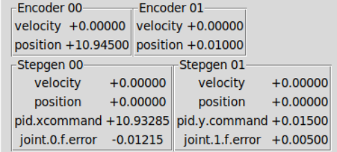

I installed the scale on the z-axis and was looking forward to tune it. Now there are some problems I don't understand.
I set P to 0.01 otherwise the axis is moving by itself. I think it is the mass pushing down the z axis.
At least I can test, without running into the end switches...
But the following error is getting huge. It seems like if I move in one direction only the following error is increasing, not the position...
Why does that happen? Which value I have to tune to get rid of that error?
I added a screenshot while moving with 421 mm/min.

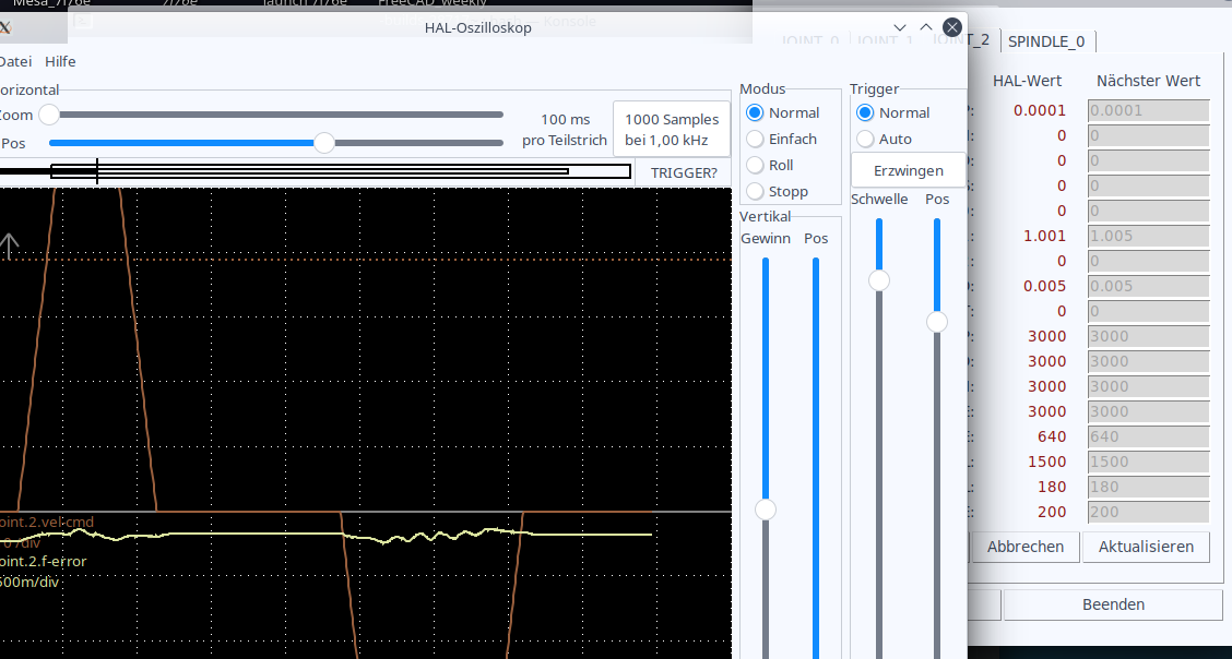

Found the reason, changed the scale and there was that little minus sign in front of the encoder scale ....
But still the f-error increases while the axis is in motion. Not as bad as before but not negligable.
It adds up moving upwards, moving downwards it is Ok so far
Attached is the halscope at 5134 mm per min, and the values I got from
the encoder and from the servo.
I'm stuck here and help would be much appreciated...
