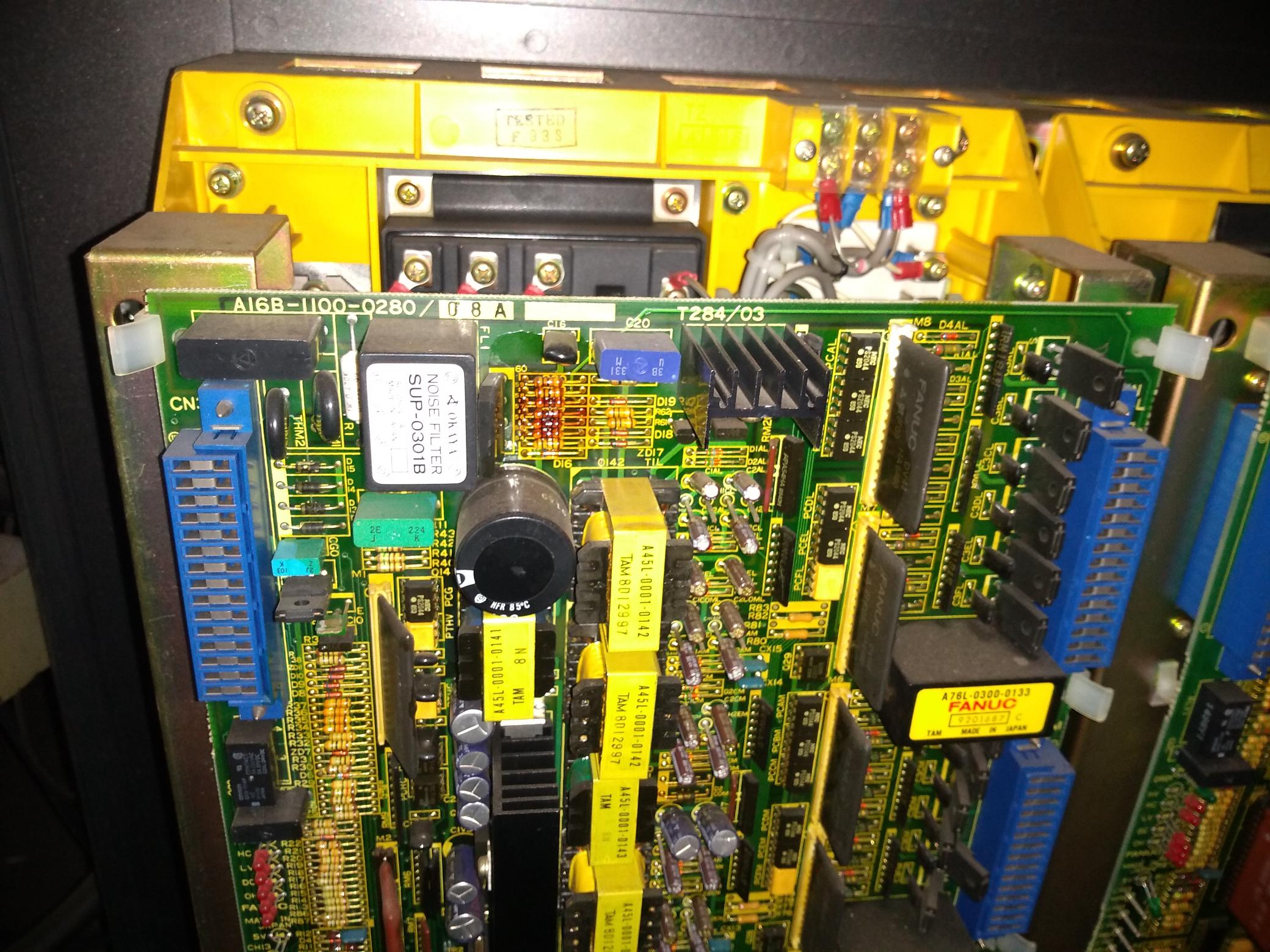

Thank you for your reply, I had not thought about the amps as being +/-10v input signal, I had assumed that Fanuc amps in the late 80's were using the 6 channel PWM per axis as discussed in this topic
forum.linuxcnc.org/30-cnc-machines/20837...ation?start=40#64638
So maybe using my existing servo's may be easier than I had assumed.
This is what I think I know:
Encoders are 2000 line pulse coders with Fanuc 4 channel commutation signal, I think the BLDC component can handle that part.
Amp connectors CN1 are 20 pin Honda type.
Motors don't have a tacho.
I have a couple of old 5i20's and 7i48's I wanted to use.
What I don't know:
The pin out for the CN1 connector or where to find that info, so far searches have turned up nothing.
If my 5i20/7i48 combo would be fast enough to do the commutation.
If I find that the amps are not /-10v, what to do at that point.

Alas, it seems the amps are not analogue, on closer inspection I found the model number A06-6058-H325
Looks like they are digital, but with pulse encoders
They have a single 20 pin Honda connection cable per axis coming from the control, encoder feedback going to the control , but google searching giving no results for pin out data so far.
Is it possible to use these amps with LCNC or should I just replace them.

Motor encoder will go to axis control card and drive unit is just a 3 phase PWM power stage 1 to 3 axis
Your Fanuc servo motor type could be 10S - not S10
For document google for Fanuc B-54765E pdf

Thanks for the search tip, that pdf covers the A06B-6050 amps, but it has got me closer in the search for documentation on the A06B-6058-H325 that I have.
Found a few references to the 6058 but with different Hxxx numbers so far.
My S10 number is the robot model with R-H control, seems like they are a somewhat rare beast.

Sorry it looks I gave a wrong version of Fanuc manual number .
It is for previous version to the drive you have.
Try these Fanuc manuals number 65005E & 65002E pdf

Thanks again, exactly what I needed .
