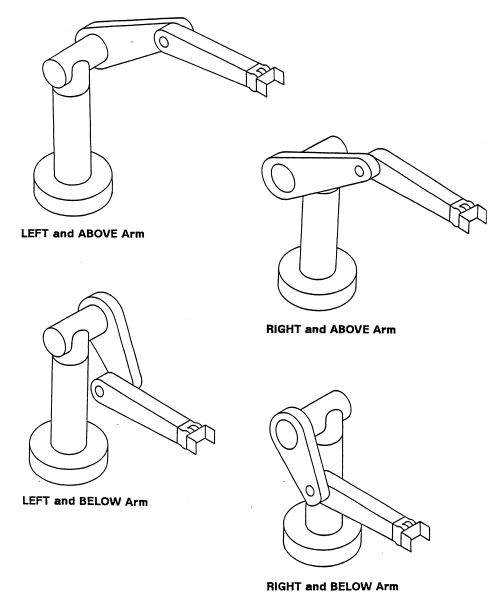

I added to my armkins.c file some flags or singularities as shoulder right or left and wirst down or up. Now when I pass to world mode I have a "following error" without moviment of robot and the software is stopped. Which could be the problem? (the latency of pc isn't it). The equations of kinematic yet? or some starting value wrong?

18 Jan 2012 13:03 #16883 by andypugh
Replied by andypugh on topic Re:*SOLVED* Recompiling genhexkins
You are well outside any area that I have expertise in now.
It might be interesting to set the f-error limits very large, and see what happens.
If you attach the latest kinematics file, I will try to remember to try it out tonight.
18 Jan 2012 15:49 #16889 by honey
Replied by honey on topic Re:*SOLVED* Recompiling genhexkins
andypugh wrote:
There could be more configurations of the robot to arrive to target. This is shown in the attached image
I have attached also the latest kinematics file. When I pass to the world mode, it seems that the software searches some positions and for this reason I have a "following error". But I don't know what and why happens this when I pass to world mode
