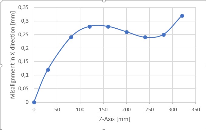

4 years 1 month ago #251518 by LAUSCH
Thank you @Aciera!
That helped to finally solve the issue. I have for sure not fully understood the kinematics module despite reading many documents.
The solution is as simple as changing the sign between kinematicFoward and kinematicInverse in my special case.
Of course this solution also works with polynoms of higher degree to compensate for more complex deformation of a joint and also for misalignments in two different directions.
kinematicForward
pos->tran.x = joint[0] -0.01*joint[1]
kinematicInverse
j[0] = pos->tran.x + 0.01*pos->tran.y
In my case I had a misalignment of the Z-Axis in the direction of X which looks as shown in the attached picture.
By the user defined kinematics module it was possible to compensate for the misalignment with deviations less than 0.02mm along the entire 350mm of my Z-axis
