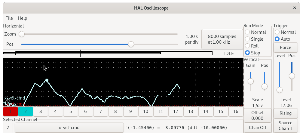

I am running Linuxcnc 2.9 with QTPlasmac v1.223.185
There was an update a few days ago and I updated without backing up my settings. I then proceeded to travel down a rabbit hole or 2 trying to improve my cut speeds. The machine seems to run great with the exception of the THC will not activate. I believe that I am having an issue with not reaching the 99.9% feed rate to activate it. The THC will activate if I use a velocity setting that is over 10 inches/sec. That is too fast and the THC is erratic. I have voltage showing, so I know the THC-AD 10 is working, THC is of course enabled. The velocity anti dive light comes on, whether turned on or not, upon initial pilot arc and stays on the whole cut. I have included a backup file with all my info. Any help is much appreciated!!

Assuming that you use the default material speed of 200 ipm, is the velocity reaching that during a cut?

I am trying to get to 200ipm. My max with previous settings was 190. Thus the velocity and acceleration changes. According to Halscope watching x-vel-cmd, it only reaches 3.333 momentarily during a y-lateral cut. not the best screen shot... its
showing 2.9 but it did get to 3.3333 on a different try. This is a curve leading into a straight line. Looks very erratic to me tho.

That explains why THC is not activating. I am not sure why the velocity is random, maybe it is not physically capable of the max specified. You could try the Calibration button in the Parameters/Setting tab and see if you can tune the motors.

The update was an OS update. I assume it also updated QT at the same time. At any rate, I think I have it figured out: My X and Y velocity and acceleration speeds were too low. Your comment about the files not being the current version are correct. I found an old ini file that I uploaded to you guys back in May when I was first learning (still learning). My settings now were quite a bit different than the old ini. With settings updated, the THC works now. Not sure if the OS update or me, scrambled something. Old configurations are now deleted and new is backed up. Bright side is I definitely learned to back up settings and try to analyze the big picture!
