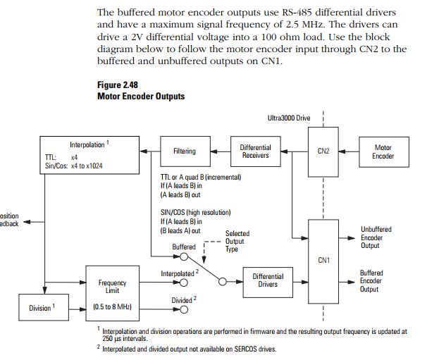

I'm changing my 4th axis from steppers to a servo and would like to implement index homing rather than just homing to a proxy (current arrangement). The proxy accuracy is decent, but I'd really like the repeatability of the encoder index (i.e. no fiddling with a DTI every time I want to use the 4th axis).
I don't have any encoder/index pins available on my 7i76ED, and from what I understand index pulses are usually too short for GPIO pins to catch.
My drive (Allen Bradley Ultra3000) has an internal move to sensor, home to index function. Encoders are incremental, not absolute.
Browsing the forum I see the Ethercat folks have been working through handing off all homing to the drives and LCNC 'plays dumb'. However, this is not an Ethercat drive - everything I'm doing is bog-standard I/O.
I can see couple possibilities:
Anyone have some thoughts on this, or a better way to let the drive take care of homing?

If this is just for one channel you only need 1 high speed input to implement
stepgen homing to index. A parallel expansion I/O pin can be use for this with appropriate
firmware (and interface protection) If you have a differential index output and you are not
using the serial expansion port, that's another way to input the index signal (on the RX lines).

I really like the idea of using LCNC's onboard homing. Yes, this is for one channel only. Just need LCNC to catch a single index pulse.
I'm assuming by 'parallel expansion IO pin' you mean the 25p headers on my 7i76ED? I'm using the serial interface for my 7i73, so that's not available.
What input/interface protection would be required?
Drive encoder outputs can be buffered or unbuffered. Unbuffered are not conditioned or filtered. Here's a snip from the manual regarding encoder outputs:

I'm assuming here that you have an Ultra3000i drive (the "i" is for indexing) since only those have the homing feature. If this is the case then IMHO this could be both better and easier to let the drive do the heavy lifting.
With the drive 'home type' set via ultraware to 'To sensor/Fwd to marker' or to 'To sensor/Back to marker', according to your hardware configuration you then need only:
- 1 homing sensor connected to the drive input 'home sensor'
- 1 switch connected to the drive input 'start homing' (no need to pass through linuxcnc)
This will take care of the whole homing procedure on the drive/motor side. This will also make the home position repeatable since this will use the index pulse as you wanted.
Now, for linuxcnc you really don't need more than the 'immediate homing' mode which require ...nothing... except a push of the home button.

I think that this might be simpler than it looks.
Put the A axis last in the homing sequence
Trigger external drive homing of the A axis with the "homing" signal of the first axis in the sequence.
By the time the sequence gets to the A axis it should be externally homed and in position. At that point if the A axis is set to immediate homing in LCNC it will reset to mark the externally-homed position to zero, which will be correct.

Thanks all for the feedback. I really like the idea of letting the drive do everything.
@JPL
Yes, it's a 2098-DSD-010X (indexing). Was not aware that only the X models had home to sensor, fwd/back to marker. Although I did find out the sercos models can have the sercos interface disabled which opens up additional IO.
Should be easy enough to adjust the motor-drive coupling to get the index pulse half a rotation from the proxy home switch trigger point. The whole thing is based on a 50:1 harmonic drive and the proxy is triggered by a flag on the output.
@rodw -
"nontrivial" = not going to attempt this, but thanks for the reminder. Not a programmer; maybe some day.
@Andy -
I don't want the A-axis homing automatically with the X/Y/Z. I tend to leave a trunnion table on it and there may be interference or a setup on it that needs to be broken down or adjusted before 360 rotation (i.e. tall part that would smack the table at 180 degrees). But you've prompted me to read the INI file homing section and double-check the basics...
Sanity check...
Can anyone think of a scenario - user error or hardware failure - that results in Something Very Bad happening? (Other than homing with a tall part on the trunnion, of course, but I'd deserve that one)
