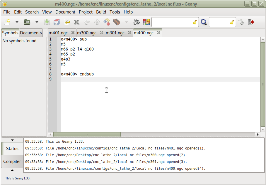

hey everyone
when setting up my cnc lathe bar puller i noticed that there wasn't much info on setting custom m codes connected to ladder in linuxcnc
so just making a post here about it to help the next guy
there are several bits you need to set up
and i will just add screen shots from my machine as i am typing on the lathe now.

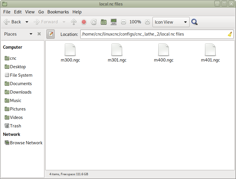

first up is the config folder file

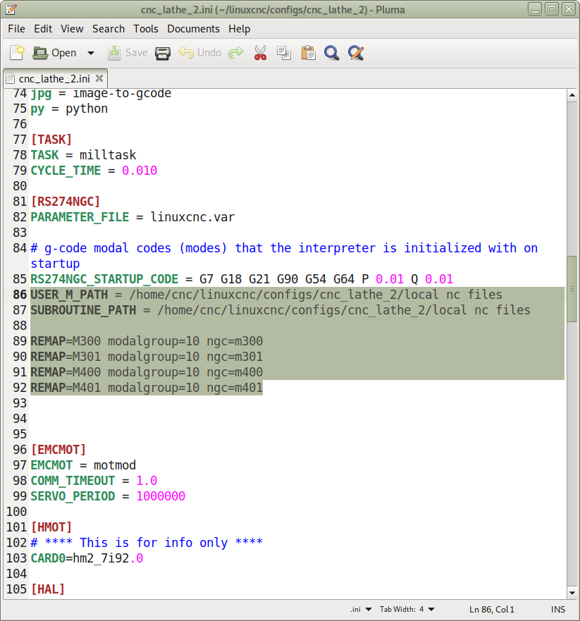

i think that is matters that the ngc file is lower case and the ini file setting options are uppercase. just copy exactly and it works
then the ini settings file with relevant stuff highlighted

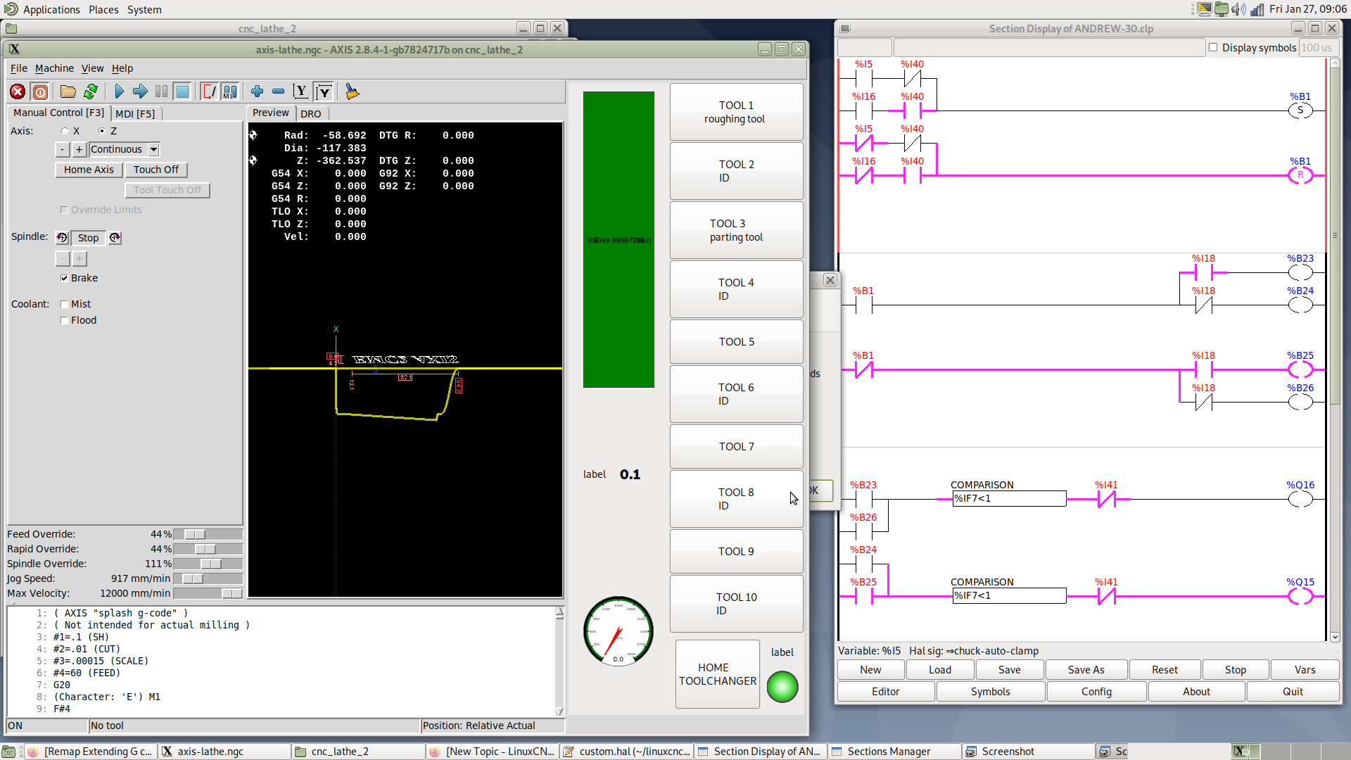

this is the line of code you need to add to connect the motion g code output pin to classicladder
net chuck-auto-clamp motion.digital-out-02 classicladder.0.in-05
the "chuck=auto-clamp" is just a signal name and doesn't matter it could be called "your-sensor-name"
and this is what the ladder logic looks like. just a note to make, this ladder logic is not very good and don't bother copying it lol
i am just trying to show the connections required to make this work in the ini file and in the hal file.

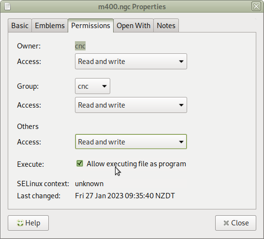

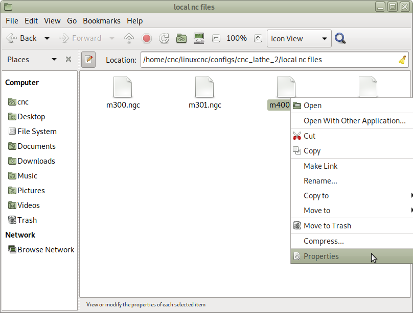

this bit below is pretty important. if you don't set this then it just won't work and you will have no idea why
you need to set the file permissions for the g code files

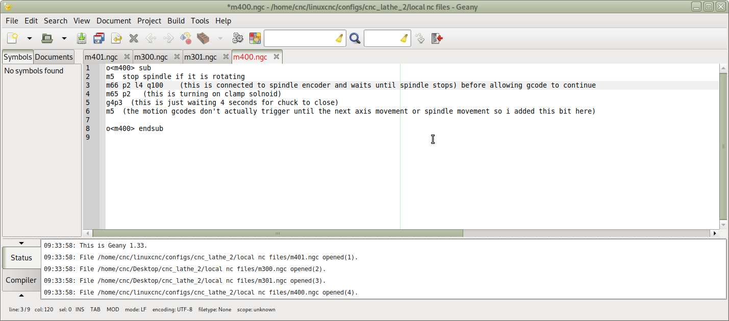

and finally the gcode file itself
make sure the bit inside quote marks "o<m400> sub" and "o<m400> endsub" is exactly copied in the file
hopefully this helps someone
i am going to try run a production job today bar pulling and will add to this thread and hopefully show how powerful linuxcnc is
