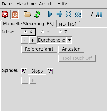

While a gcode-command is running, it is signed at the pin halui.programm.is-running.
Is there a pin, which shows a manual command from the ui is running?

Thank you for your answer. Sorry, but i didn't mean a manual mdi-command.
I mean the buttons on the first tab in "axes". (see attachment)
04 Feb 2023 10:50 #263654
Replied by andypugh on topic Pin for manual command is running
In that case, no. Only the GUI knows that you have pressed those.
What is the use case? The buttons only do a very limited number of things, most of which directly set a HAL pin (spindle on, flood on etc)

May be, i am using the wrong way, but for switching the spindle-gear on my cnc, i remap the s-code and set an motion.analog-out-00 pin as speed-cmd. So, if the user press for example "+"-button on the manual page for the increasing spindle-speed, i need this info for using an other speed-cmd pin as setpoint for the new spindle-speed and for switching the gear.

For this particular situation you can create a HAL pin that changes state when the spindle buttons are operated, but I am not sure how you will then use that pin to call your remap.
Use a "ddt" component monitoring spindle speed command, and then a "wcomp" to set a bit when the ddt is non-zero.

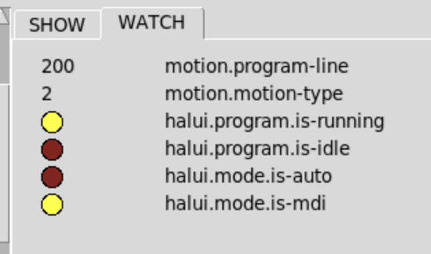

I still have the problems, between mdi-commands and manual inputs in the manual tab. Sometimes when chosinging the manual tab while a gcode like S1000 is running, the pin halui.program.is-running remains in true for ever and i didn't know why. Only a estop can help.
