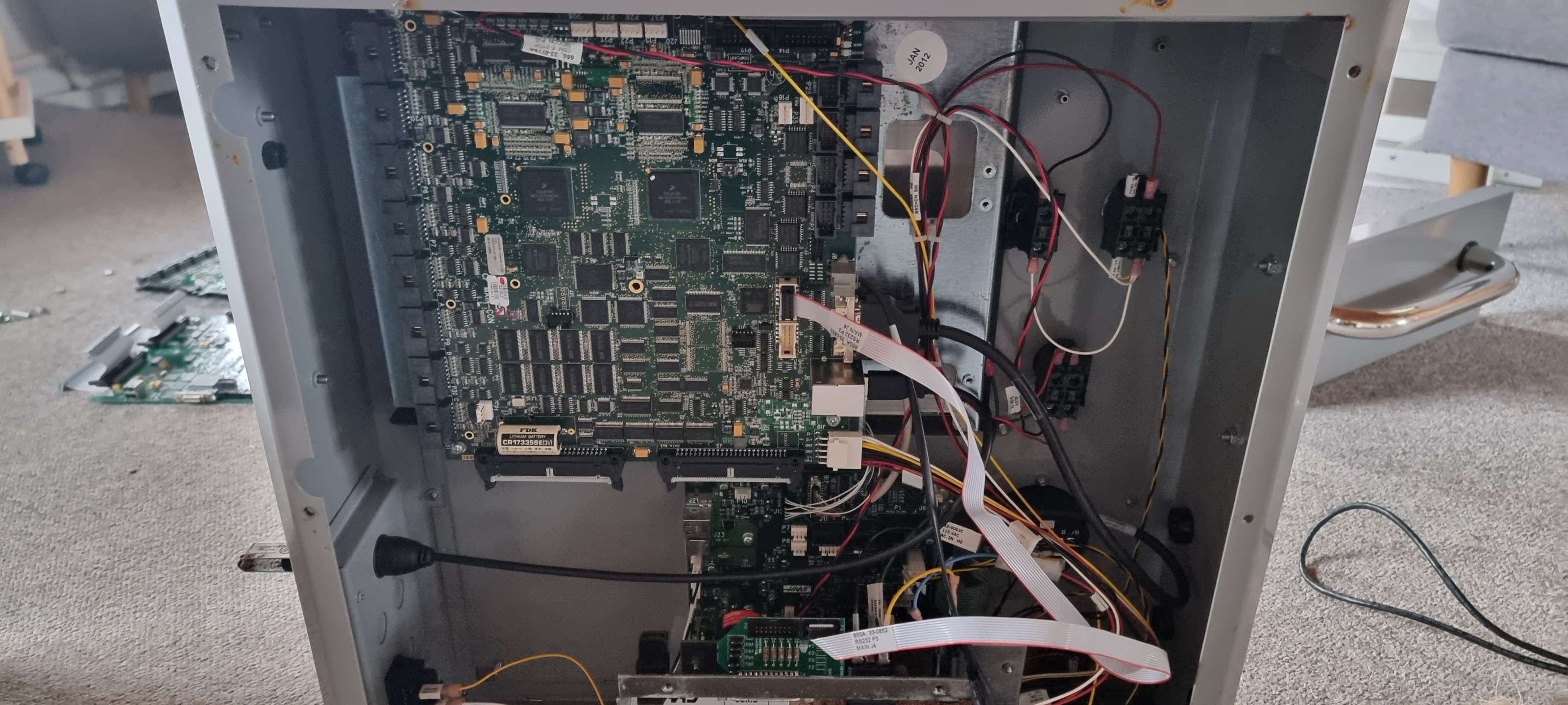

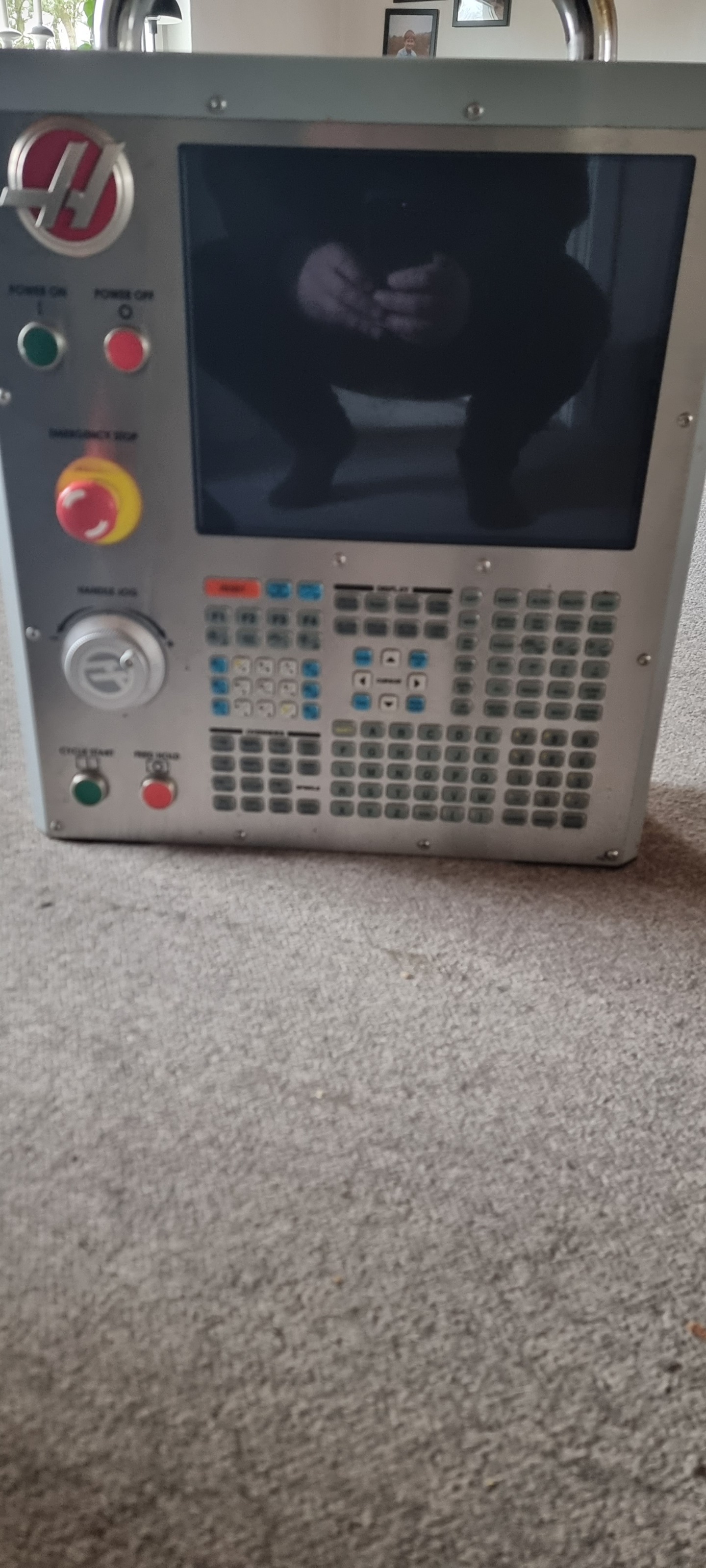

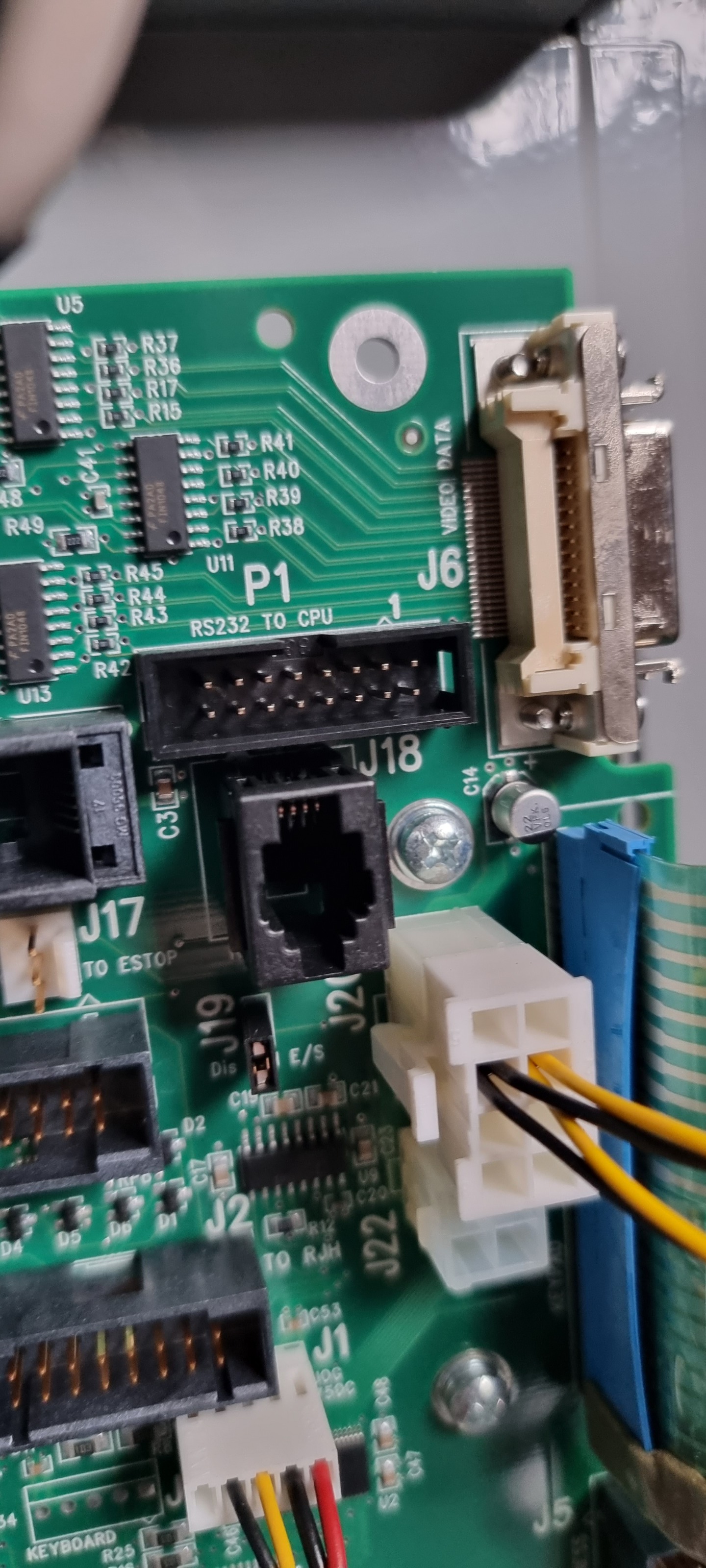

hello guys
i got a par of these Haas panels
is it possible to set it up and running linuxcnc ?

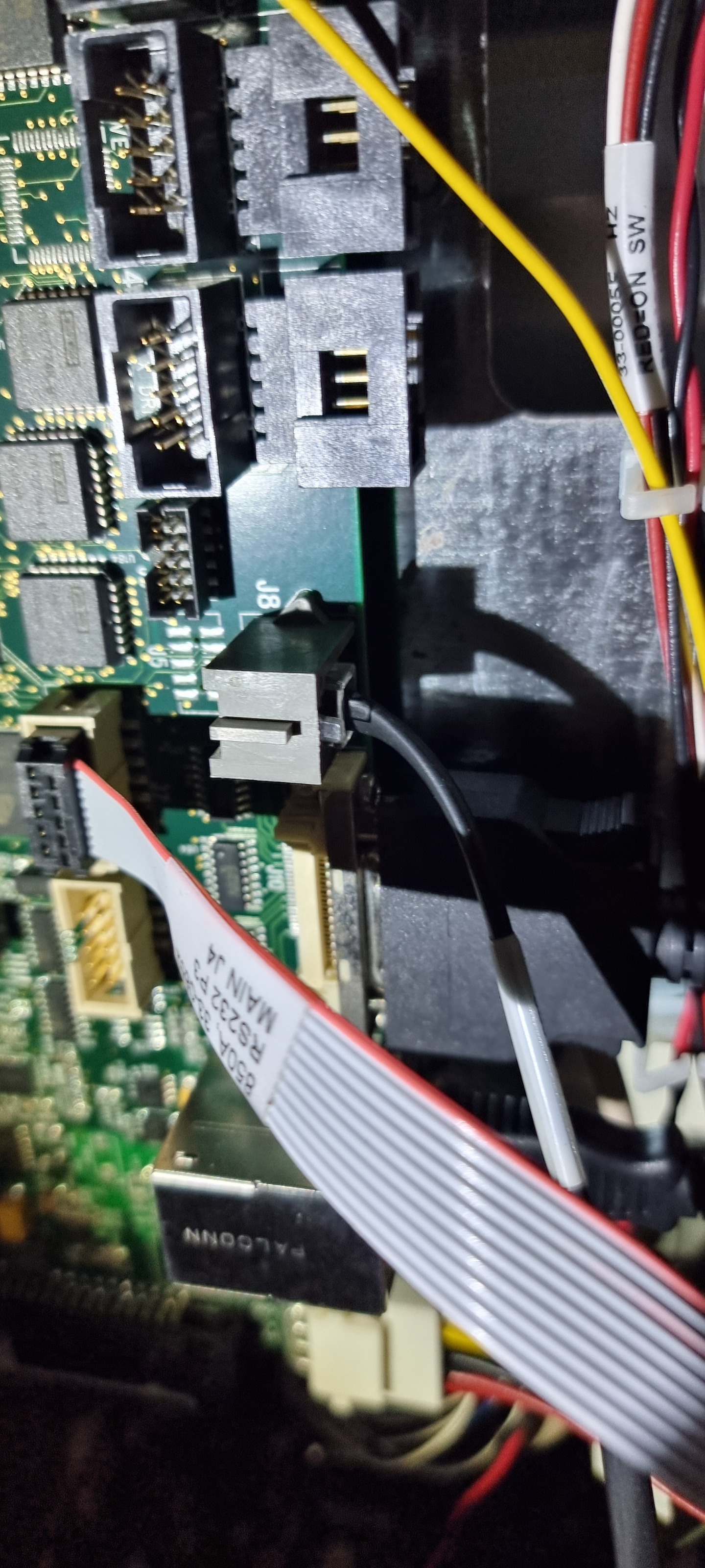

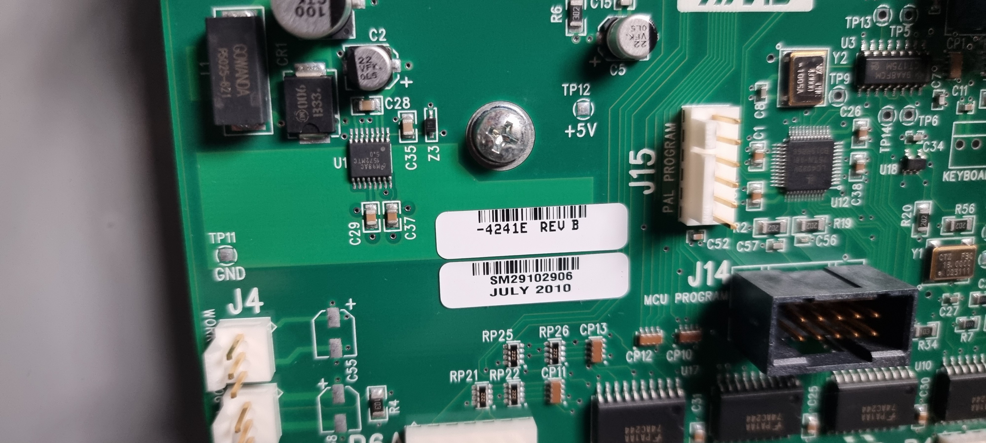

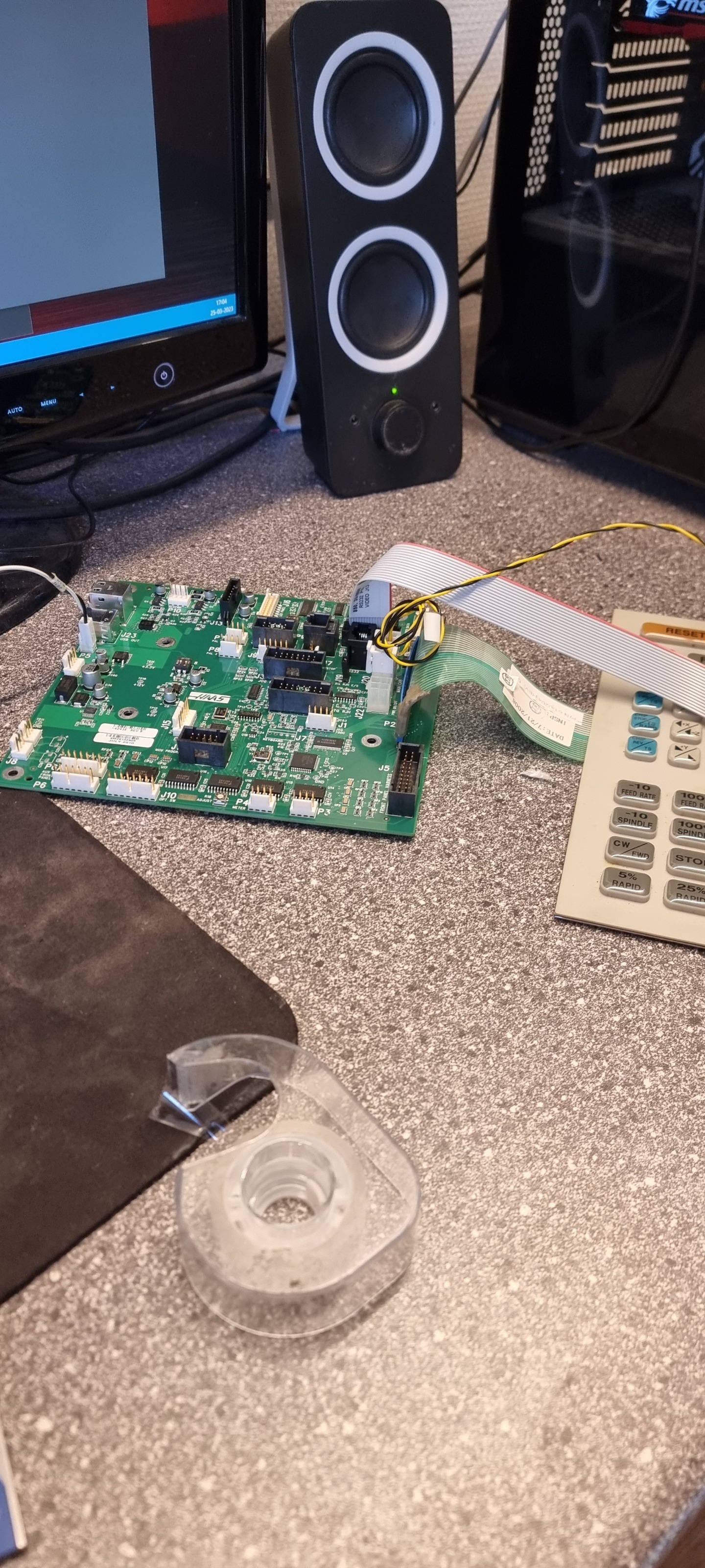

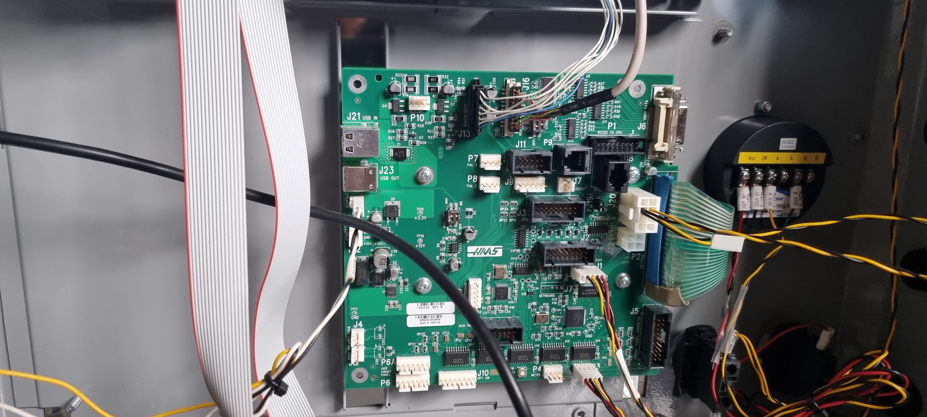

I found the panel controller board, than communicate rs232 whit 4 pins rj11,
Last edit: 25 Mar 2023 11:31 by Kasper-001.
- Thank you received: 4654
29 Mar 2023 09:50 #267785
Replied by andypugh on topic haas panel to controlle mesa board
In theory you could pass the serial data into a Mesa UART or the PC motherboard serial port and parse the data there.
It might be simpler to just wire the controls and keyboard matrix to a Mesa 7i73.
Have you logged any of the serial data stream?

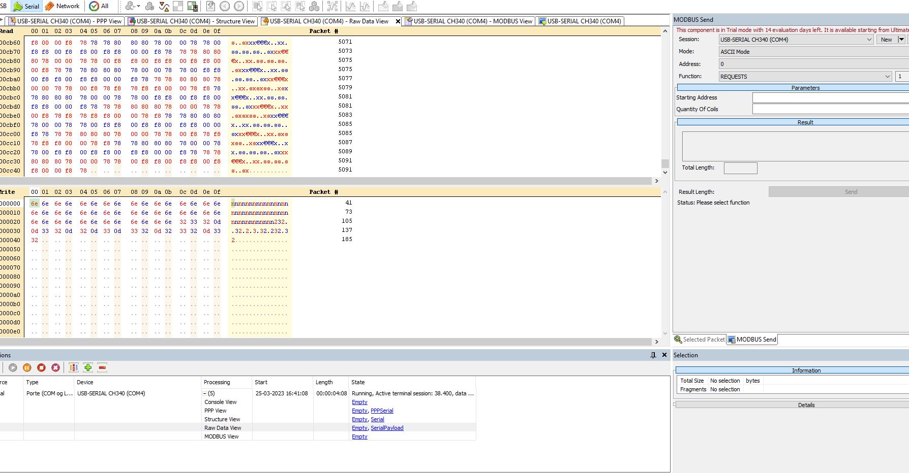

yes i have logged on data , but it seems that it's encrypted , speed is 38400,
and to get the data to flow, i have to type something random many times
yes it was my option B.

Do you see any consistent pattern when you press particular keys?
Does anything correlate to: github.com/torvalds/linux/blob/master/in.../input-event-codes.h
(probably a bit too much to hope for)

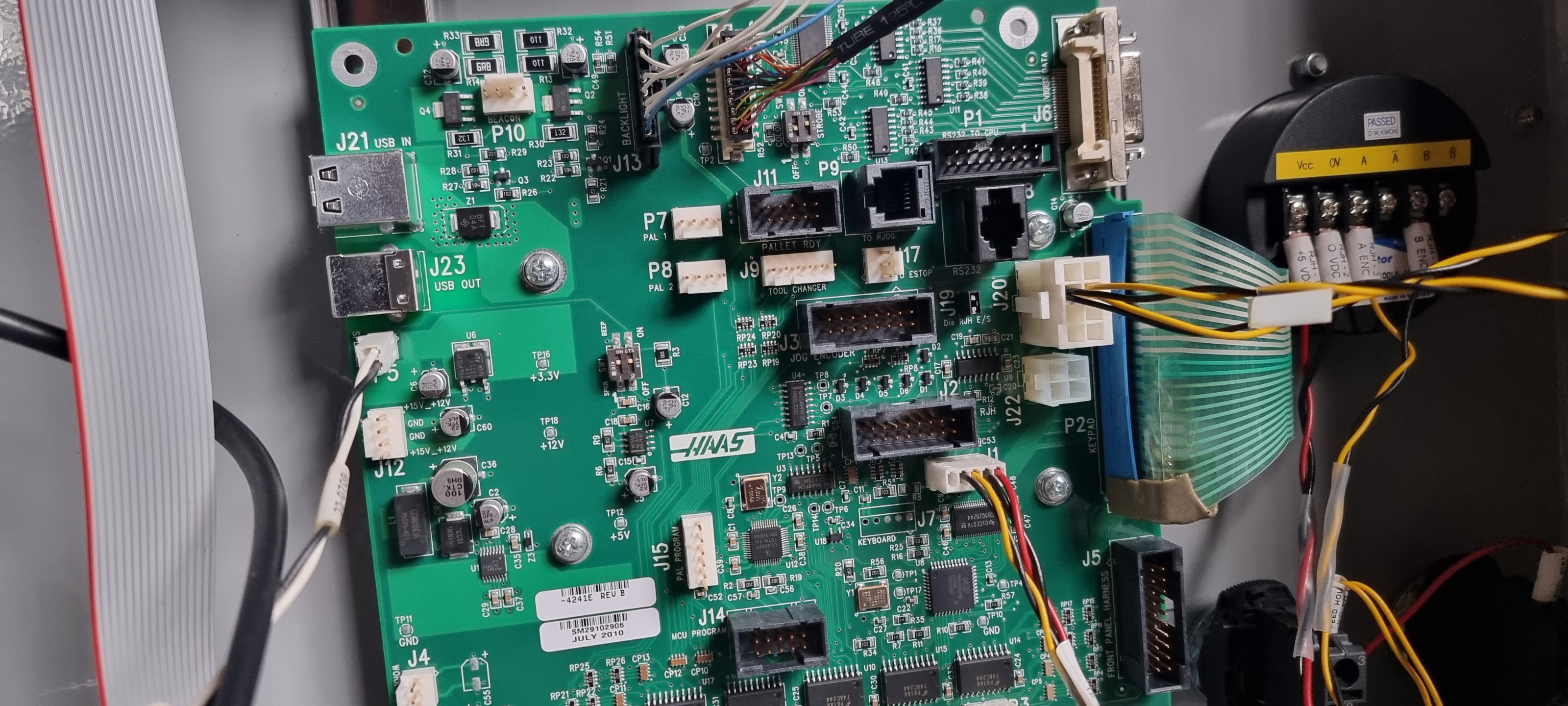

Download this: www.haascnc.com/content/dam/haascnc/en/s...ce-manual---2011.pdf
Then have a look around p.65
This hopefully could help
