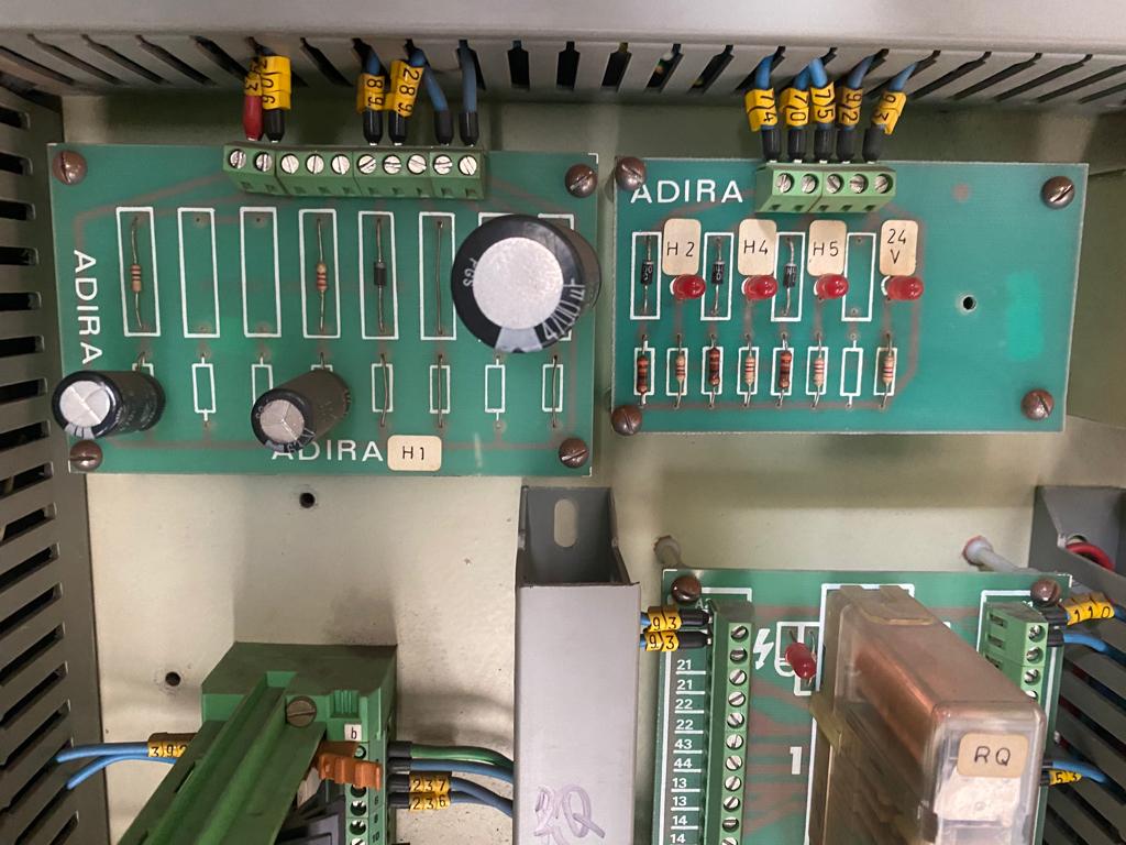

Hi guys!
I have a few old machines with dead controls, one of them is a press brake with fully functional hydraulics but the main chip was defective. For the sake of learning linuxcnc i am trying to retrofit these machines, now it's time for the press brake.As i've done my homework, i found out this system is driven by a proportional valve which receives a given voltage to let the hydraulic be fully closed, or open.For this i've been searching a mesa card that can provide this analog output, and couple it with a linear encoder, to better tune the movement of this new "axis".Although this seemed simple at first, after opening the press brake i found the proportional valve is "many valves" and i can't seem to find a way to "hack" into this system and add my own connections.I found out that this is driven by a bosch PL6 0811405060, but i'm not sure as to what all the valves are doing.There is also a panel of resistances which have a label matching each of the valves near the hydraulic pump, so i can figure they are related.There are not any manuals available for the press brake, so i'm trying to get some hints on the web as to what i could do to start this retrofit !
