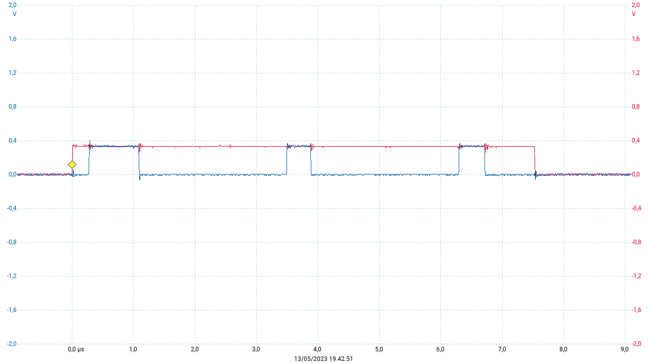

13 May 2023 12:07 - 13 May 2023 12:08 #271293
by PVal
Replied by PVal on topic Sanyo Denki ABS encoder
I have made modifications to fanucabs and after quite many iterations I was able to send the request string out. (Picture shows tx and tx_en signals, measured directly from 5i20.) This happened just yesterday so I haven't had time to test it with actual amplifier. Next I will send the request string to amplifier and hopefully get a response back. After that I'll have to find out how the amplifier response is read and converted to position data.
Last edit: 13 May 2023 12:08 by PVal.
