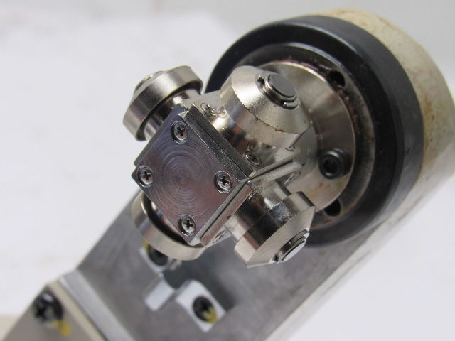

has anyone actually made a working lathe tool sensor, a x- x+ z- z+ for setting tools ? if so, how did you implement it ? I tried googlefu, came up empty, and I was considering a hal component, not sure how I would implement the offsets though. but I am investigating it.

Do you mean something like this : www.haascnc.com/video/tips/s4xeo5gcxhk.html

yes, 4 sided tool setting sensor. I'm working through the variables of a hal component for this. mostly trying to figure out how to send the events and store them. thinking a macro with tool position, via halui.
kinda complicated, setting tools manually is obviously les complicated and i intend to start from there.
the sensor measure's tools a specific distance z- z+ x- x+, and those offsets need to be associated when the sensor is triggered.
it would also be nice to have a homing type routine to measure the tool once it's close. long term, be able to enter a approximate tool length and have lcnc handle the entire transaction, that's more complicated however.
but for now, triggering a tool offset measurement in a touch off, that's a start.

Yes, I set up the tool probe on my Cincinnati. You will need to create an input for the probe signal in Hal.
You then need a macro to measure the tools based on their orientation.
I wrote the macro as a custom M code. and. assigned positions based on tool orientation and clock direction. To touch off an od turning tool:
Type in MDI
M275 P12, as the top button of the probe is at 12 o’clock.
You have to measure the distance from spindle center to the probe and add it to the probed value, then write it to the tool table using G10.
I can share the Macro. You will have to write some plc code to put the probe up and down.

the lathe tool sensor has 4 inputs and has 4 offsets 1 per input. so that's why a hal component is needed, lcnc only allows for a single probe input and it's not specifically designed to be a lathe tool sensor.

Some lathe tool probes are basically a spindle probe with square sides (instead of a ball stylus).
However, some are 4-sided jobs.
Some (older) machines required the operator to lower the probe arm manually (or bolt it on). Newer machines generally deploy the arm automatially... meaning up sensor and deployed sensors, plus safety logic in case it doesn't make it down all the way.
Pretty sure you could do everything in M-codes, but it'd get messy and hard to follow or debug. A dedicated comp to handle all of the backstage stuff would be sweet.

This is my tool setting macro.
od tool 12 oclock P12
front of any tool 3 oclock P3
id tool 6 oclock P6
left hand tool 09 oclocl P9
set tool about .2 from the probe
Probe front of any tool
M275 P3 in MDI
G54 is ALWAYS machine zero, #101, #102 ect are the variables you have to figure out. #101 would be the difference from the triggered probe to the center of your spindle. #104 in my case is the distance from the front of the chuck to the face of the probe.
o<m275> sub
G90G49G54
(PROBE OD TURNING TOOL-THISONE WORKS)
o101 if[#<P> EQ 12]
