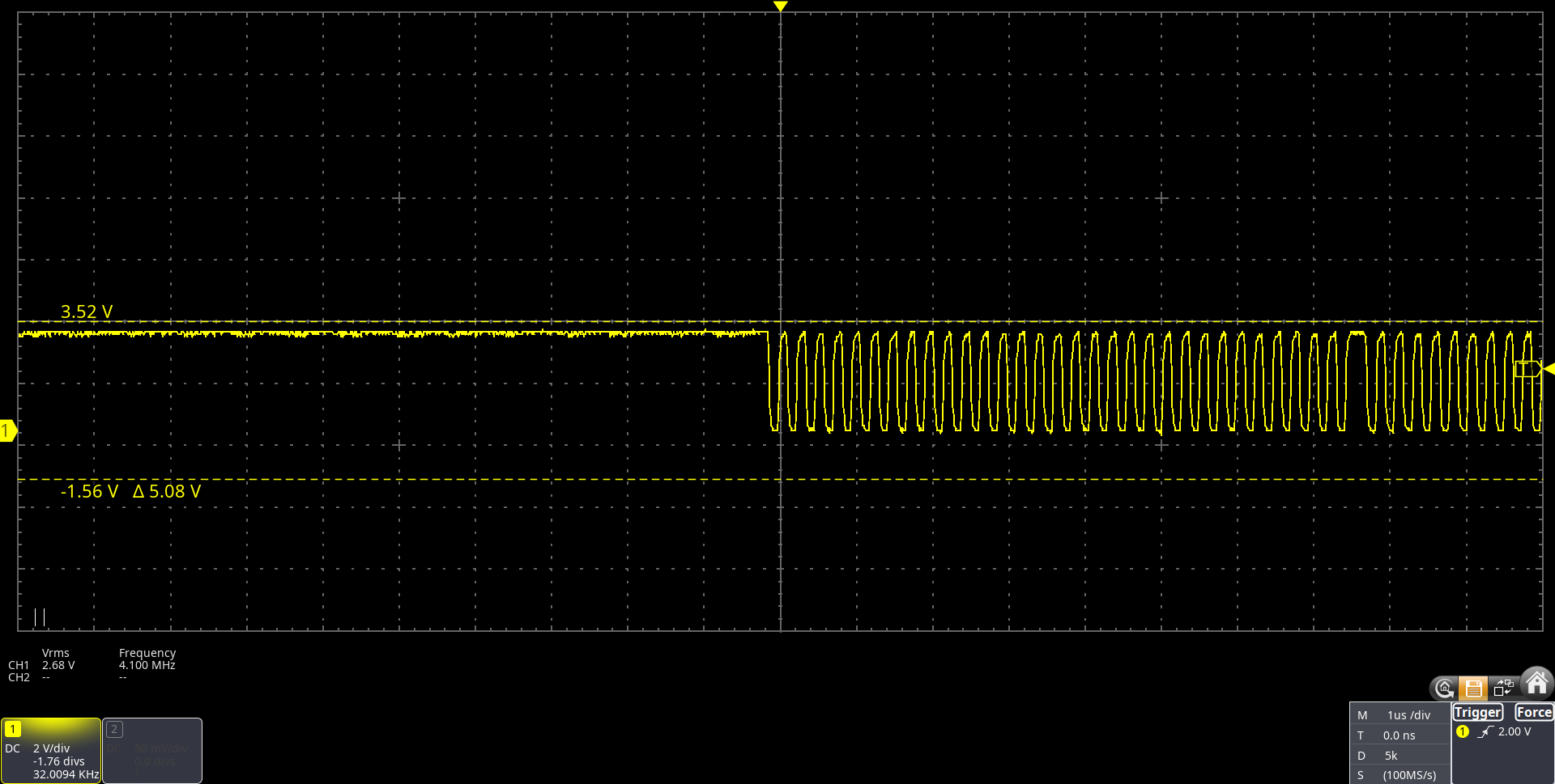

Do you have a stock 7I92?
It could be 7I92T related but I doubt it since it works here
- Posts: 18064
- Thank you received: 5308
04 Aug 2023 23:02 #276943
Replied by PCW on topic hm2 BSPI documentation, examples?
I take that back, the earlier 7I92T firmware with the /frame output works
but the 3a version does not
Do you have a 7I92 to test with, There looks to be a problems with the
BSPI firmware on the 7I92T after I made the DBSPI (decoded) /BSPI (non-decoded) merge
Try this firmware:
I thought I had weeded them out but there were some left over
Xilinx-isms in the bufferedspi firmware module.

nevermind, I get the exact same prints you did but it took a bit to start

I have to revise the PCB again at some point, do you suggest I use pulldown resistors on the SPI lines (besides enabling the 4.7k networks on the 7i92)?Does the pin list linuxcnc prints at startup look reasonable?
Are the CS and SCLK pins driven? (pull down with a 1K resistor)
I can't find any info suggesting SPI lines should be driven externally , though it probably won't hurt to have resistor footprints on the PCB
