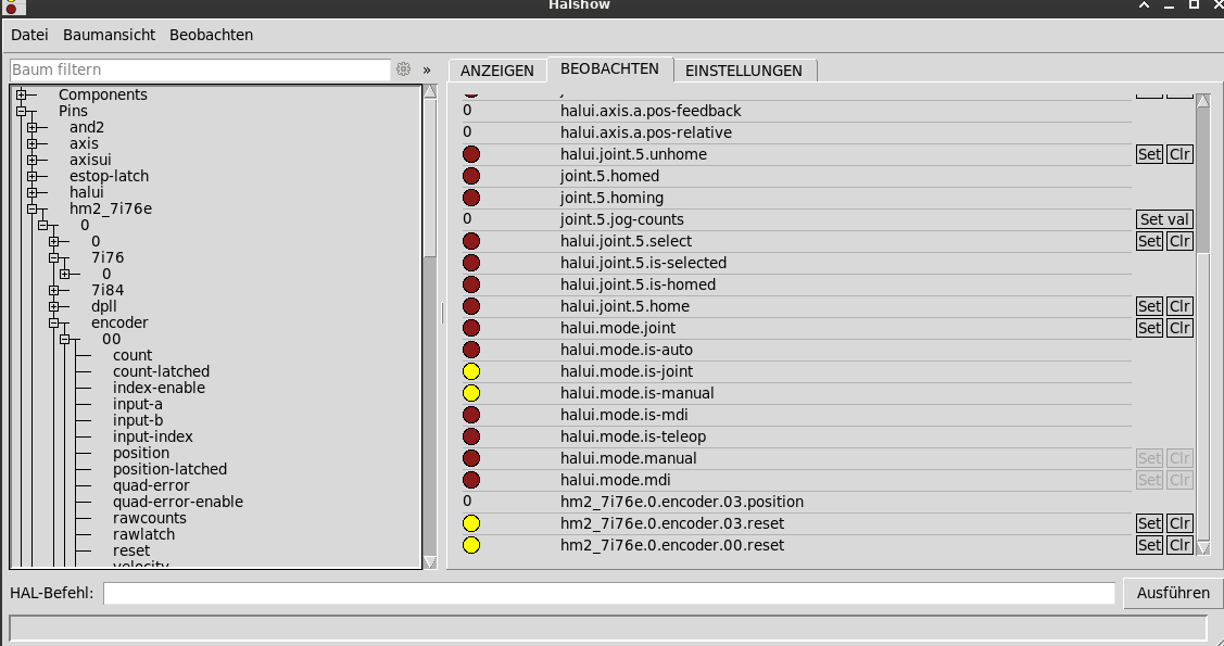

26 May 2023 14:03 #272216
Replied by Aciera on topic Rehoming Lathespidle / Rotary-Axis from inside GCode
Hm, I have not but as I understand it this let's me reset 'counts' and 'position' from HAL.
Which would kinda work I guess and would have to do if I were using a simple breakout board on a parallel port. But waiting for it in hal and then sending the reset from hal is rather slow.
Since I have a mesa board I want the encoder counts and position to be set to zero in the FPGA on that board as soon as the encoder index is detected in the hardware.
And I can confirm that this method is VERY precise. My motor has an absolute encoder with effectively over 4 million pulses and I can home to +/- 3 pulses using the built in hardware encoder reset.
Using the above mentioned M19 spindle orient component plus a component to simply latch the encoder position before switching to spindle mode gives me virtually no following error while switching between spindle and rotary using the 'position/speed' switch in motor controller.
This might not work for a setup that handles spindle mode in the stepgen but for me this problem seems solved.
I'll test some more before moving on with building the hardware.
- Posts: 4818
- Thank you received: 2176
26 May 2023 15:52 - 26 May 2023 15:53 #272218
Replied by Aciera on topic [solved] Rehoming Lathespidle / Rotary-Axis from inside GCode
So this work just the way I hoped.
I'll attach the orient component from the other thread (slightly changed), my remaps to switch from position to speed mode and back and a small sample gcode.
Last edit: 26 May 2023 15:53 by Aciera.
The following user(s) said Thank You: besriworld, spumco
- Posts: 4818
26 May 2023 16:06 #272219
Also the encoder disconnect component and the relevant hal section.
