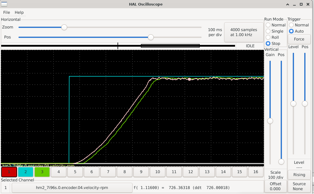

Major progress synchronizing the spindles tonight after re-reading Andy's earlier post(s) for about the 100th time.
mux2 #1 to connect main spindle encoder position to subspindle stepgen position-command
mux2 #2 to switch sub stepgen-type from velocity to position mode
Now the main spindle accel/decel PID doesn't matter as the sub just follows the main, including the caxis.comp return-to-last-position move.
Very slight delay on spindle start, but the encoder positions don't lie - following looks tight. Sub PID is still open-loop.
Still to work out...

After a few days and a million iterations it finally sunk in what values and connections needed to be joined up.
First hurdle... Andy's 'sample-hold' mux2 just wasn't sinking in, no matter how many times I read it or fiddled around. Probaby a character defect on my part.
I did manage to understand that the whole point of his mux2 was to overcome the glaring deficiency in LCNC's standard sample-hold.comp. i.e. that it only works with s32 data type. So... what if I just copied the existing sample-hold.comp, substituted 'float' for 's32', and renamed & installed it?
Holy [insert vulgar exclamation here], it worked.
I now have a tidy sample-hold-float component and don't need the mysterious mux2 feeding back in to itself.
So now the logic looks like this, in English (mostly):
When enabled, neither spindle does 'catch-up' or wild antics.
Start the main spindle and the sub is tightly slaved to the main, including with CSS and when the main does the caxis.comp return-to-last position rapid.
Turn it off again, still no ill behavior - Magic.
So I now have:
- sum2 #1: main-spin position - sub-spin position = sub position offset
- sum2 #2: main-spin position - latched sub offset = difference between main and sub is 'locked'
- At synch command
- Sample-hold-float - capture sub position offset value from sum2 #1
- Mux2 #1 - switch sub stepgen from velocity to position mode
- Mux2 #2 - sum2 #2 sent to sub stepgen position command
So I now have:

Step 1 - reprogram drive so M3 results in opposite direction. Done.
Step 2 - reprogram drive so M3 results in positive encoder direction. Done
So now I've got to rearrange the encoder value choreography somehow so that
- Main-spin encoder count increase
- Opposite output to sub stepgen
- AND the offset remains the same
Any bright ideas?
Current not-working attempt:
Warning: Spoiler!
#SYNC - SUBTRACT DIFFERENCE BETWEEN MAIN AND SUB POSITION
setp sum2.s1.gain1 -1
net SPIN0-REVS => sum2.s1.in0 #MAIN SPIN ENCODER POSITION
net SPIN1-REVS => sum2.s1.in1 #SUB SPIN ENCODER POSITION
net SPIN1-REVS-OFFSET <= sum2.s1.out
#SYNC - LATCH DIFFERENCE BETWEEN MAIN AND SUB POSITION (CUSTOM SAMPLE-HOLD-FLOAT COMP)
net SPIN1-REVS-OFFSET => sampholdf.s1.in
net SPIN1-REVS-HOLD <= sampholdf.s1.out #MAIN TO SUB OFFSET VALUE
net SPIN1-REVS-HOLD-ABS => abs.s1sync.in
net SPIN1-REVS-HOLD-ABS => abs.s1sync.out
#SYNC - SUBTRACT LATCHED DIFFERENCE VALUE FROM MAIN POSITION
setp sum2.s1sync.gain1 -1
net SPIN0-REVS => sum2.s1sync.in0
net SPIN1-REVS-HOLD-ABS => sum2.s1sync.in1
net SPIN1-REVS-SYNC <= sum2.s1sync.out #MAIN POSITION MINUS SUB OFFSET
#SYNC - INVERT MAIN SPINDLE POSITION VALUE
setp scale.s1sync.gain -1
net SPIN1-REVS-SYNC => scale.s1sync.in #MAIN POSITION MINUS SUB OFFSET
net SPIN1-REVS-SYNC-INV <= scale.s1sync.out #MAIN POSITION MINUS SUB OFFSET INVERTED
#SYNC - SEND OFFSET MAIN POSITION TO SUB STEPGEN POSITION CMD
net SPIN1-REVS-SYNC-INV => mux2.s1synccmd.in1 #SYNC ON
net SPIN1-SYNC-OUT <= mux2.s1synccmd.out
net SPIN1-SYNC-OUT => hm2_[MESA](BOARD).0.stepgen.03.position-cmd
- spumco
- Posts: 2171
- Thank you received: 896
13 Feb 2024 05:12 #293196
by spumco
Replied by spumco on topic (Solved) Synchronize multiple spindles? (lathe subspindle)
YES!
Trick is not to worry about the offset.
My brain is hamburger now, but I have a well-behaved subspindle that rotates opposite the main at M3 while rotating with the main when synchronized.
@Tommy - you want me to change the title to [SOLVED]?
- Step 1
- Sample-hold the main position
- Sample-hold the sub position
- Step 2
- Subtract main position from latched main value
- This is the incremental value the main moves
- Step 3
- Invert the increment value
- Step 4
- Add the inverted increment value to the latched sub position
- Step 5
- Send the incrementing position to the stepgen position
