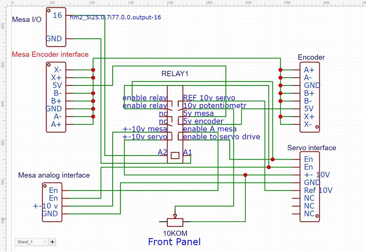

Can I break this thread so the system doesn't track the position. -> net a-pos-fb => pid.a.feedback

net a-pos-limit => joint.3.pos-lim-sw-inOr physically turn off the encoder, but specify the system so that there is no feederror
FERROR = 0.5 ------ > FERROR = 0 MIN
_FERROR = 0.05 -----> MIN_FERROR = 0

I - think - the solution is to use a mux component to swich the encoder's output between the spindle PID and the axis PID.
The switch is made using a pair of M-codes (axis mode on/off). When in spindle mode, the encoder is connected to spindle PID, and vice-versa for axis mode. And the axis-mode M-code also contains an un-home then home command.
So every time you activate the axis it will turn on encoder.N.index-enable, connect the output to the PID (via the mux), and then run the homing process.
I don't think physically turning off the encoder is the way to go.

I'm not familiar with analog servo setups but I have implemented a rotary axis/spindle switch with a motor drive that could be run in position(step/dir)/velocity(analog) mode. Which means I did not run the motor with the stepgen while in spindle mode.
forum.linuxcnc.org/10-advanced-configura...code?start=30#272218
I wonder if you could do something similar so I'll try to give a quick overview of what was involved.
Say we start with the rotary running in axis mode.
Switch to spindle mode:
1. Move rotary to position zero
2. Store the current encoder count and switch the rotary feedback from the encoder count to the stored count. (this means the rotary axis 'thinks' it is standing still while in spindle mode)
3. In my case I switch the drive to speed mode and use normal spindle command (M3 Sxxxx) to output an analog signal to run the motor as a spindle. In your case I wonder if you could maybe switch to a different pwm generator.
To switch from spindle back to rotary:
1. use M19 spindle orient to bring the spindle to the zero position. There is a special component that resets the encoder count on a mesa board to zero on an index pulse (in my case this pulse comes from the encoder output of my motor drive if you don't have an index signal you may have to generate one using an extra sensor on the motor). This basically 'rehomes' the rotary.
2. we can now reconnect the encoder count to the rotary feedback position. Note that, depending on the accuracy of the spindle orientation the spindle will have overshot the zero position and the encoder may be somewhere past the zero count. The moment this count is reconnected to the rotary feedback it will be seen as a position error and will be corrected by the pid. This might require relaxing the f-error value to avoid triggering a following error.
All the relevant components (encoder switching, spindle-orient) and mcodes are attached to the post linked above and the one immediately following it.
Maybe this give you some ideas about how to proceed in your situation.

linuxcnc.org/docs/html/gcode/m-code.html#mcode:m62-m65
Then you can use and AND component to connect the relevant 'motion.digital-out-0x' pin and whatever signal you currently use to drive hm2_5i25.0.7i77.0.0.output-16
Replied by Aciera on topic How turn off servo loop for one axis?
You could use M64/M65 to switch hal pins 'motion.digital-out-0N'How can I program M-code to enable and disable hm2_5i25.0.7i77.0.0.output-16?
There is no such Gcode, which is why we have to use the M19 spindle orient to 'rehome' the rotary spindle before we can use it as a rotary axis.I can't find the g-code that will send the axis to find a home...

Hello, in general, the problem with controlling the axis as a spindle was solved. Two relays were installed and they are controlled by M64 and M65. The first relay turns off the power to the encoder, and the second relay passes 10V through the potentiometer. Now, to execute the program, you must first grind the surface and then turn the axis back on. The position of the axis when it is turned on and will be the index. And relative to this position, you can do any operations with correct angles. After that, you can turn off the axis again and turn on the spindle and polish again, but back in the axis mode you will no longer get into the index. I made it through two relays so that there was no reaction to the rattling of the contacts. Encoder power is turned on after the LCNC has gained control over 10v for this axis.
Thanks to everyone who helped. Best regards. The forum branch can be closed.
