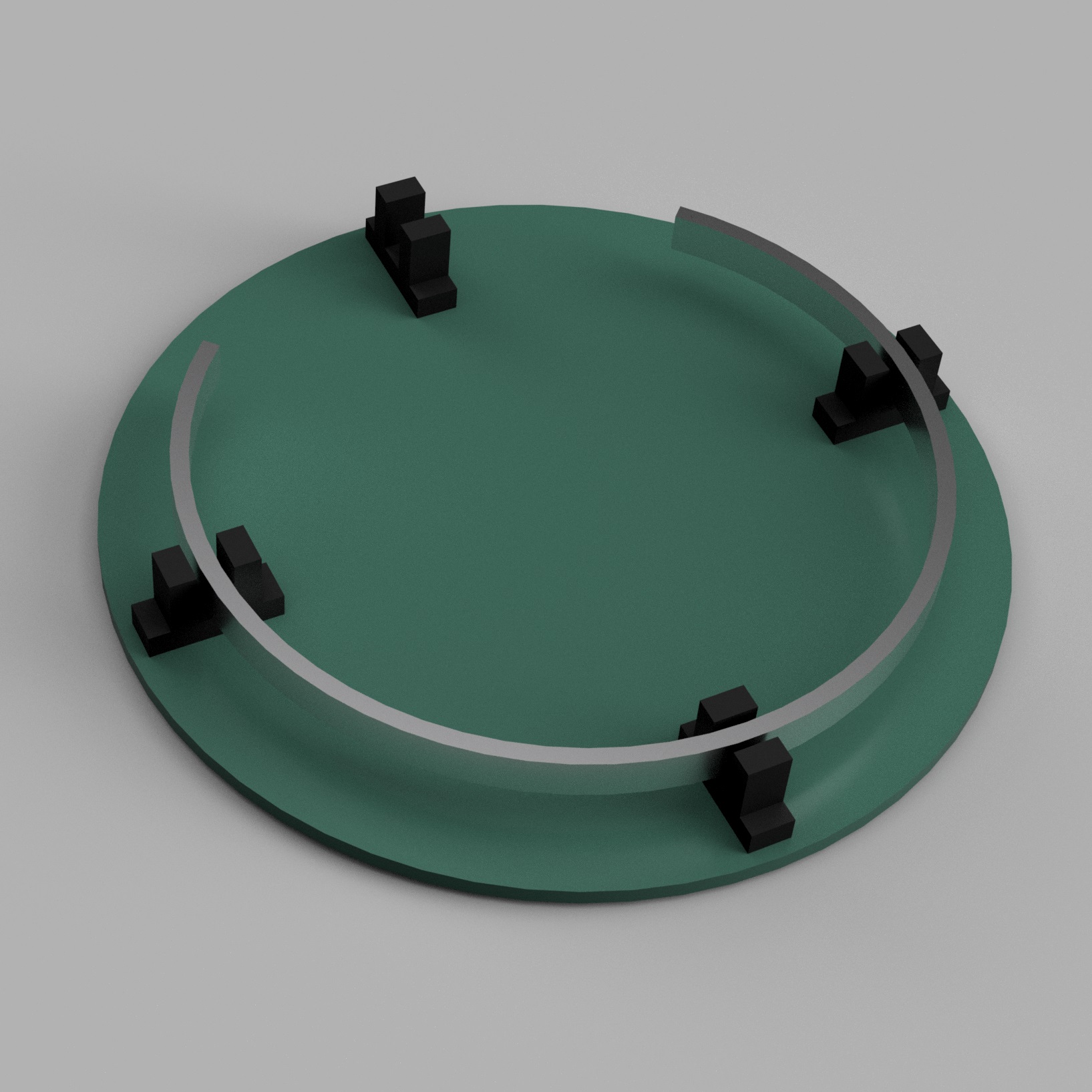

Hi I’m trying to get the tool turret of an Emco PC Turn 120 working using the carousel component the PC Turn 120 uses from I can tell a fairly unique "encoder" to measure the turret position it uses a ring with a 90 degree cut out that rotates through 4 optical limit switches measure the position of the turret I've attach a picture to help visualize it. I set up a carousel instance to read the encoder as a binary encoder and then use the remap to convert the called pocket to the binary value for the encoder to have carousel rotate to. The problem I'm running into is to lock the turret it needs to rotate slightly past when the encoder reads its in the correct position and then rotate back to engage the ratchet type locking mechanism. I’m currently looking for a way to get carousel to do that. I'd appreciate any insights into the problem and help with fixing it thanks.

Trying to change the debounce time, I got an error saying the parameter was not editable. After that, I looked at the .comp file and realized adding a new forward pulse pin and having it trigger before the reverse pulse was achievable so I recompiled the .so file with a forward pulse and now it works.
