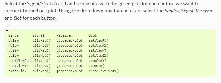

The problem with the preview/backplot window is the limited customization options which makes it quite useless in more complex setups. Would be nice to have the possibility to rotate and mirror through external commands.
I think that's what I stumbled across yesterday - external control of the backplot view.
I looked in the QtPyVCP tutorial and found the backplot setup page.  The tutorial describes creating buttons and linking them to the backplot view orientation and zoom controls.
I'm speculating that if we can do something with on-screen buttons, maybe we can do the same thing with external controls (i.e. an M-code or hal pin or similar).
And the LCNC user manual page for QtVCP has similar description of setting the view for the backplot widget used in QtVCP GUI's.

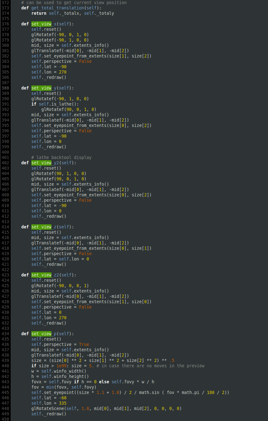

31 Aug 2023 14:50 - 31 Aug 2023 18:17 #279482 by Aciera
Replied by Aciera on topic Axis/joint naming (lathe subspindle)
Actually I think I may have found it in '/lib/python/glnav.py'
[Edit]
I have managed to modify 'axis.py' so I can use a motion.analog-out-NN pin to choose the preview orientation. So far only the predefined views from the gui buttons can be selected.

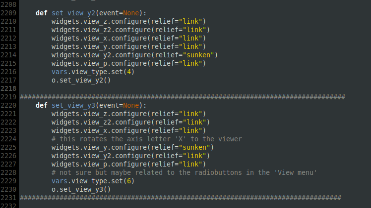

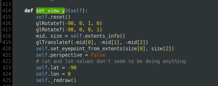

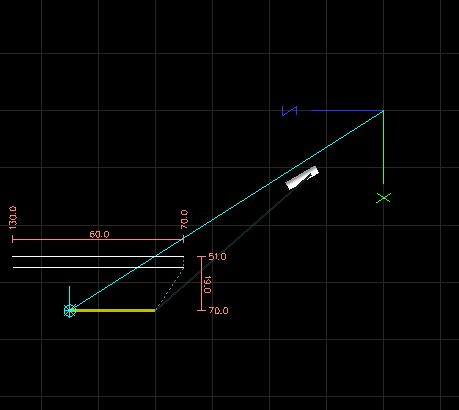

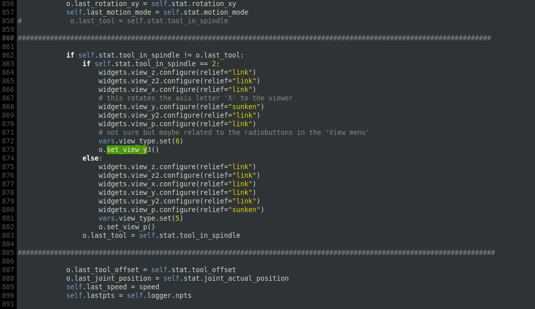

01 Sep 2023 07:05 - 01 Sep 2023 12:21 #279547 by Aciera
The end result for now is:
- custom views can be added to 'glnav.py' like this
- then use this modification of 'axis.py' to activate the above 'y3' view when 'tool_in_spindle' number is 2 and perspective view for all other tools:
The example 'Y3' view looks like this:
Last edit: 01 Sep 2023 12:21 by Aciera.

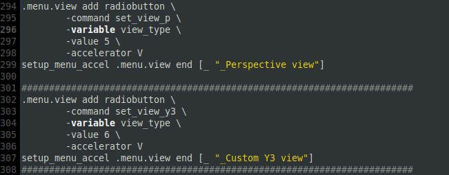

01 Sep 2023 07:24 - 01 Sep 2023 18:40 #279550 by Aciera
Optionally the above custom 'y3' view can easily be added to the 'View' menu by modifying 'axis.tcl':
and adding the y3 custom view to the TclCommand class in axis.py:
Last edit: 01 Sep 2023 18:40 by Aciera.

05 Feb 2024 03:56 - 05 Feb 2024 03:57 #292482 by spumco
Replied by spumco on topic Axis/joint naming (lathe subspindle)
Resurrecting this one as I'm at the point of fiddling with the GUI.
I've edited axis.py, glnav.py, and axis.tcl as indicated.  However, the additional view is not showing up in axis menu or view buttons.
Tried changing INI to [DISPLAY] LATHE=0, and [DISPLAY] GEOMETRY=XYZCV but still no joy.  Wonder if the preview takes the data from [TRAJ] and not [DISPLAY].
I suspect I'll have to sort this out for the particular GUI once I decide on one.
Last edit: 05 Feb 2024 03:57 by spumco. Reason: I can spells good
05 Feb 2024 05:52 - 07 Feb 2024 00:29 #292485 by phillc54
Replied by phillc54 on topic Axis/joint naming (lathe subspindle)
I have managed to get this working as a  USER_COMMAND_FILE .
Last edit: 07 Feb 2024 00:29 by phillc54.
